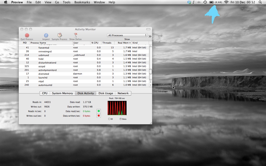

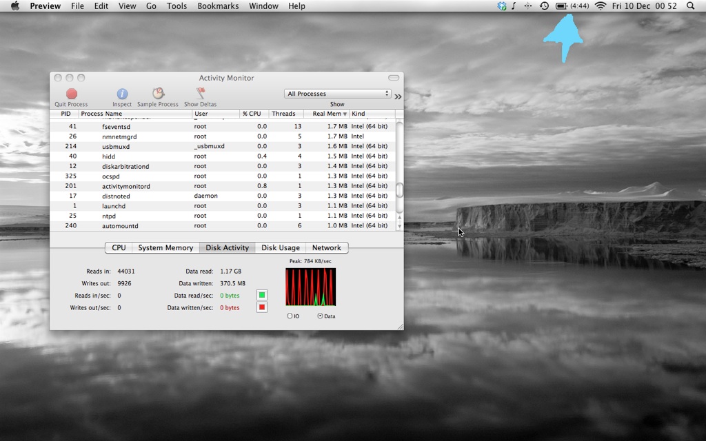

Okay, first impressions on the SD24 firmware update;
Drive doesn't spin down (instead bursts of speed every so often!)
Constantly reading(/writing)
Substantial hit on battery life
I've included a pic below to give a rough idea (ymmv but for reference I've a 2010 13" MBP, 118 cycles and recently calibrated battery health of 95%), 10mins after fresh boot, full screen brightness and no running applications. Very subjective and taken minutes off the mains, and as I write its between 4:30 and 5:30 but would expect roughly 7:30+ from SD23.
/battery, &c.
As for boot time, loading &c. at least as good as before and accessing information seems perkier, but it be warned it may be best not to be a guinea pig if being away from the mains is a problem.

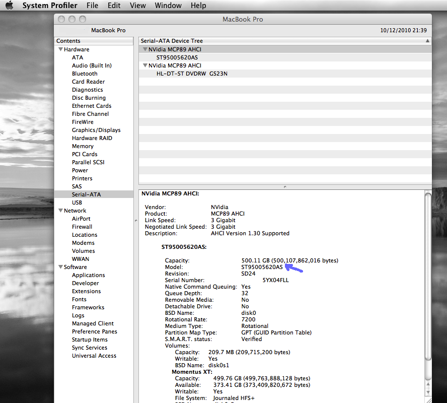

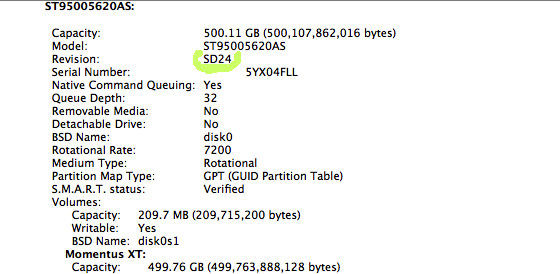

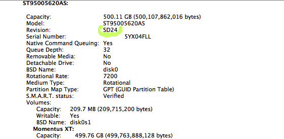

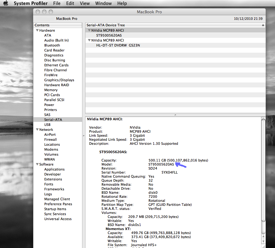

apple menu/about this mac/more info/serial-ATA to check

Heya, very happy to meet a pioneer! First thing I did was to check in the "About this Mac" to see that that model number matched those on Seagate's website (you've been there, but the links for general reference) http://seagate.custkb.com/seagate/crm/selfservice/search.jsp?DocId=215451&NewLang=en&Hilite=. (Model no. indicated in pic below)
The disk image was from this link to the non-pc intel section "For non-Windows systems with Intel compatible processors we also offer a bootable CD ISO image http://www.seagate.com/staticfiles/support/downloads/firmware/MomentusXT-ALL-SD24.iso which will create a bootable CD."
After burning the disk image to CD via Disk Utility I booted with "c" held down from power up, and from there it was DOS and just a matter of selecting the (clear) option- and after 2ish minutes it was done.
I'm very happy to describe what I did, but this was my first time updating firmware this way and everything went smoothly. I guess what I'm trying to say is that I'll be around this evening if you want to compare notes &c.- but I wouldn't be particularly helpful if anything didn't go to plan. /disclaimer.
Then again, if you've just got the drive today, chances are there's no harm in losing data, so... why not😀 btw what was your method- probably my understanding amiss but what was your process? Cheers!
