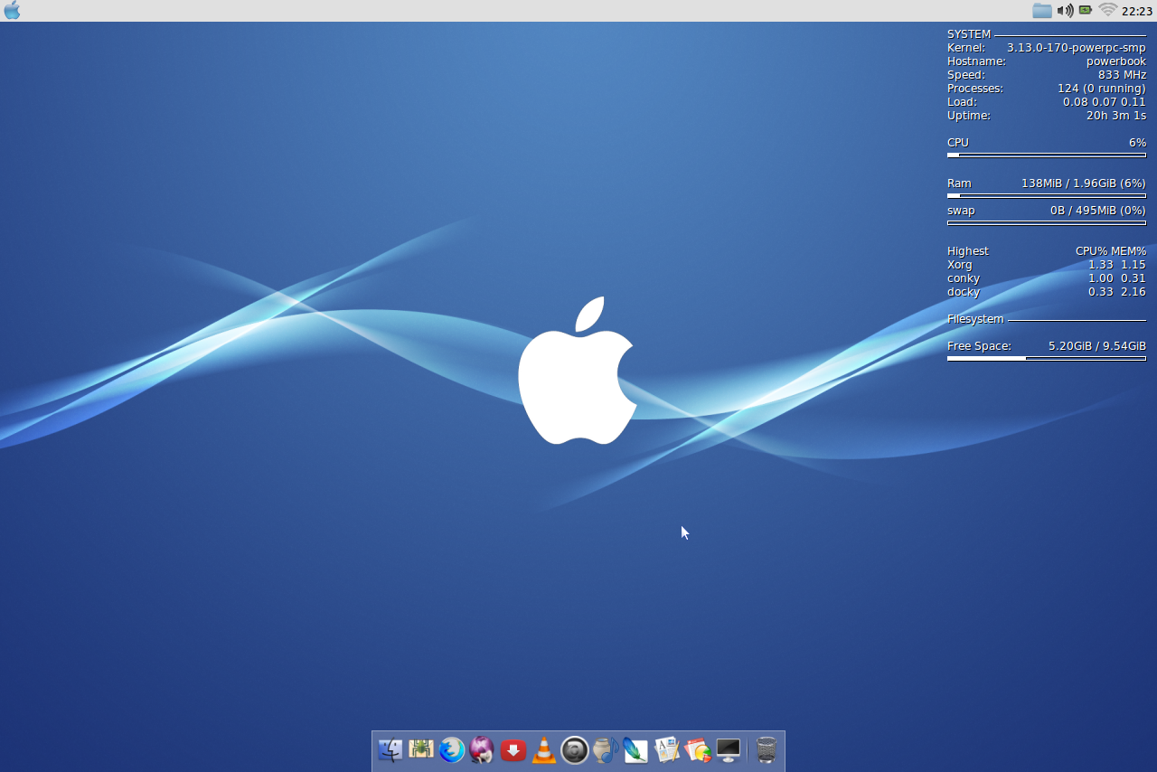

Possible default look for next 12 remix release. I like the idea of Macbuntu. Thoughts?
That looks great.
I would say go ahead. Worst case, just bundle in a bare LXDE as an optional desktop environment at LightDM. Maybe bundle a version of the background lacking the Apple logo?
These remixes are really great work, wick, The stuff you're pumping out is really doing the platform, and perhaps adoption as a whole, a serious favor.
Thank you for your continued dedication to PowerPC! :)
I'd say have it has the default environment at the login menu but keep the others and a vanilla option there.
Doesn't everyone customise anyway? I quickly moved the panel to the top, changed the wallpaper and altered and moved conky?
Reactions: wicknix
Macbuntu remix is ready. Right now it's really no different than 12 remix-v4 other than the default desktop look & feel.
I will probably continue the updates/upgrades on macbuntu remix going forward and kill off 12 remix so i don't have 2 almost identical releases to update. One can simply install the full LXDE (or any other DE/WM) if they want that instead of the default mac-ish desktop. As i mentioned i'm taking a little break from compiling new stuff, so no new features for a little while. Anyway, first post updated with screenshot and download link. Enjoy. ;-)
