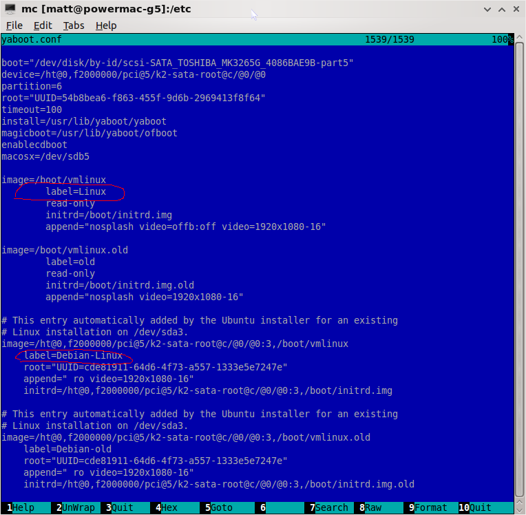

Yeah, an uphill battle. You should be able to see the drives partitions / paths via gparted. The issue is that in order to update yaboot (which also resides on its own partiton) you must run sudo ybin -v to update yaboot on said separate partition. The yaboot.conf you're editing is the one that gets copied to the boot partition when you run ybin -v. The firewire connection is more than likely "in the way" of it doing just that. So you may actually have the correct paths edited in, but they aren't being copied over to the right place. It's a lot of work, but you "could" boot the live disk again, then chroot in to the installed system. Make edits from within the chroot and run ybin -v from within the chroot. That's about the only way i can think of to that might work.
The installed system should have 3 or 4 partitons. Here's an example from my mini.
/dev/sda1 unknown (a few kb)
/dev/sda2 hfs bootstrap (houses yaboot and its config to boot)
/dev/sda3 ext4 / (root filesystem with the OS on it / also houses yaboot and config, but not used to boot)
/dev/sda4 linux-swap
So in /etc/yaboot.conf knowing these, you can get rid of the OF style drive ID's and use /dev instead
boot="/dev/sda2"
partition=3
root="/dev/sda3"

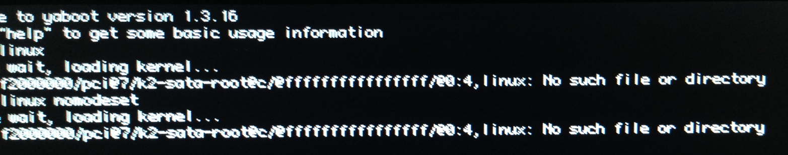

You can do that 2 ways. First when it boots where it says boot: type: Linux nomodeset
Second, to make it permanent: edit /etc/yaboot.conf and add nomodeset to the "append" line (which will probably have other parameters listed also), save, then open a terminal and type: sudo ybin -v to update yaboot.
More info here: https://wiki.ubuntu.com/PowerPCFAQ#Configure_graphics
Cheers
i get this when i type: Linux nomodeset

@TzunamiOSX: you need to use a capitol L. Linux nomodeset

@TzunamiOSX : To boot manually (not letting it boot by itself) you need to use a capitol L in the word linux. Your picture shows lowercase linux. You want to type Linux. Example boot prompt:
Code:
boot: Linux nomodeset
Or do you have more than 1 linux install on the machine? It's possible the name changed. For instance on my dual boot install Ubuntu12 is labeled "Linux", while Debian is labeled "Debian-Linux". Check /etc/yaboot.conf and see what label= says.

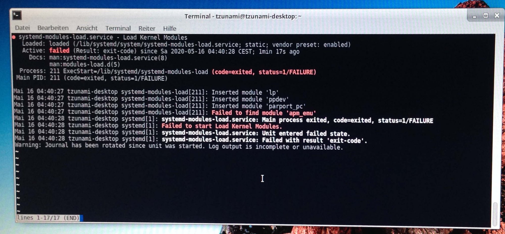

@TzunamiOSX : Yes. Harmless text. Another init script loads them further in to the boot process.
