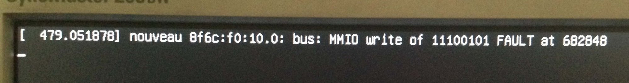

My iMac G4 with FX5200 is working well under Ubuntu Mate 16.04 but with my G5 i have Problems. Look like this is a known bug and you must add the boot option nomodeset to fix it, but i don't know where to add this
You can do that 2 ways. First when it boots where it says boot: type: Linux nomodeset
Second, to make it permanent: edit /etc/yaboot.conf and add nomodeset to the "append" line (which will probably have other parameters listed also), save, then open a terminal and type: sudo ybin -v to update yaboot.
More info here: https://wiki.ubuntu.com/PowerPCFAQ#Configure_graphics
