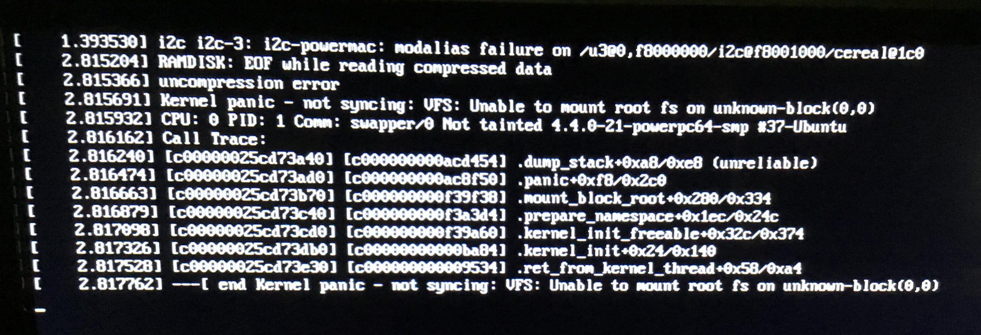

Hi, the Ubuntu 16.04 Remix live image works fine on my G5, installing is also possible with no problems, but the first boot ends up with an Kernel Panic:
"Kernel Panic - Not Syncing: VFS: Unable to Mount Root FS on Unknown-Block(0,0)"
I think the intiramfs file was not found, but I have no idea how to fix it..
thanks!

I have 2 suggestions that may or may not work. First, make sure your linux hard drive is in the upper bay of your G5. It wont boot from the lower bay (even though it'll install fine). Second, stay offline during the install. Run the updates after the system is installed.
I'm afraid not, the same error :-(

Bummer. There was this glitch on the official 16.04 desktop iso that affected a few select machines. Since i based remix off of that it inherited that bug. You can always try the 12 remix, which doesn't have this quirk. I've mildly updated it with some newer software, and it runs faster than 16.04. Otherwise give mintppc, adelie or void-ppc a spin.
