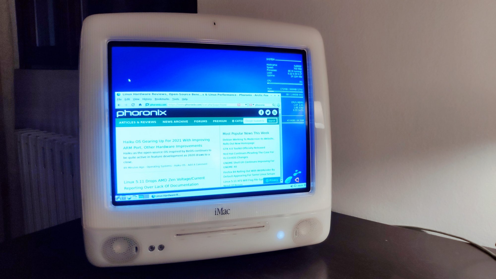

Yesterday after many trials I have managed to make the iMac G3 works with its specific r128 driver with following xorg.conf settings:
Code:
#Add/change this in MODULE section
    Disable    "dri"
    Disable    "dri2"
    Load    "glx"
#Add/change this in DEVICE section
    Driver    "r128"
    Option    "UseFBDev"    "false"
    Option    "NoInt10"    "true"
    Option    "ForcePCIMode"    "true"
#Add/change this in SCREEN section
#Change DefaultDepth to 16 in case you have an ATI128 with 8MB VRAM
    DefaultDepth    24
    SubSection "Display"
        Depth    16
        Modes    "1024x768"    "800x600"
    EndSubSection
        Depth    24
    EndSubSection
Now all the glithes are gone, UI looks also more responsive.
Next step will be to enable hardware acceleration and DRI (glxGears runs @25fps due to software rendering).
Enabling it will require additional time since r128 acceleration is not compatible with MESA 8, so probably I will need to downgrade packages plus run further configuration of X.
Let's see where we will end up with this nice distro 🙂
Cheers/Francesco

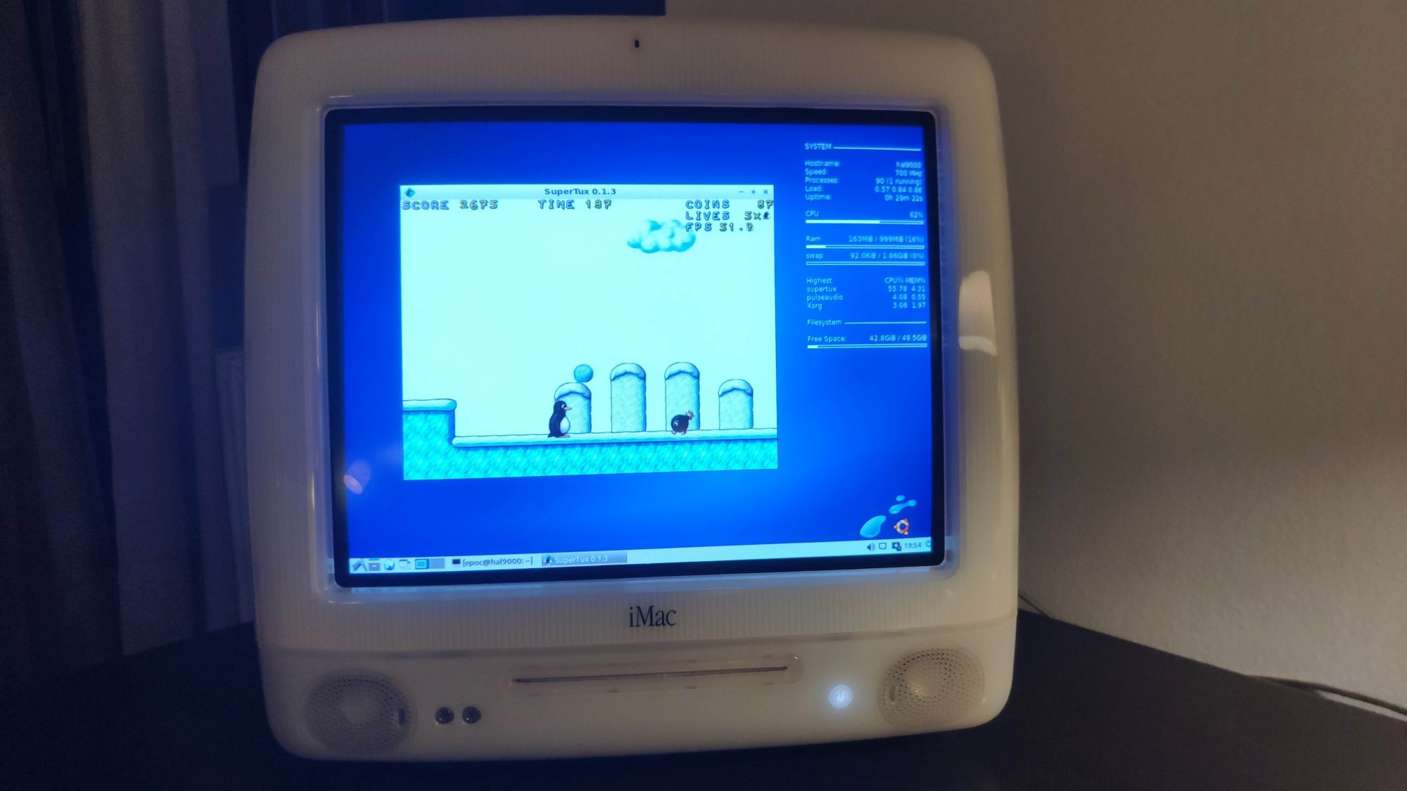

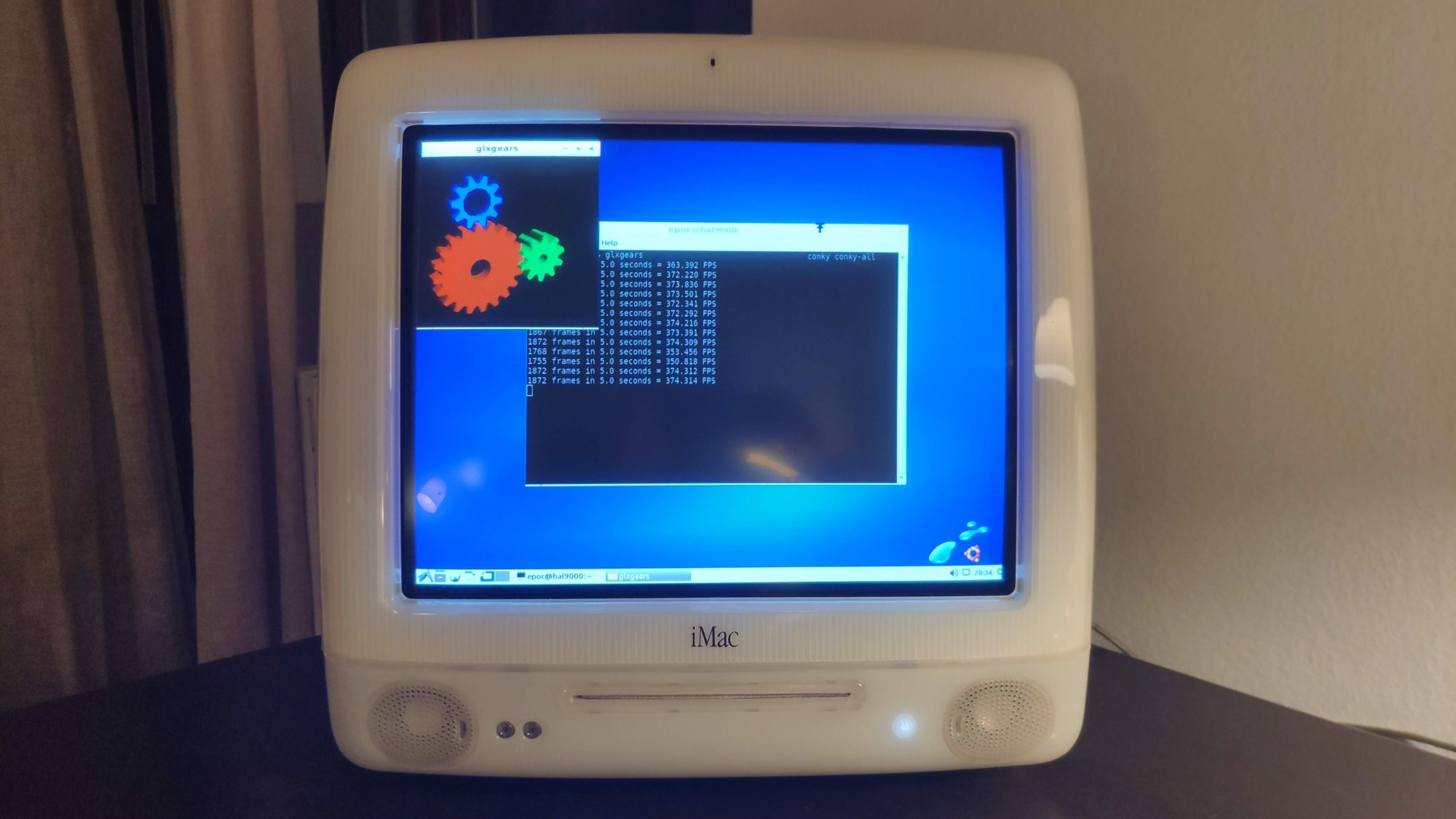

And with additional multiple steps we have a 20 years old iMac G3 with ATI Rage 128 (16M) with HW acceleration enabled!!
I did also several testing to optimize its poor performances passing from 260fps to 370fps in glxGears.
Also some games with openGL <= 1.2 work smoothly:
Happy with the progresses so far.
Next step will be to move away from XAA and to enable "modern" EXA acceleration on the r128. However to do that I need newer drivers requiring tons of newer libraries, so I think I will be forced to test more recent OSes like the 16.04. Let's see..
Have a nice Xmas.
Francesco

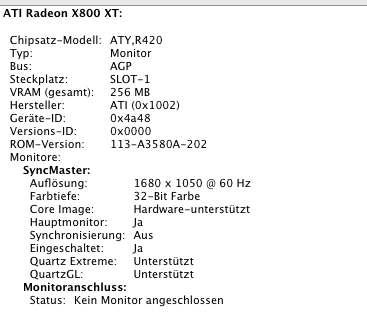

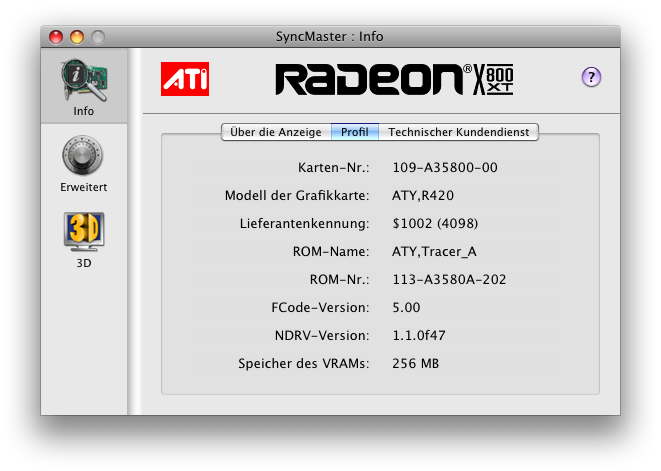

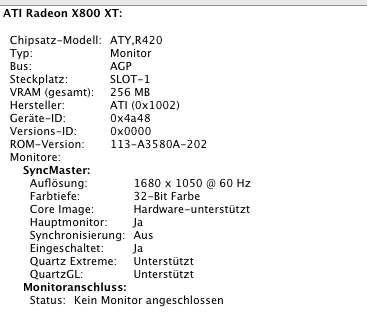

Problem after GPU change. Is there a solution without reinstall Linux?
I have changed the GPU of my G5 AGP from a 7800GS to a original X800XT Mac Edition. Now i got this when i start the Linux GUI:
Is there a solution to start with a terminal and change the driver installation or is a complete reinstall necessary?
Once it's booted you could try ctrl+alt+F1 and see if you get a readable console. If you do you can update your boot parameters or xorg.conf to reflect the new card.
Cheers

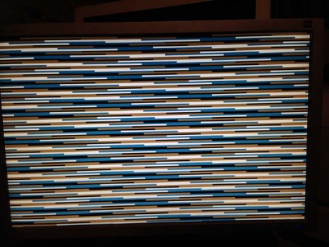

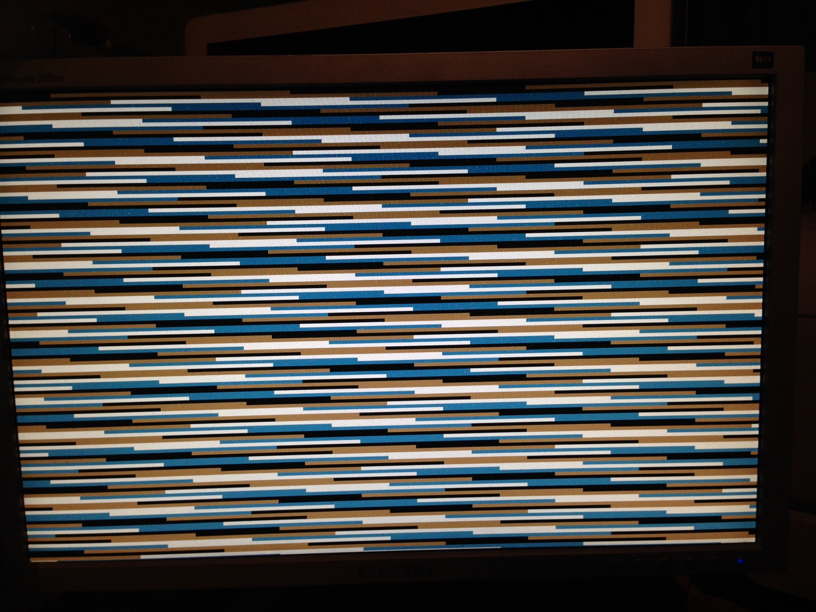

looks like it has something to do with the yaboot parameters
I have the same problem with the live DVD
i have tested
'live radeon.agpmode=-1 radeon.modeset=1 video=offb😱ff nosplash'
'live radeon.agpmode=-1'
without luck
any ideas?
i have tested
without luck
any ideas?
Have you tested the card with Tiger or Leopard?
yes all working well and looks normal under leopard and also morphOS live CD
View attachment 1703381View attachment 1703382
Digging around, it seems like this may just be a general issue with the card.
This does sound a lot like your issues. The Radeon 9000 in my G4 MDD locks up under 16.04, and there's no solution to that, either. It seems like there are just some old ATI cards that simply do not have working drivers under Linux, and I wish I had a better answer for you.
i found this here:
looks like this is a problem with the framebuffer, but i dont know what to do
No clue. From a bit of duckduckgo-ing i did it seems that card isn't supported on ppc linux at all. I'd just stick your old gfx card back in there and call it a day.
Cheers
I dont know the exact reason why
but sadly R4xx based ATI cards (X800 XT X850 XT FireGL X3 etc) just dont work in PPC Linux
Id love to know exactly why the driver falls over itself so badly, but I dont know sadly
but if you look at the console/logs it spits out, it crashes pretty hard before the whole machine just locks up solid
Cheers
The problem was, that the 7800GS also has problems with linux (sometimes freezes on shut down).
Conclusion: The fastest cards for for PPC AGP Macs doen't work correctly on linux. Looks like a total fail.

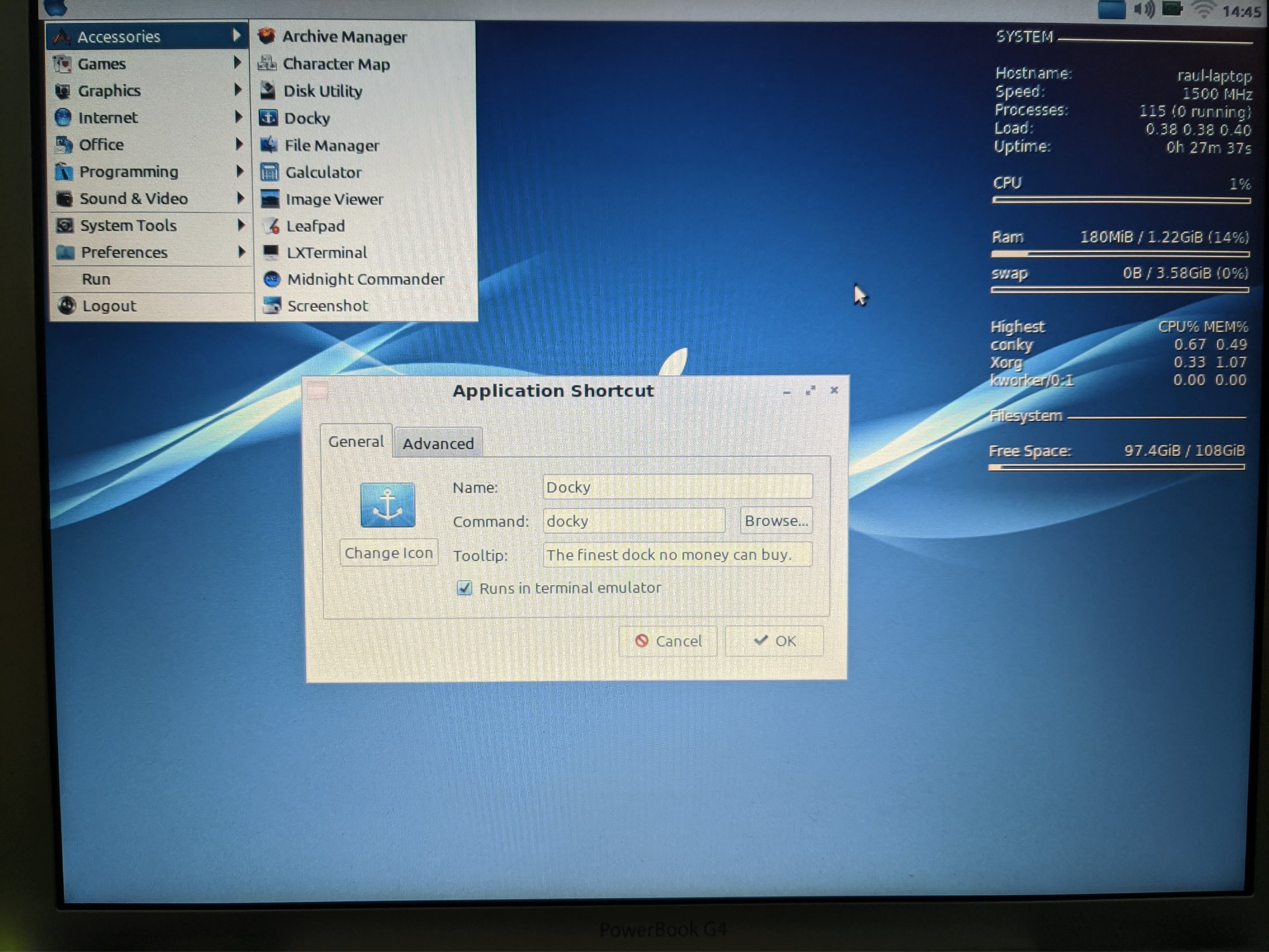

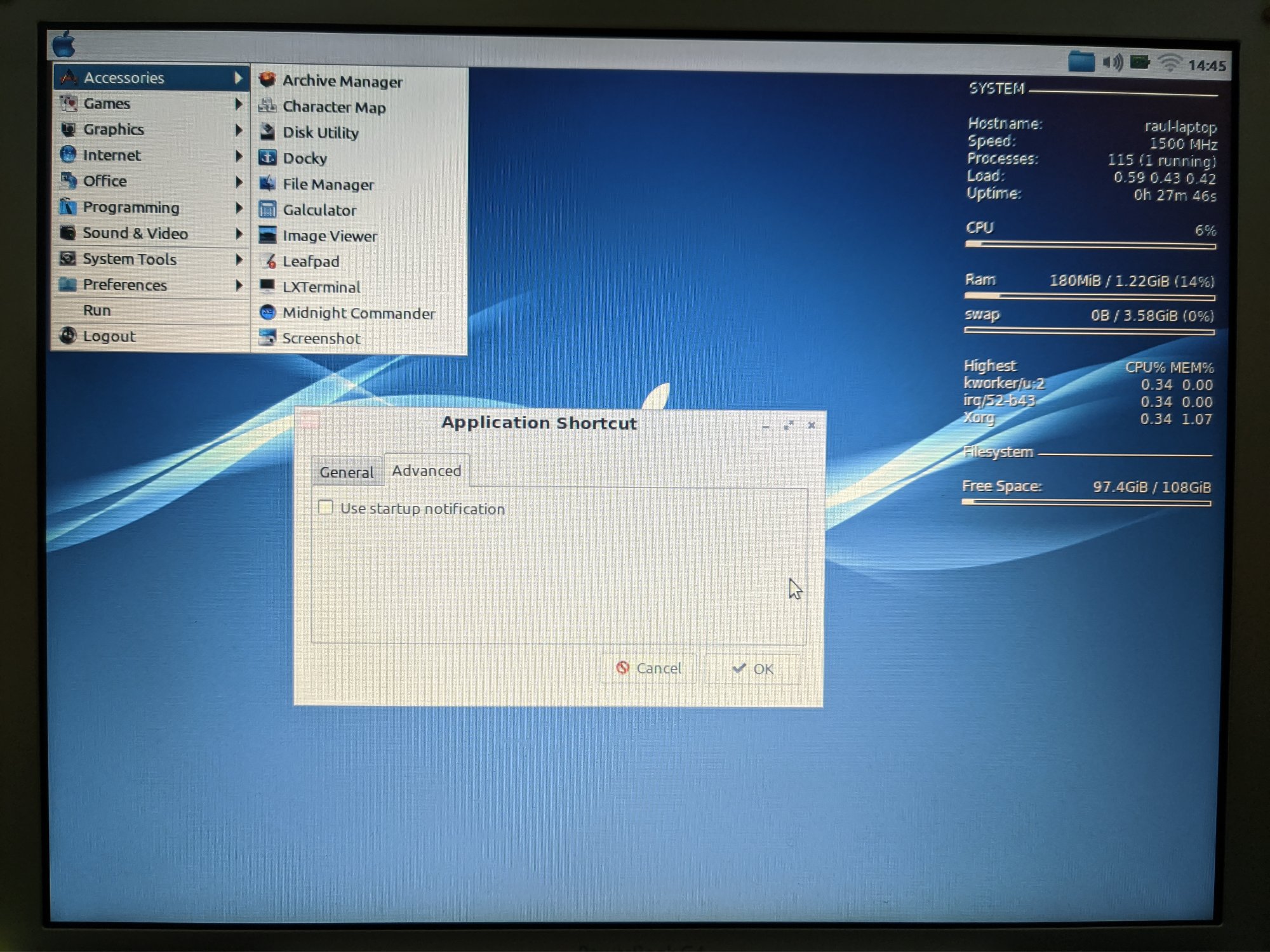

I managed to install MacBuntu on my PowerBook G4 12" 1.5, and I can't manage to have Dock open, I click on Docky and nothing happens, how can I fix it?
I manage to install ViewTube and ViewTube++, now how I enable only mozplugger and vlc plugins in the browser?
Brightness not working via keys, how I fix it?
In your browser, like arctic fox, from the menu bar, choose tools -> addons -> plugins
Sometimes you need to use the FN key to activate the media/brightness keys.
If i remember right, you need to right click on docky to open the preferences, pin apps, etc.
Cheers
Reactions: ExclusiveMac
Cheers
Thank you, I will try.
Where exactly are the pins options, as you can see from picture there is no option to change it.
