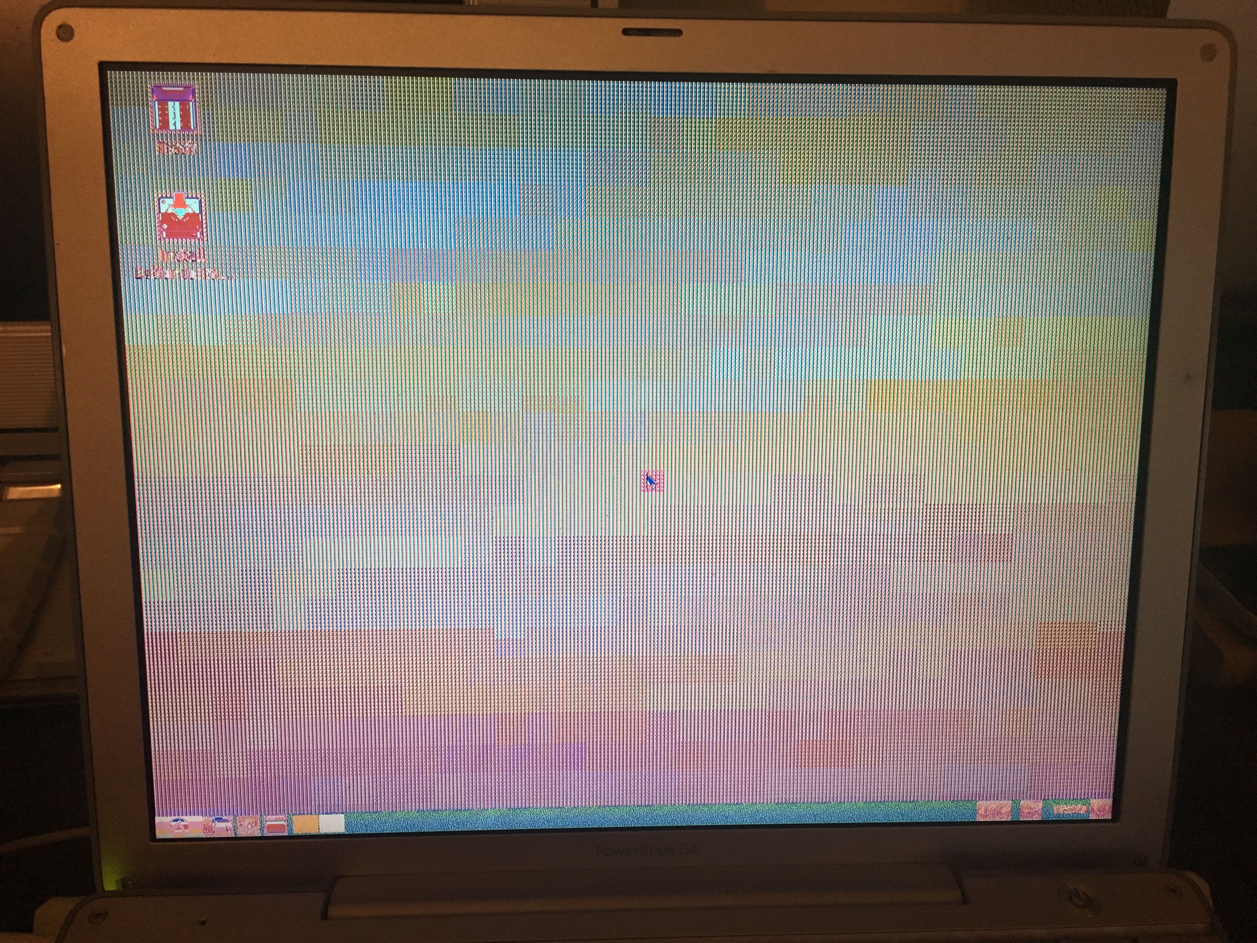

Ahh, so close yet so far 🙂
Neauveau.modeset=0 yields this result.
I’ll keep plugging away.
yeah drag, Nouveau.modeset, =0, =1 etc. nor anything else resolved the screen. Something to work on another day I suppose. Maybe I'll play around with this on my PMG5 in the garage tomorrow.

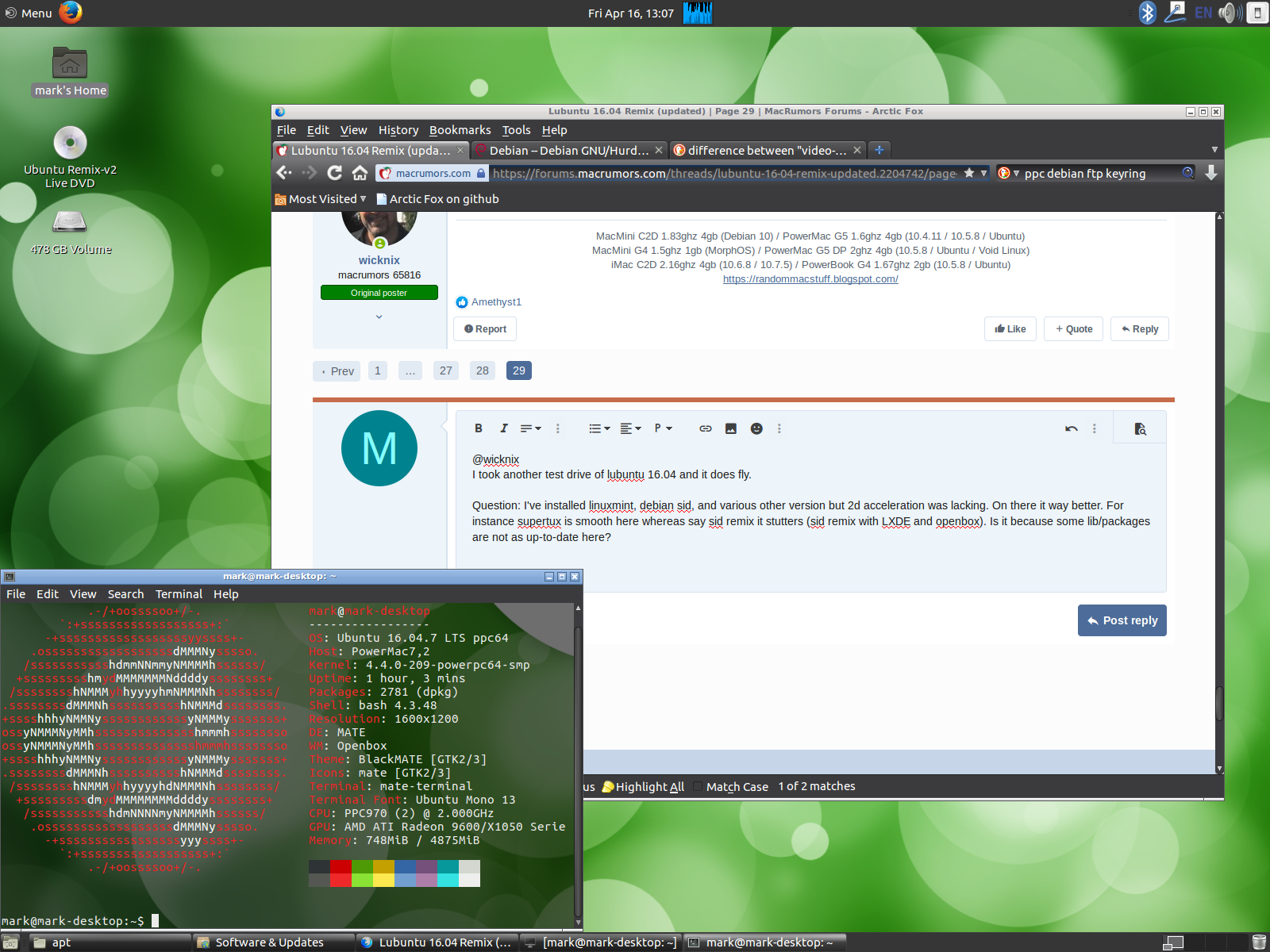

@wicknix
I took another test drive of lubuntu 16.04 and it does fly.
Question: I've installed linuxmint, debian sid, and various other versions, but 2d acceleration was lacking. On here it is way better. For instance supertux is smooth here whereas say sid remix it stutters (sid remix with LXDE and openbox). Is it because some lib/packages are not as up-to-date on 16.04?
Good question, but I'm sure that has something to do with it. Anything bleeding edge is more bloated and heavier than older more "period correct" releases. It could also be kernel 5.x causing issues. My g5's run best with the 4.x kernels. But yeah, 12.04 and 16.04 are noticeably faster than any current distros in my testing.
Cheers
I think of it like this. Bleeding edge Linux on powerpc is like imagining if it was possible to run big sur on powerpc. It's the same concept. Newer OS = bigger, heavier, more demanding.
Reactions: galgot
Debian 11 actually runs pretty decently and fast. It's just some 2D rendering is slow and most obvious when trying to play games. Lubuntu 16.04, more specifically your remix, even updated afterwards runs all the games fantastically. A example is I was running quake three earlier today and other than some limitations on the graphics card the game ran smoothly.
