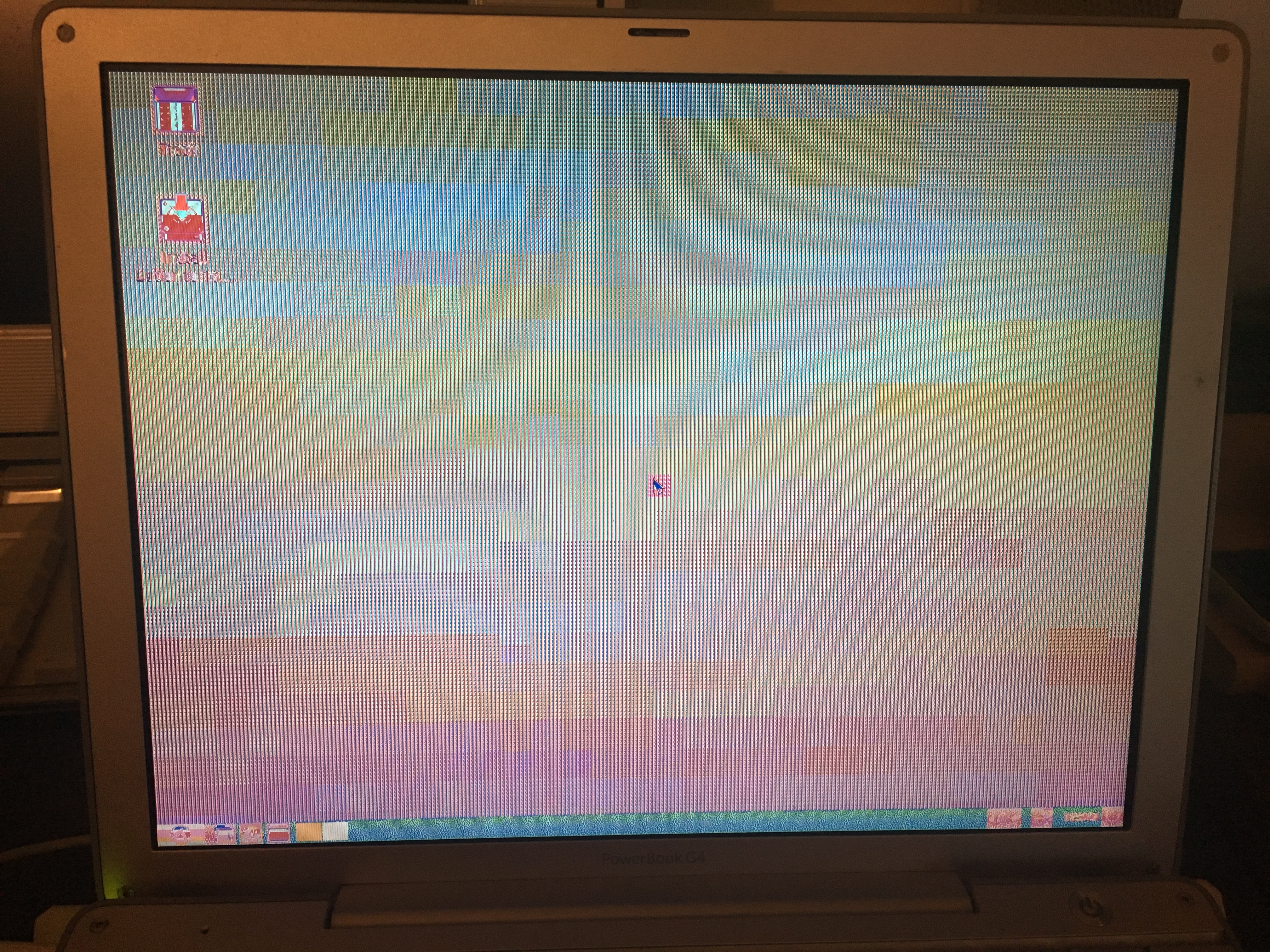

Gave it a shot on my 12” pb & it hangs on a backlit black screen (where I think others have experienced a blue screen). The process follows this video almost identically just past modealias failure and then just stays there. I hear the cd spinning and then finish up - my assumption is that the livecd finishes booting up but there is some issue with the geforce4mx driver so no visible gui. Any thoughts on how to get into the live cd environment?

@RhianB Could you try booting with "live nouveau.noaccel=1" or "live nouveau.modeset=0"? That's about all i found for nvidia cards in a quick search.
Edit: On a side note, try using the keyboard hotkeys to turn up the backlight. Sometimes my 15" PB boots fine, but backlight is off.

Neauveau.modeset=0 yields this result.
I’ll keep plugging away.
yeah drag, Nouveau.modeset, =0, =1 etc. nor anything else resolved the screen. Something to work on another day I suppose. Maybe I'll play around with this on my PMG5 in the garage tomorrow.
Closer. 🙂 What about "live nouveau.modeset=0 video=offb😱ff video=1280x854-16" (whatever your max resolution is -16 = 16-bit color)

Unfortunately that did not work. It would hang on the white boot screen. Omitting just
Code:
video=offb:off
specifically would allow the installer to move forward to the liveCD gui environment but still with the previously distorted coloration. Anyhoo, it is late. I'll return to this at another time.

How about:
Code:
live nouveau.modeset=0 video=nouveaufb:1024x768-16
or
Code:
live nouveau.modeset=0 video=nvidiafb:1024x768-16
No dice. while they are producing a live cd environment, the same garbled pixelated gui remains. I'll mess more with this later today. Thanks for the suggestions. Subsequently, when installing void, I get the same result on this machine. Something to do with the geforce420 go driver I guess.

Hey @RhianB, here’s another one to throw in the mix;
Code:
nouveau.config=NvMSI=0
This helped my Geforce 6800 GT in addition to the earlier kernel parameters.

I was a little surprised that the FX5200 didnt work with the g4 geforce4 go family gpus. I didnt get around to trying it on my garage PMG5 but think it should work out of the box there.
Looks like this isn't going to work either. Getting the same black screen result as the FX5200 driver. Thanks for the ideas 🙂
