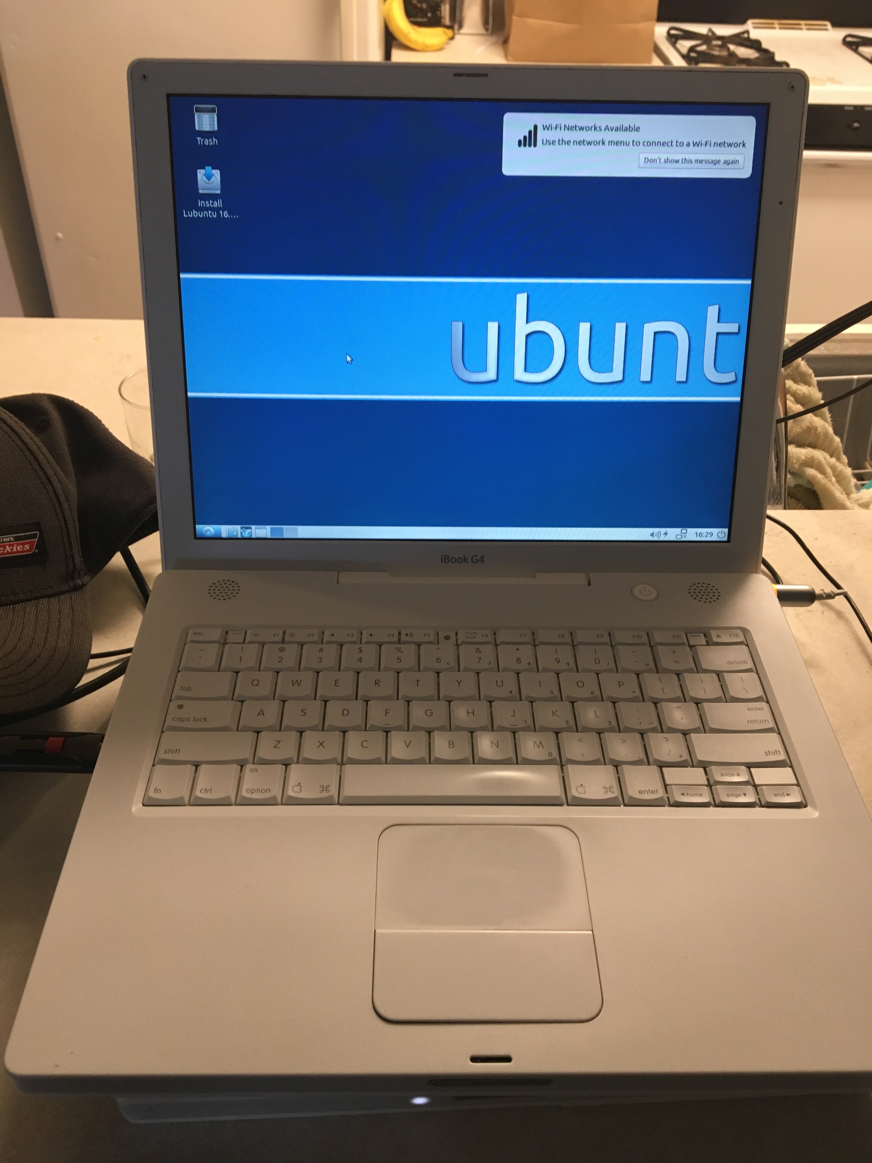

Werks on my machine
Not sure what syntax you guys are using, but
Code:
sudo dd bs=4M if=/path/to/your/image of=/dev/sdx
did it for me. "sdx" being the name of the disk you're dd'ing the image to. It isn't necessary to specify a partition number when doing this. I just formatted the disk with Gnome disk utility, and created a FAT partition, then dd'd the image to the flash drive. I'd like to add,
Code:
bs=4M
wrote the image at 12.2 MB/s as opposed to the paltry 3.2 MB/s I typically get without specifying that command. Just an observation of mine.

@sparty411 that doesn't resemble the usb.img. Looks like the live DVD. The usb .img has resized wallpaper to display the full image, an extra drive (persistent storage drive) on the desktop, and AF & SW in the toolbar. 😉
Anyway... I figured it out. My .img was probably bad. I just finished dd-ing it again from a working usb stick to an .img. Then i grabbed a 16gb usb stick laying around, formatted it, dd'd the new .img to that stick (took 20 minutes roughly), tossed it in to the powerbook and... IT WORKS! Boots fine. Slower to boot than a real install, but it's working. My upload speeds suck, says 4 hours left to upload. I'll update the main post and here with a new link when it's finished.
