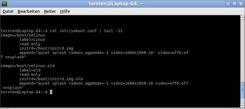

@wicknix I'd need the expert's help again 🙂 I'm trying to install Lubuntu 16.04 on an A1107 PowerBook G4 with an ATI Radeon 9700. The Yaboot parameters do work with the live DVD and I can install it without problems but as soon as the OS is installed on the drive I can't get past a black screen anymore. I pretty much tried every parameter you suggested for ATI 9 series cards but I always end up with a black screen.
For example: "live radeon.agpmode=-1 nosplash" works but "Linux radeon.agpmode=-1 nosplash" doesn't. The screen is black also for the first minute or half with the live DVD but it eventually vanishes and the desktop loads just fine. Not the case with the installed system though. Any ideas? Thanks!
Btw I upgraded the panel in the A1107 (to a higher resolution one – LP171WE2TL02 with 1680x1050) but I don't think that this is related to my issue. Anyways I just wanted to mention it in case the information does matter for maybe another parameter I could try or something else.
Hmm. Does it seem like the backlight is off? Can you take a flashlight and see the desktop if you shine it through the apple logo? If so try FN and brightness keys. If thats not it you can specify resolution in the boot params. Try adding "video=1680x1050-16" and see if that helps. Also try adding "video=offb😱ff". That should let you see the boot messages rather than a black screen while it boots.

Wow! It really worked. The parameter
Code:
Linux radeon.agpmode=-1 nosplash video=1680x1050-16 video=offb:off nosplash
was the solution to my problem. After booting into the OS on the hard drive I could easily modify my yaboot.conf file and bless it with the ybin command. In case anyone is interested (maybe someone with an actual 17" DLSD) this is a screenshot of my yaboot.conf file which allows me to boot into Lubuntu without typing any commands on startup.
Thanks @wicknix for the quick help! 🙂

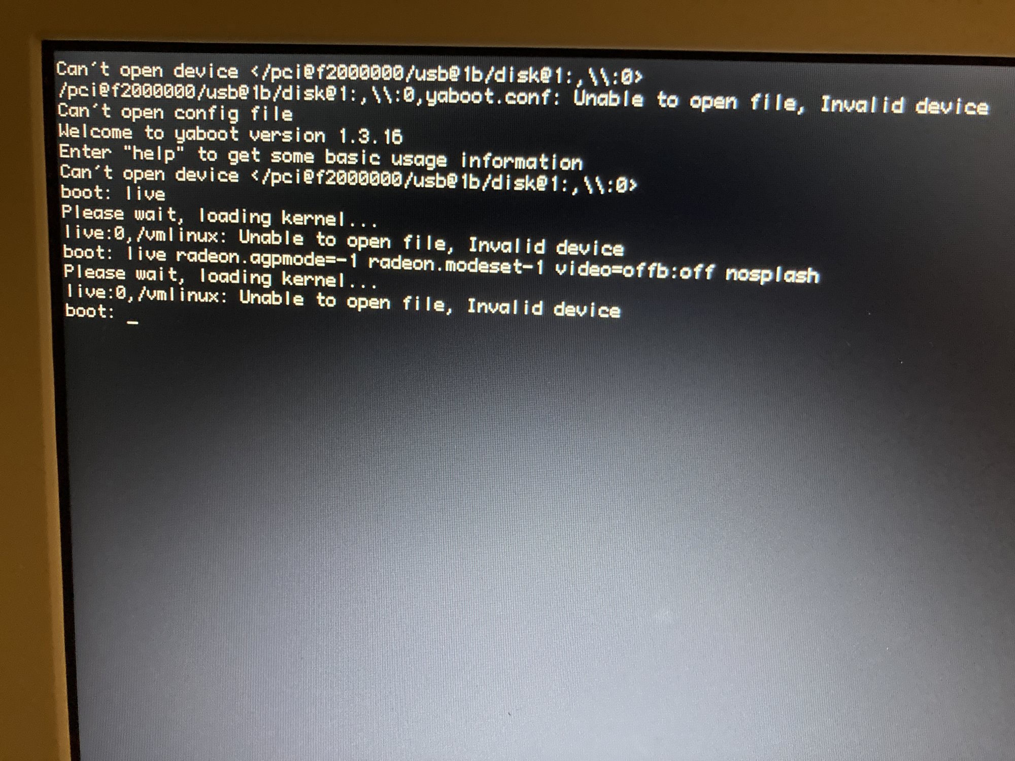

Sorry, I am a complete Power-PC Linux newbie. I was trying to install Macbuntu on my 14" iBook G4. I flashed the ISO on a flash drive using Balena Etcher and tried to boot it using Open firmware and yaboot, but I keep getting an error message. I have tried using the live and the Radeon command posted above, but no success. Would someone please advise me and tell me what I might be doing wrong? Thanks.
I'd try using dd to write the iso to usb instead of etcher. If that doesn't work, try burning the iso to dvd. Optical media works best for this sort of thing on these old machines.
Cheers
Reactions: tensixturtle
@wicknix thank you for the suggestion. I tried with DVD but following further issues I posted a separate thread about it. I'm sure it is something obvious I am completely missing because I have never tried Linux on PowerPC before. Thanks for all the invaluable work you do for the PowerPC and Early Intels, I really appreciate it.

@wicknix sorry to bother you again. I don't know if you happened to see the other thread which I mentioned this in, but I've been having a really hard time trying to make a bootable installer. (other than using the USB stick method with dd which works very well on Macs that seem to work well with open firmware) I can't get it to boot the discs I have burned for Macbuntu and Lubuntu-remix 16.04 v4, only v2 out of the bunch I can get to work. I've also tried using dd to flash it on my FireWire drive with the same result. I select the drive or disc from the boot selection but it will just restart and return to the boot selection. I was curious if this is something you've experienced?
That's really strange. Optical media should always work, although i have noticed these older drives can be VERY picky about brand of cd-r / dvd-r being used. Even some of my early intel machines refuse to read certain brands. I've had good luck with memorex and verbatim. Other brands are hit or miss. This may or may not be the issue, but it's about all i can think of that i've personally run in to.

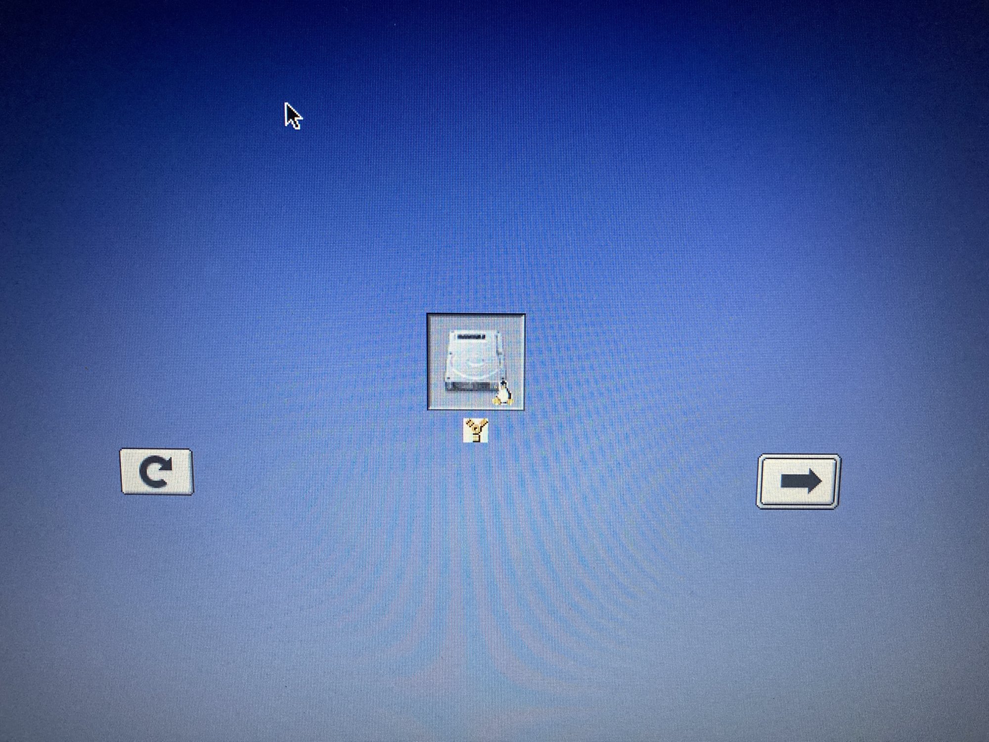

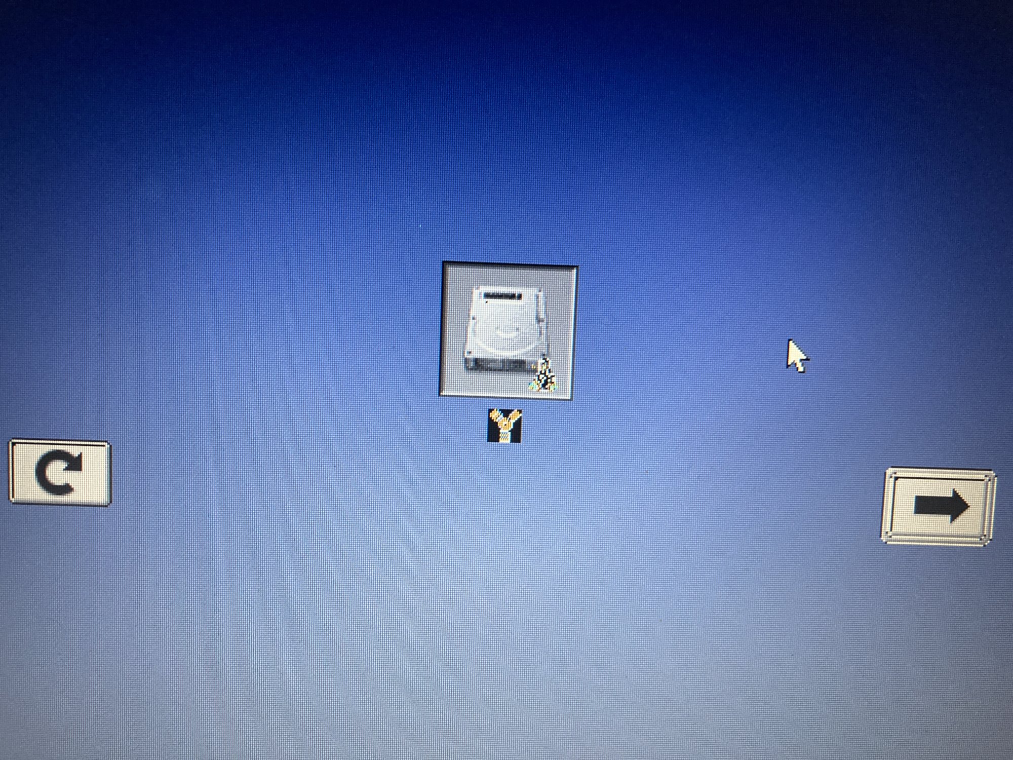

I am using Verbatim DVDs, and the FW drive was also Verbatim (not that that one matters). When the computer reboots back to the boot picker the color of the cursor and some of the icons are inverted; it's really strange and it happens on my friend's Macs as well (they burned their own discs). See below. Thank you for the suggestion.
Before:
After:
I was wondering actually if there might be a way of installing without using the live boot installer by going through a separate OS X partition? I have no idea if this is possible, just curious.
