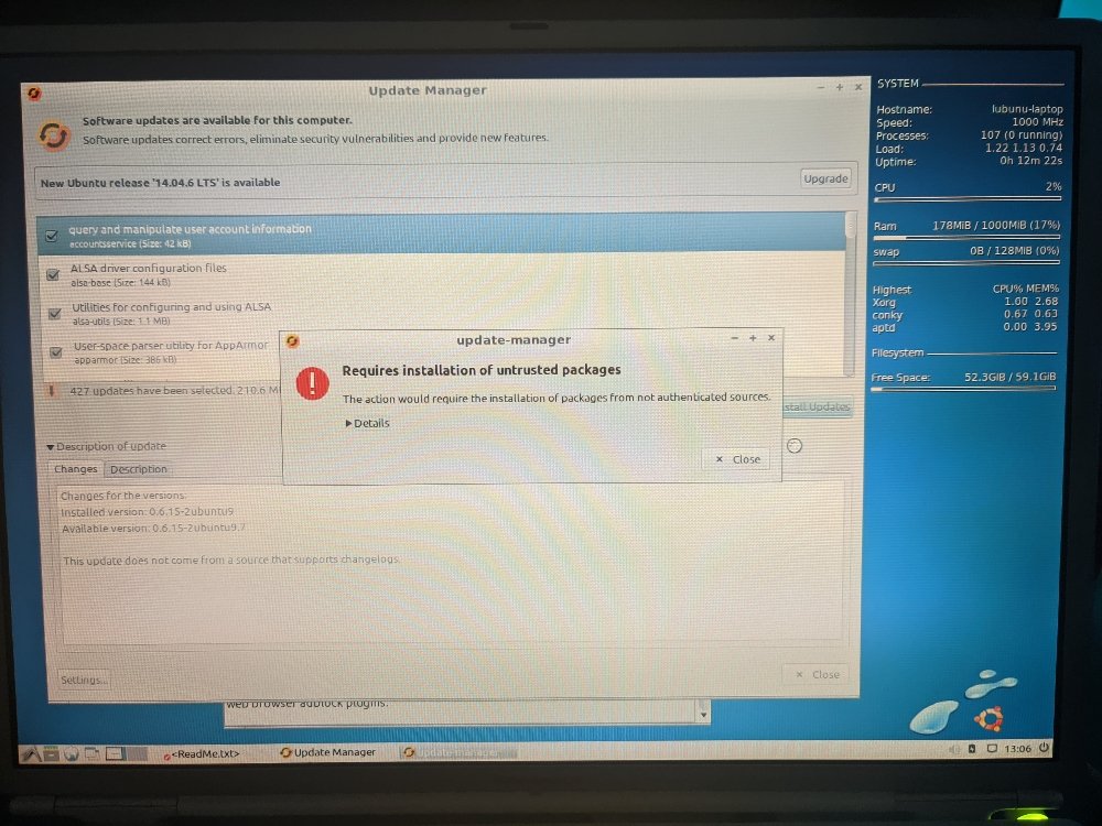

Can you please tell me how i can fix your Lubuntu 12.04 on PowerBook G4 Ti error on update manager?
See this post. You'll need to update your apt sources since they archived 12.04's repo.

Open your favorite editor as root user and change all the entries found in the above post.
Example: sudo leafpad /etc/apt/sources.list
Change the urls with the updated ones and save the file. Then just run: sudo apt-get update
There wont be any more updates to 12.04 by me. It's updated enough to still be more secure than 10.4/10.5. If you want current updated software i'd suggest using the latest debian 11, void linux, adelie, openbsd, etc that still gets updates regularly, or install the development packages and compile new versions of whatever software you want.

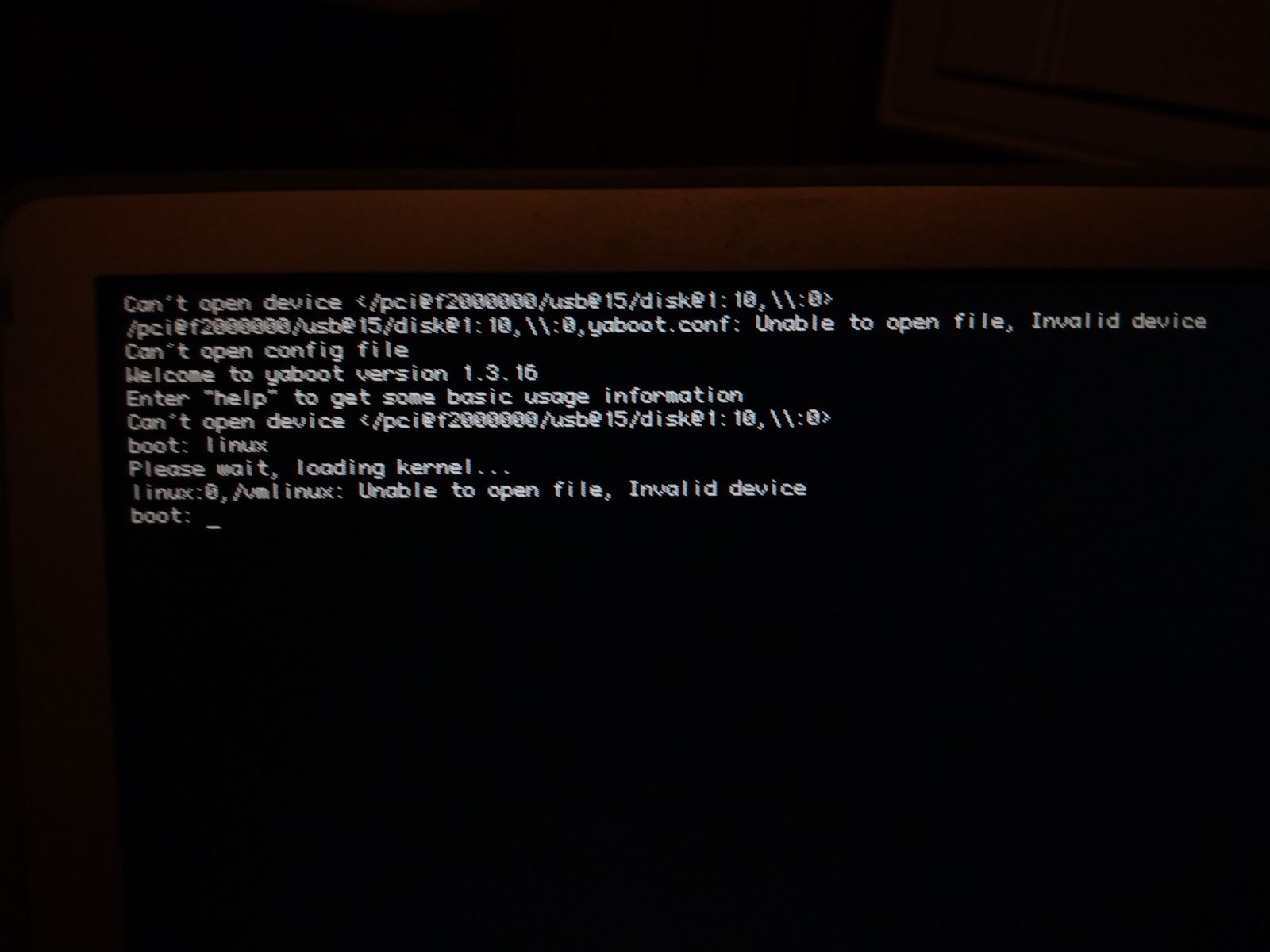

Does 12.04 V4 have to be burned to a DVD? I tried to flash it to my USB drive and it's telling me it can't open the USB device.​

I've never seen the eject cdrom message before, or even found that on the ubuntu powerpc linux wiki in the trouble shooting section. It probably never installed. I don't even know how it even managed to start installing. It physically can't if the cd/dvd is ejected. It needs to copy files from the cd/dvd during install. You have some weirdness going on there that i can't explain.

Possibly. I've never needed to install via usb. The one time i tried a usb install it wound up installing to the usb drive instead of the hard drive. Which might be what happened in your case as well. All my systems have been installed via cd/dvd. Maybe someone who has successfully installed via usb will chime in.

I confirm the speed and fluidity of the lubuntu 12.04 remix operation on ibook g4 (so again thanks to wicknix) but unfortunately it doesn't update me anymore. There are repositories to use. If they exist, can I also use them on debian 7? Thanks to anyone who can give me advice.
@shakary : check out this post. Ubuntu moved the 12.04 repository location. You'll need to update your apt sources.list in order to be able to install extra software. Due note though that the last official updates for 12.04 from ubuntu ended in 2017. In order to get more up to date software you'll have to compile stuff yourself, like i did for some software included in 12.04 remix.
