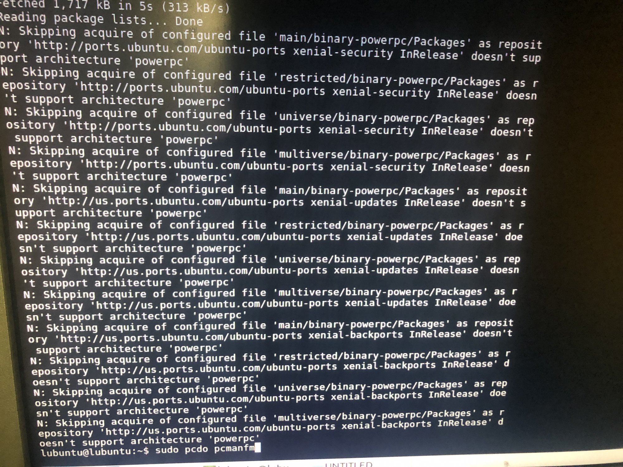

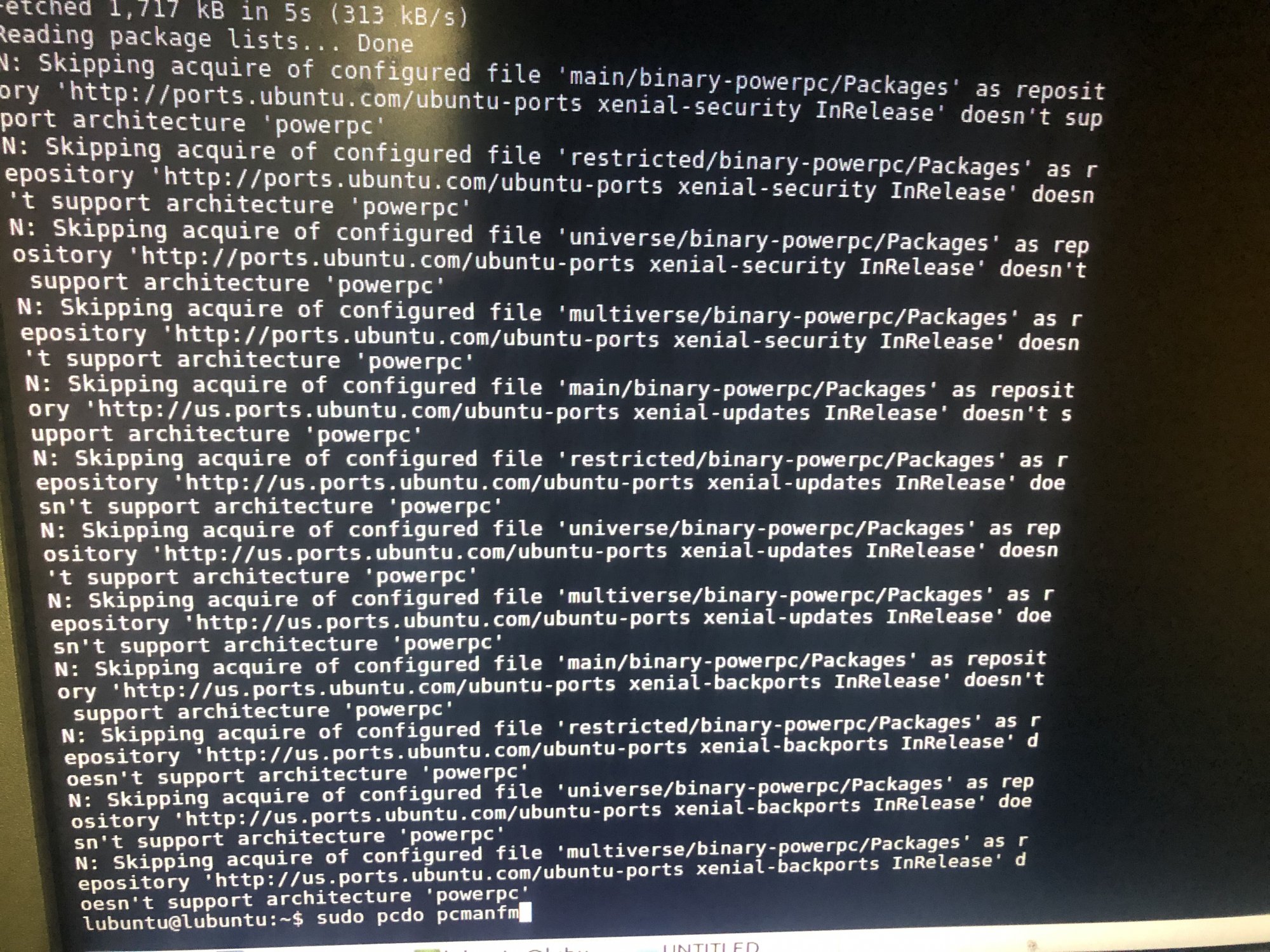

Hi everyone! Repositories seem to be not working.(updates look to be affected) Wanted to update after reinstalling and this happened. Anyone knows working mirror or knows how to report bug?
Updates are crucial for me as original release has some bugs that are fixed by these updates.
16.04 remix.
Are you sure your network is working? If it is, maybe they moved the 16.04 repo to old-releases like they did with 12.04/14.04/etc. I haven't heard that they did, but if they did just edit your /etc/apt/sources.list to point to there if that's the case. Here's the 12.04 updated repo for reference. Just change out ports.ubuntu.com/ubuntu-ports to old-releases.ubuntu.com/ubuntu, save, and apt update.
Network is working. I can still download packages from some repos.
InRelease file seems to have powerpc removed. Was modified recently. http://ports.ubuntu.com/dists/xenial-updates/
P.S. I cannot see Xenial in old releases yet.
Can you please test it, if it works for you?(from live DVD)
Is there a place where to report this problem?
EDIT: tried it today and xenial-security xenial-backports and xenial-updates are affected

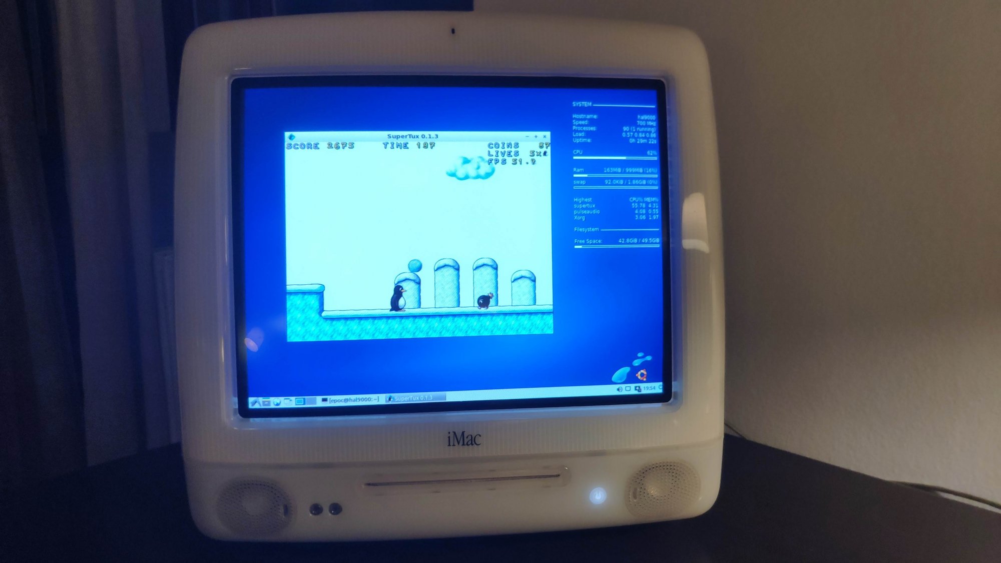

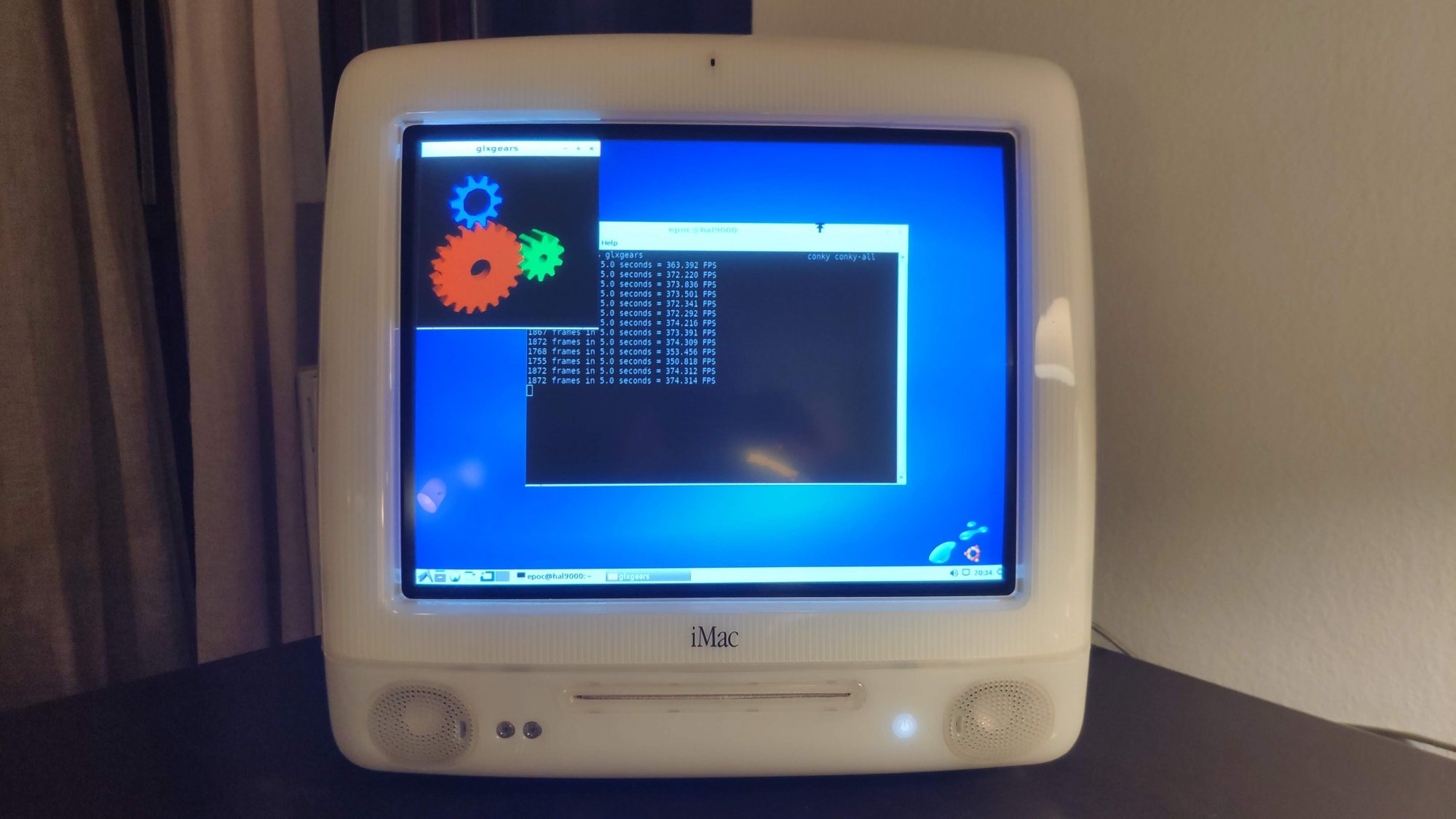

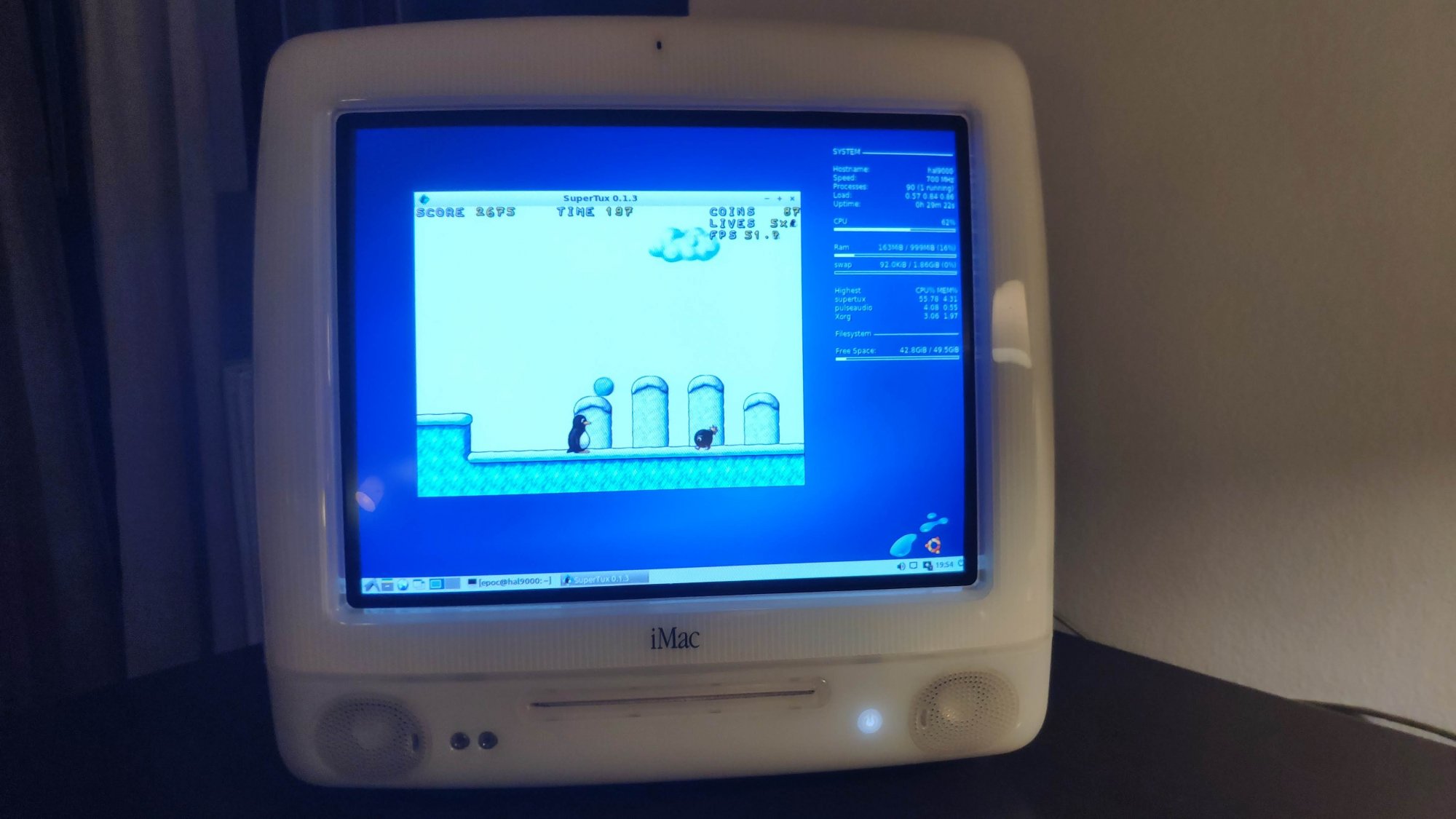

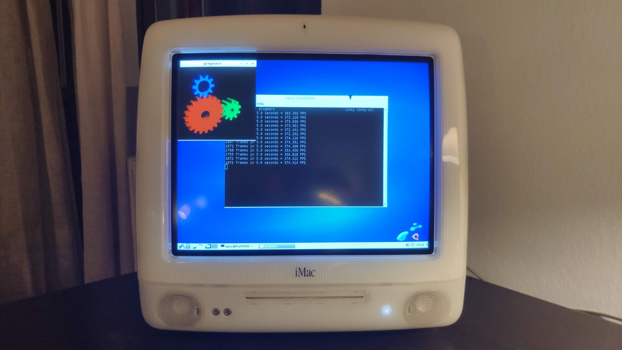

And with additional multiple steps we have a 20 years old iMac G3 with ATI Rage 128 (16M) with HW acceleration enabled!!
I did also several testing to optimize its poor performances passing from 260fps to 370fps in glxGears.
Also some games with openGL <= 1.2 work smoothly:
Happy with the progresses so far.
Next step will be to move away from XAA and to enable "modern" EXA acceleration on the r128. However to do that I need newer drivers requiring tons of newer libraries, so I think I will be forced to test more recent OSes like the 16.04. Let's see..
Have a nice Xmas.
Francesco
