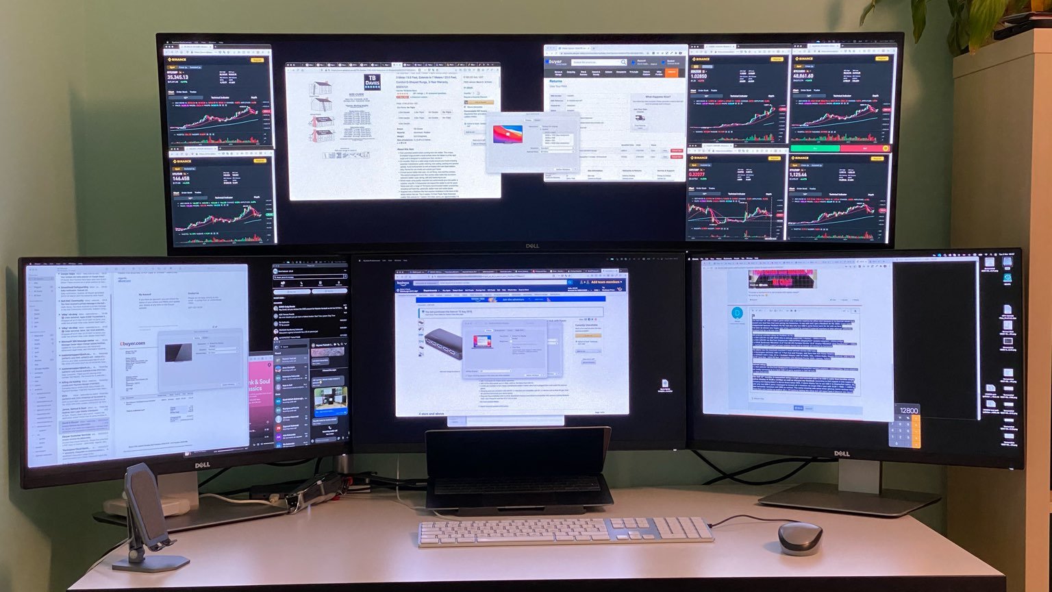

had 3x4k. Love the setup
Testing if one is enough for me 1...(see screenshot)
guess what's the machine ?
just don't say...
Hey there! Are you driving this display using an M1? I notice it is 8k and have yet to see anyone with an 8k machine that works.
Me wondering what would someone do with 5-6 external displays...
Finally get a glimpse what's it like in the matrix! 😉
12800 px total horizontal and 2880 px vertical total resolutions
