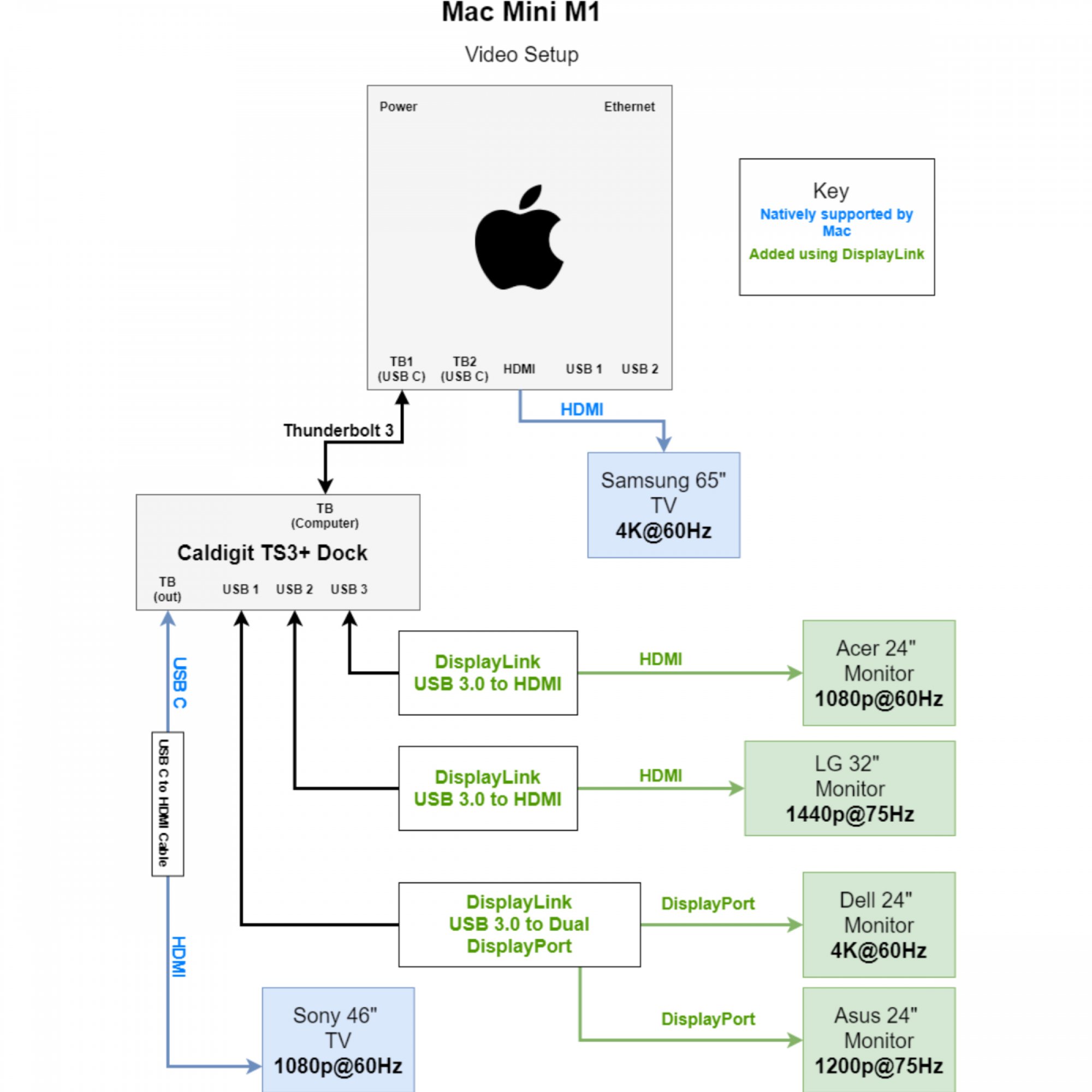

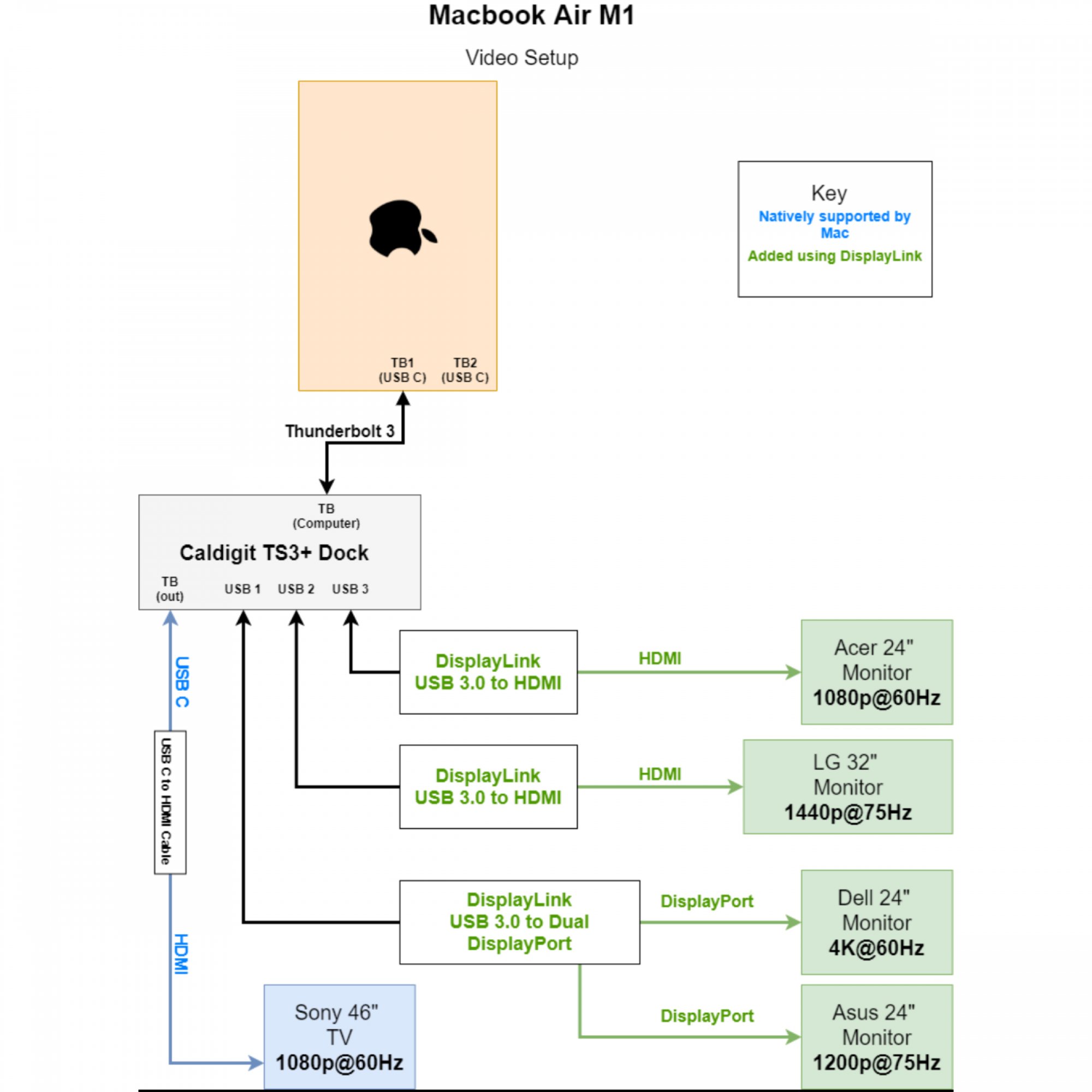

Just wrapped up some diagrams per viewer requests.
Apologies if scaling is off, on mobile.
Amazing - thanks for the diagrams. Do you have the part numbers (or Amazon links) for the USB3-HDMI adapter and USB3-DDP adapters?
(I have the MacBook Air M1, and would be looking to not buy the TB3 dock if possible - so would just have a HDMI to USBC cable in port 1 of the Air, and then use a DisplayLink dongle in port 2 of the Air - via a bog standard USBC-USBA dongle).
Thanks again!
Yeah! They’re all linked in the video description. They’re Amazon affiliate links if that’s ok (I used the funds from the previous videos to get the M1 Macs to make the video, doing likewise for future videos)
