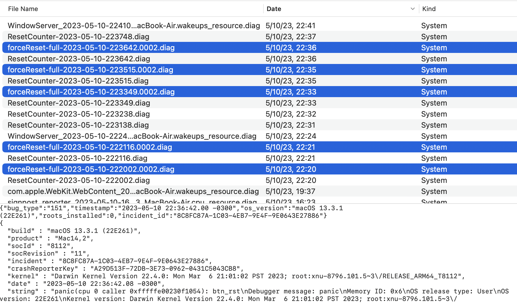

Try to put a wrong password, press F1, F2, then ESC each time. I don't have a exact formula but I can make it happen in less than 20 second playing with the keyboard and using ESC while the screen is locked.
This is my Console > Diagnostics Reports with the crashes that I triggered just now while trying to find a consistent way of reproduce the issue.

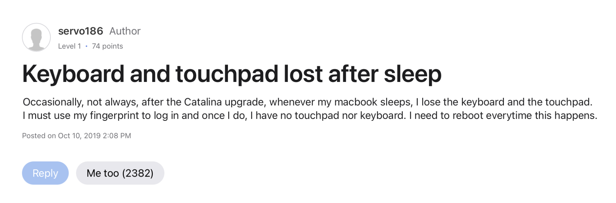

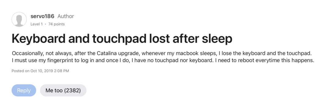

Back in time, when Catalina launched, several Macbook Air and Pro suffered an issue in which the keyboard and
trackpad would become unresponsive after sleep. Sometimes even the Bluetooth keyboard assistant would popup (as if the machine wasn't detecting the hardware). It took almost an year to fix that, so my expectative is low 🤷🏻‍♂️
