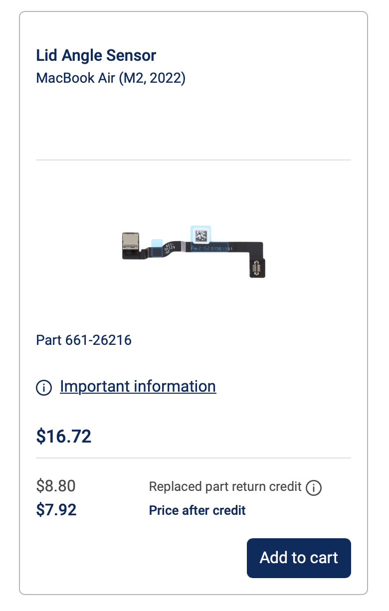

For those who struggle with the issue, I've got a solution update for you. Genius bar contacted me on Monday and they fixed the issue by replacing the display and lid angle sensor. It's a hardware issue rather than a software issue. Hope it helps.
Display, Space Gray Price RMB 3,174
Lid Angle Sensor Price RMB 63
Reactions: dde3
... they fixed the issue by replacing the display and lid angle sensor. ...
I wonder why the display needed replacing. One would think that the lid angle sensor would have been enough. In fact, I'd think that the issue could be "fixed" (in a way) just by disconnecting the lid sensor, as it is mentioned in a post about fixing such a lid angle sensor: "if you are willing to sacrifice the automatic wake/sleep function when opening/closing the lid you could also just leave the sensor out entirely."
I guess if the issue gets annoying enough I might try that route at some point.
I agree that if the issue is related to hardware, the Lid Angle Sensor makes much more sense.
It's really cheap and Apple provides the calibration if you purchase from https://selfservicerepair.com/en-US/order.
