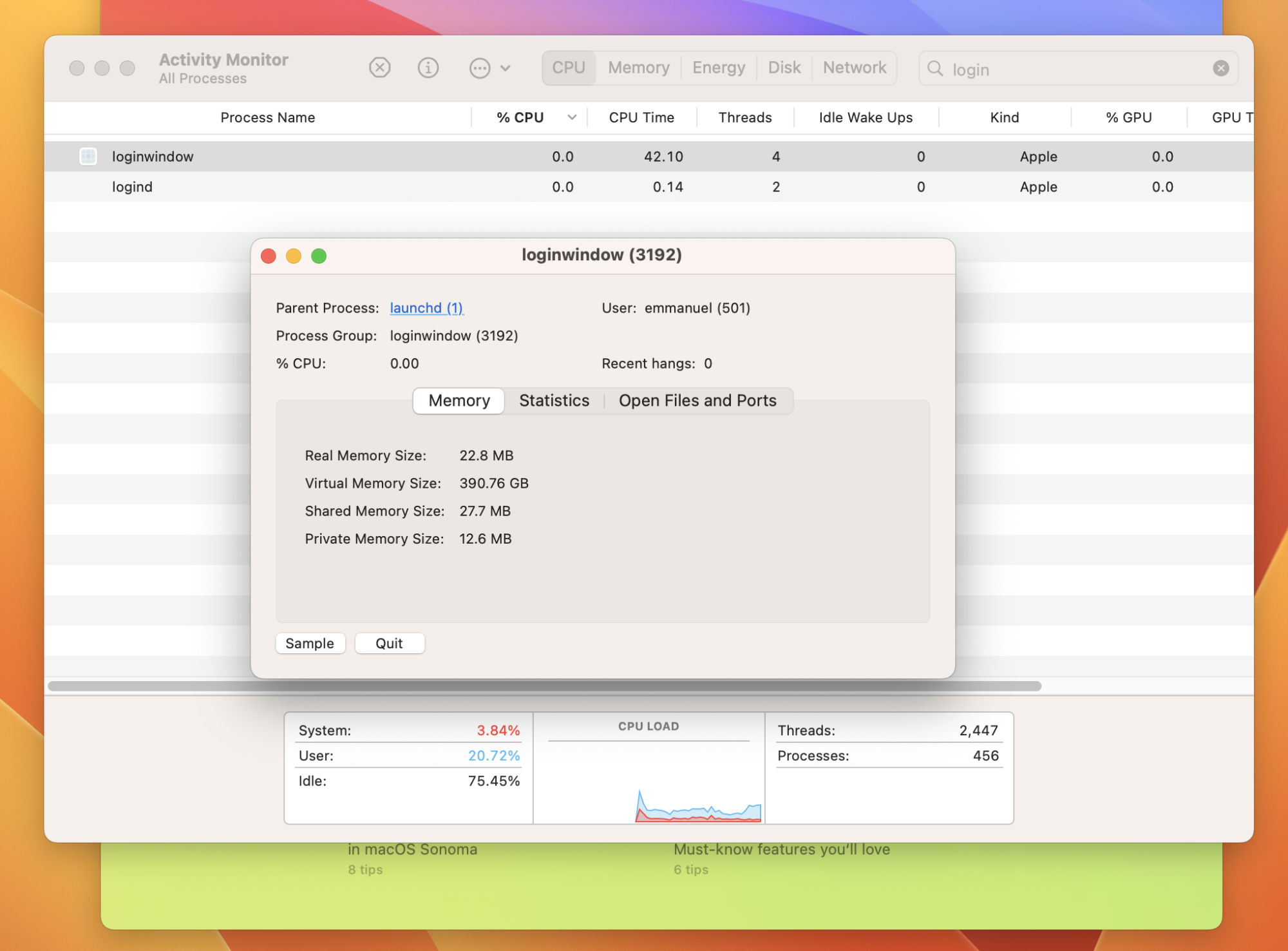

Currently I reinstall Sonoma again and problem is the same but last time I saw error dialog form loginwindow process from apple is crash. It's totally make sense when you waking up from sleep first process macOS will call to open loginwindow app (is use for lockscreen). and when loginwindow process crash everything not wake up aka black screen.
Maybe M2 MBA firmware has issues to loginwindow process. I searching problem about loginwindow it normally on internet but not that way. Another reason when I press touchID button to lock screen sometime not locking screen
It is possible that the problem because "loginwindow"
