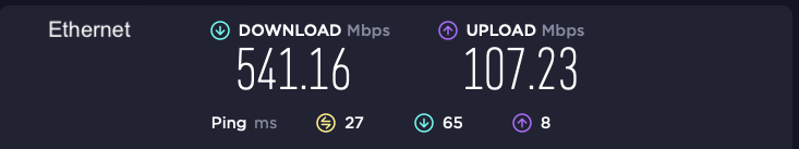

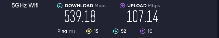

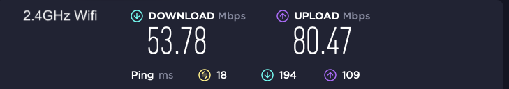

No issues with Ethernet - did a quick test - was a little surprised how awful the 2.4GHz Wifi speed is!
I have 500Mbit cable internet (obviously, the upload pipe is throttled to ~ 100Mbit)
I'm on the Ventura beta, so I'll submit the results so, hopefully, Apple may be able to address that with a driver update - though I'll play around with the 2.4GHz channels as well.
My WAP is about 30" away from the Mini. Yes, that's inches. 😀 My WAP supports 802.11ax - in 2.4GHz mode, it says the Tx rate is 229Mbit.

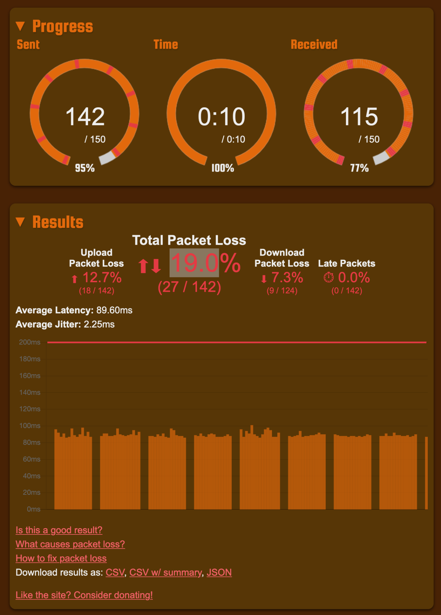

Is this fixed for everyone now? I'm still seeing packet loss when measuring even after trying all workarounds proposed here. Although the internet experience has dramatically improved since 13.2.1. According to ping even inside my home network I get 5-10% loss. But again it's almost imperceptible, probably because TCP retry masks the issue.
$ ping -c 100 192.168.0.1
--- 192.168.0.1 ping statistics ---
100 packets transmitted, 90 packets received, 10.0% packet loss
round-trip min/avg/max/stddev = 22.026/24.431/33.182/2.437 ms
WiFi works without any issues or packet loss.

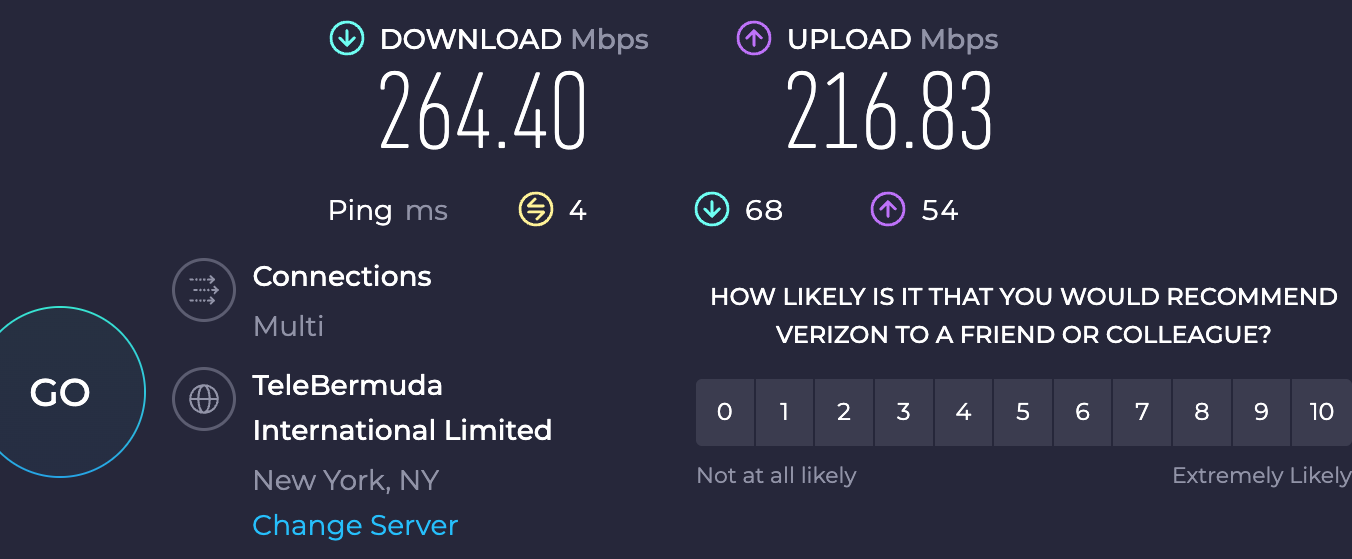

My setup:
Mac Mini M2 Max with 1GB Ethernet
There does seem to be a latency issue as well as overall throughput (notice 68/54 for jitter) - I have FIOS and normally get 800-900mb/s
I get consistently 250-260 Mbs solid

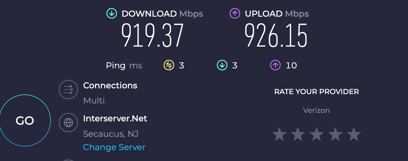

When I connect a USB-C 1Gbps ETHERNET adapter, that works perfectly fine.
I tried going to manual mode, change duplex settings, enabled/disabled all options, and no luck
Screen shot 1 with Built-in
Screen shot 2: usb-c Ethernet Adapter
