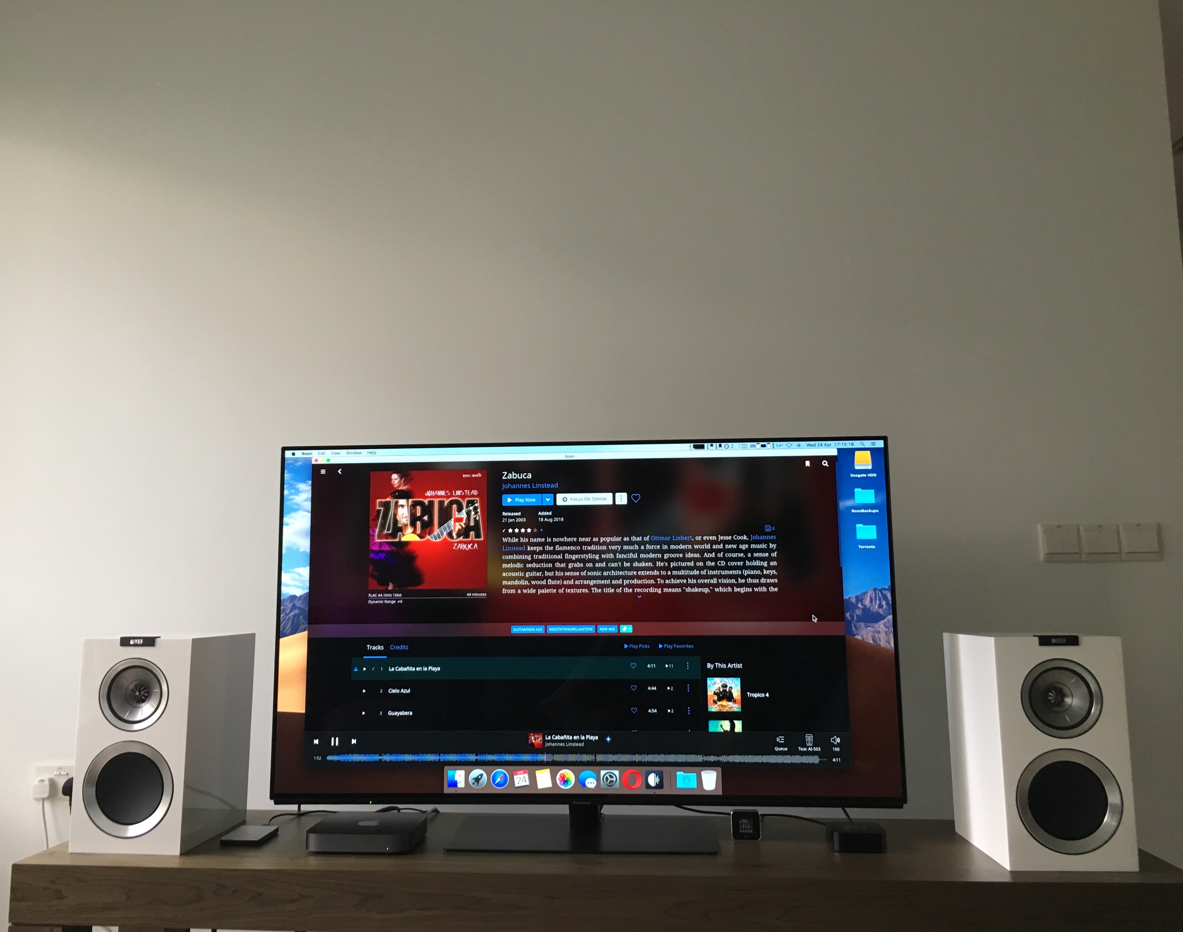

Tonight, I put the mini on the left of the TV, as it was before I had the issue.
Issue seemed to have appeared when I moved it to the right, so let’s see in a week time how it goes.

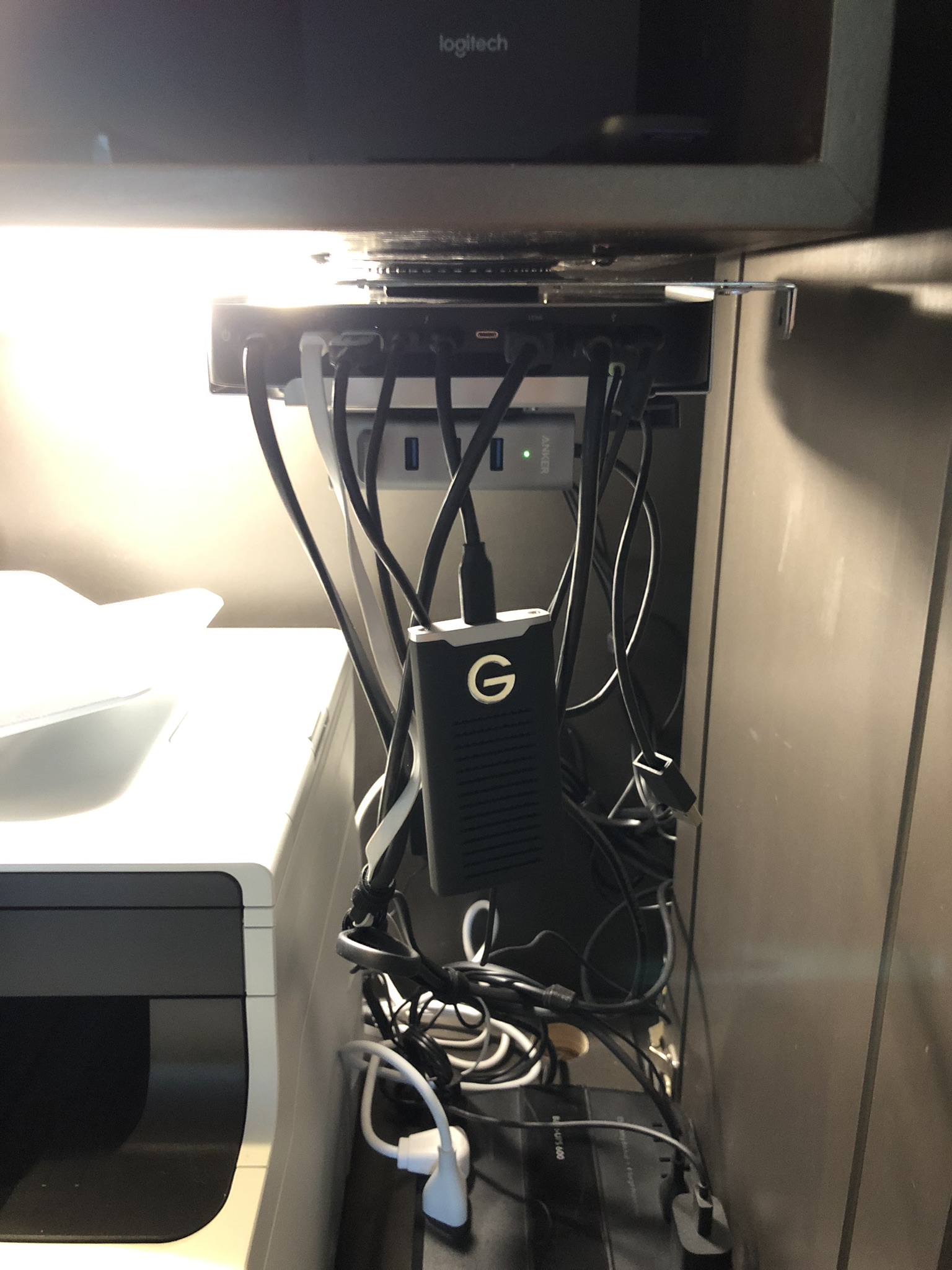

The mini is in an aluminum mount, mounted to the underside of a shelf. I originally had it turned and facing outwards, but found I came across A LOT of BT issues in this orientation. Turning it (the mount rotates) 90 degrees somehow helped with the issues and 180 degrees (the position it's in now, with the cords facing outwards) helped immensely though, like I said, it's not pretty.
From left to right:
Power
Ethernet
Samsung external SSD via USB-C adapter
Anker 4 port USB dock via USB-C
G-tech external SSD via USB-C
Empty USB-C
HDMI to LG monitor
USB3 extension cable, currently with an Apple keyboard and mouse plugged in, in case of BT failure
Logitech webcam via USB3
After a week of use, my BT issues seemed to have disappeared, just by putting the mini on the left side of the TV rather than the right side, very weird!
