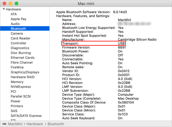

I connect mine via a USB2 extension cable to a USB3 hub as far as possible from my Mini. I have played with the various nvram configs, sometimes the dongle is primary after reboot other times not and I have to reactivate via BT Explorer. I will try the @nanoant suggestion.
Any way to know if yours has the CSR8510 A10 chipset mentioned above?
From about
It does not need to be CSR8510 A10. It is just a tip what device is known to work, if you are looking to buy one, as not all BT dongles are supported by macOS built-in drivers. If you have Broadcom one that works out the box then it is great, please then share the exact product name.
What is most important is that your BT dongle uses USB transport not UART. Because this is what makes sudo nvram SkipIOBluetoothHostControllerUARTTransport=%01 be effective to turn on built-in UART transport based Mac mini radio.
Here's how it look on my side.

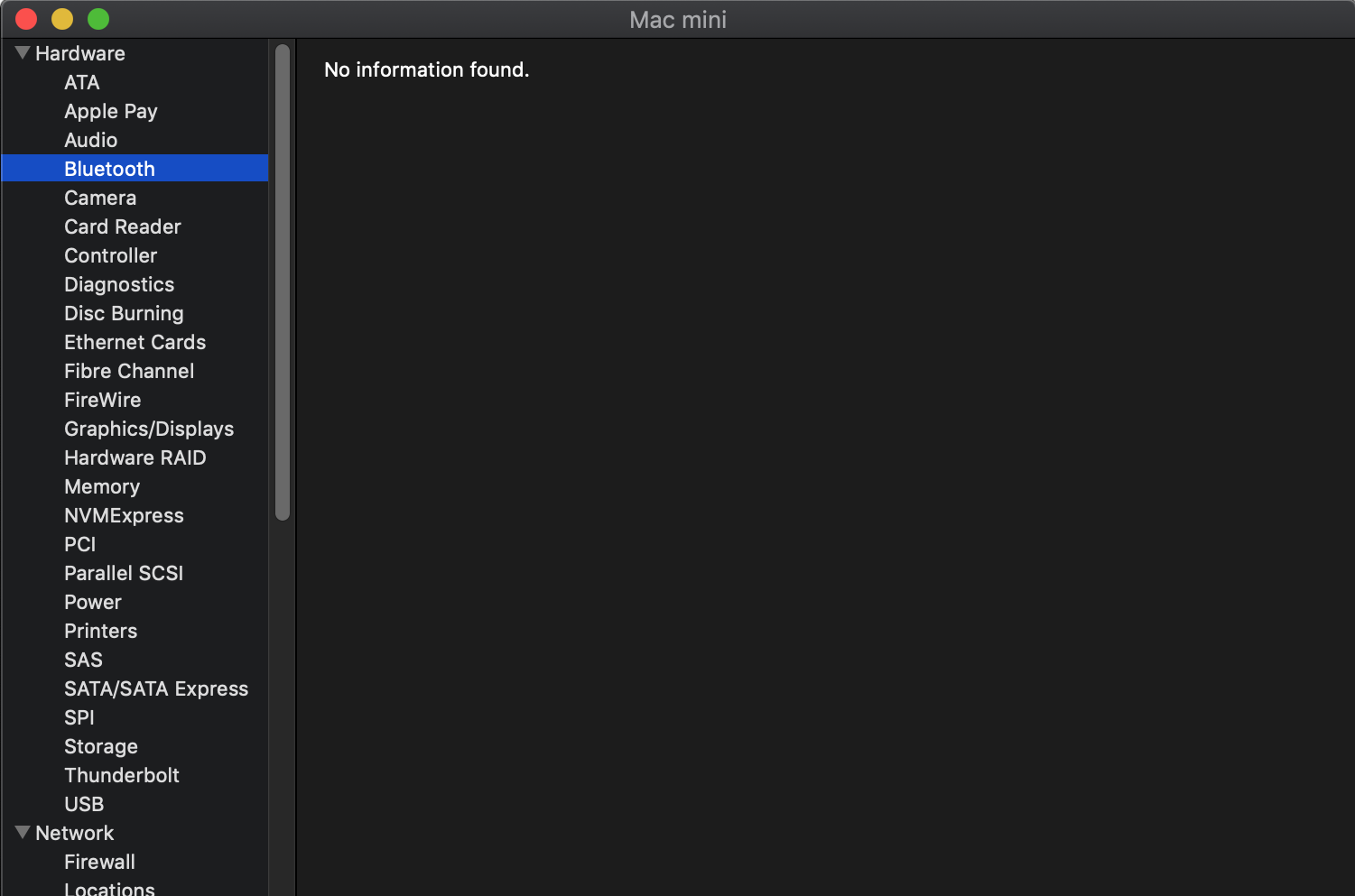

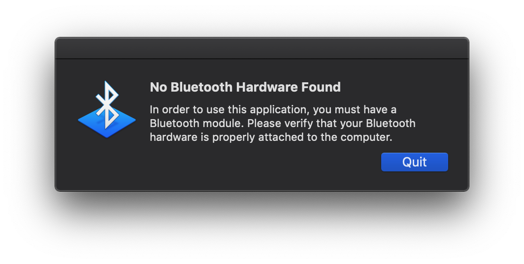

I like many people are having bluetooth connectivity issues with my Mac mini so I took to these forums to try to find a solution. I tried using the bluetooth dongle with the "sudo nvram SkipIOBluetoothHostControllerUARTTransport=%01" in Terminal suggestion to no avail.
My question is, how to I turn bluetooth back on? I tried "sudo nvram SkipIOBluetoothHostControllerUARTTransport=%00" but it does not work. None of my stock bluetooth services are available. Any suggestions?
Thanks in advance....
When you load BT Explorer can you select the internal v USB dongle?
