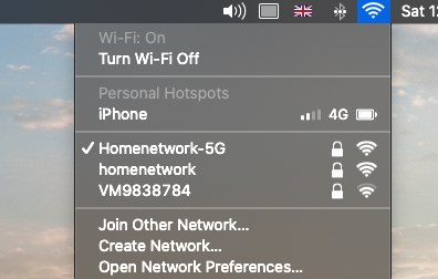

How does one make this change to 5Ghz?
How is your WIFI delivered? Has your ISP provided a router or are you using your own? Either way, it should have 5GHz enabled, all you should need to do is connect to the 5GHz rather than 2.4GHz.
Mine:
I renamed my WIFI so yours won't look like that but any decent router should have 5GHz enabled, you may need to enable it in the router settings, usually by going to 192.168.0.1 in a browser.
