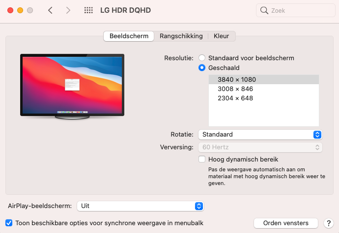

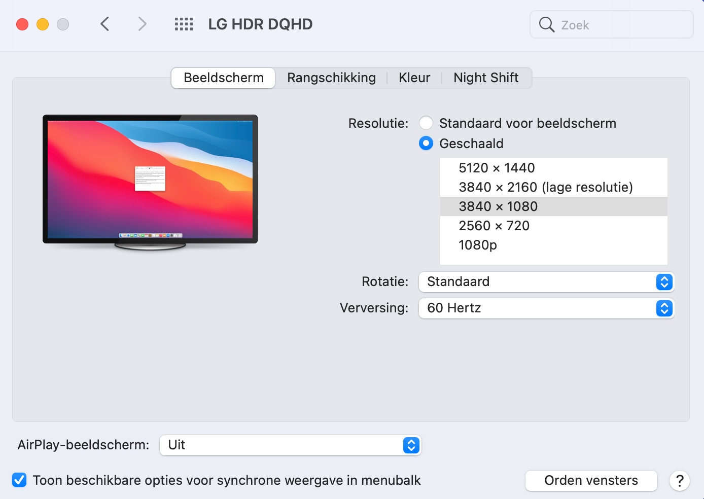

I have similar issues. Attached screenshots on the LG 49WL95C with my MBP15 2016 and the new MBP 13 M1. On the same resolution, the MBP13 M1 is clearly less sharp. And higher resolutions than 3840x1080 don't show up. If I hold OPTION, then I can select 5120x1440 and that seems fine. Unfortunately I want to run it on 3840x1080. On my old Macbook it's excellent. On my new Macbook the sharpness sucks.

That is quite a lot of difference to my eye... Liveable, but not great! Have you tried EasyRes as per the previous comment?

Yep. No diference. Interesting are the options I get in EasyRes. It makes a difference between Retina (2x) and Standard (1x) It seems al higher resolutions are not Retina. No idea what it means though.

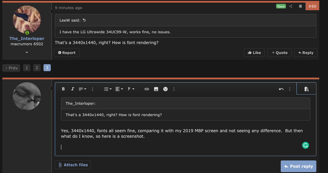

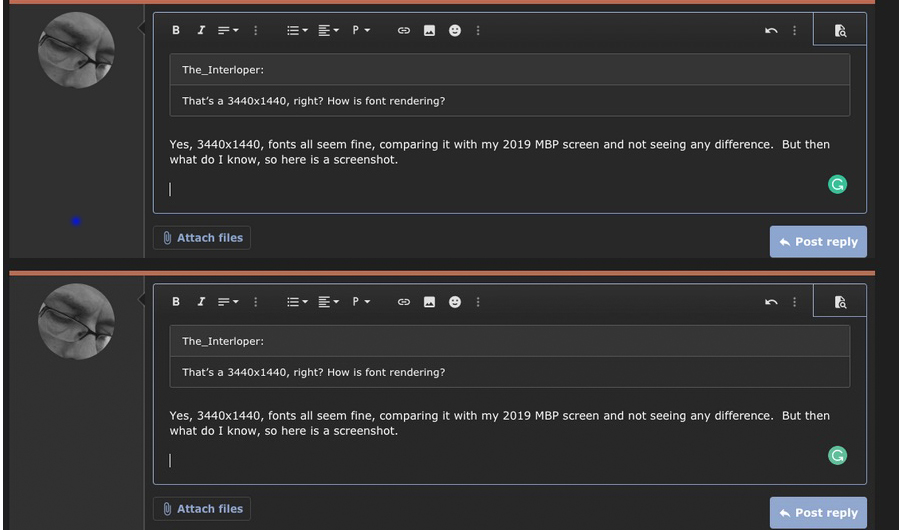

That sounds promising! No lag or blurry fonts? Can you screenshot your settings e.g. UI looks like
I have no lag, no flushing lines, no connection issues. I don't see any blur but I must admit I'm not very picky so here's the screenshot. One from the display attached to MBP 2019 running Mojave (via Display Port) and the other with the display attached to Mini M1 via HDMI. I know it would be best to use same connection type for both but I couldn't connect Mini via Display Port without major hassle.
