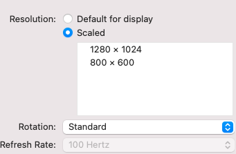

Hey, thank you for this incredibly helpful reply. One follow-up: Does your last line mean that you expect future MacOS software changes to solve this resolution problem? I got an ultrawide (I need for teaching) with a M1 mini but it doesn't give me ultawide. Do you expect it will (assuming the right connections) or should I just return the monitor.
Try opening the display preferences, then WHILE HOLDING the option key, click on the 'scaled' option / radio button. It will hopefully show you more resolutions including the one for your monitor.
I have to set this each time my machine wakes at the moment, so instead I have put sleep to take longer than usual for the time being until a fix is issued.
I also find that if I shut down the machine, when I turn it on again the resolutions are still correct. It is only sleep that is messing things up.

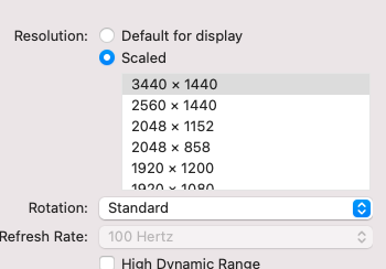

This is my before and after

I appreciate that isn't really a whole lot of help to you though and I hope a fix comes soon to remove your problems.
For me this doesn't work because also if the monitor goes to sleep the weird resolution come when I press mouse button to make the Mac mini alive. I have to remember to power on the monitor before everything
I think that I have understood the problem this morning.....If I press the power button of the monitor before Mac mini exit the sleep all works great. If I make the Mac mini exit from sleep with the monitor in sleep the weird resolution come.....
