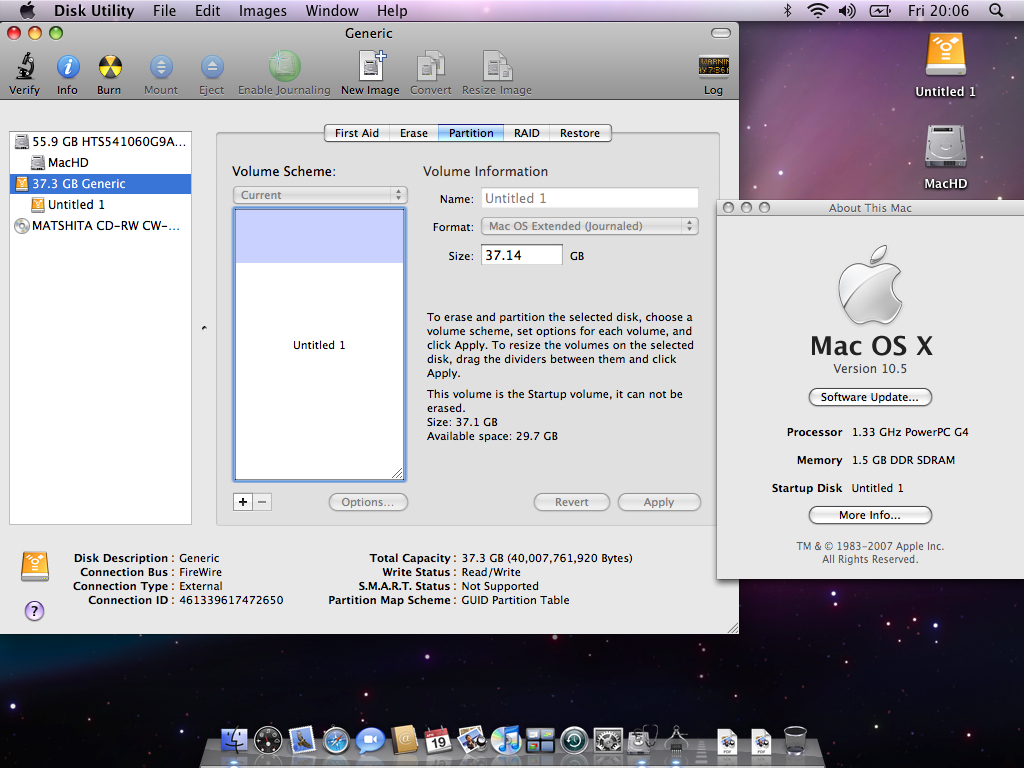

As it happens, I dug out my mid-2005 iBook and it definitely boots from GUID
As with the Mac Mini, Leopard refused to install on a GUID partition. I didn't persevere with the Mac Mini but this time I installed Leopard to an FW drive I partitioned under APM. After Leopard was installed, I got out iPartition and changed the partition scheme to GUID. The newly improved Leopard volume would not show in StartDisk but showed up in the Boot Selecter screen after holding down Alt after the chime.
It seems that booting from GUID is a thing but installing to GUID still requires an Intel Mac.
