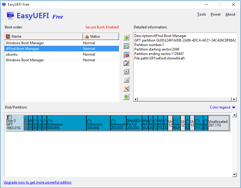

I suppose this is a bit late, but I just happened across this tool and I remembered your question.
http://www.easyuefi.com/index-us.html
Huge disclaimer - I have not tried this myself. I have no idea if this will work on a Mac, and it does not show "OS X" in its list of supported destination operating systems.
