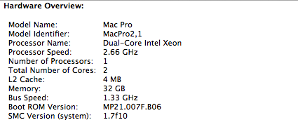

hi. after weeks of trying to update from MacPro1,1 to 2,1, i finally was able to update the firmware (Mac OS X 10.7.5).
as i found out, the firmware tool and/or firmware update software that can be downloaded in these forums, were somehow corrupted.
i am attaching the firmware tool and firmware update software, that worked for me.
i am also including this downloaded video from youtube, that worked for me.
i hope this helps others too.
edit: somehow i cannot upload the firmware update file. it is a .dmg file. if anybody knows what the problem is, please tell me so i can upload it (if it is even permitted here). the firmware update file that worked for me has a file size of 2.939.532 bytes.

Hi everyone! New to the forum, not new to MacRumors though!
I know this thread is a couple years old by now.. I was lucky enough to buy a 2006 MacPro 1,1 recently and I wanted to upgrade to 2,1. I followed the steps provided by the video, posted by @redAPPLE. It looked good. Files were there, scripts ran through, but after rebooting my mac (after complete shutdown), it still tells me 1,1...
Anyone else who had this issue? Very much looking forward to your answers! Thank you very much in advance!!
- Running MacOS Snow Leopard on that machine.
EDIT:
I found a reddit that had a special version for my specific mac.. Now it upgraded!
