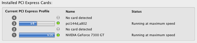

I have one of the first Mac Pros from 2006, and I want to move my OS to an SSD to increase performance. I have all of the SATA bays full with large spinning disks, so my plan was to install an SSD in a PCI adapter card. Here is my set-up:
  • Mac Pro 1,1 (2006), running Mac OS X 10.7.5
  • Lycom DT-120 PCI adapter for M.2 key SSDs, installed in PCI slot 3
  • Samsung SM951 512 GB SSD installed on Lycom card
When I boot the Mac, the SSD does not appear in Disk Utility, and the PCI section in the System Information app shows “There was an error while gathering PCI card information.”
For what it’s worth, the Expansion Slot Utility sees the Lycom card, as evidenced by this screenshot.
Does anyone have any ideas what the problem might be, or suggestions for troubleshooting/fixing it?
Thanks in advance.

An EFI32 GT120 would solve your problems.
No speed King but for less than $90 you would have boot screens and OS support in both Lion and El Cap.
If your 7300 is still good you could recoup much of the $$$ selling it.
If you might wish for OpenCl power or gaming a 7950 or 7970 would be good, and you can flash many of these yourself.
They don't like 10.7.5 so more limiting
