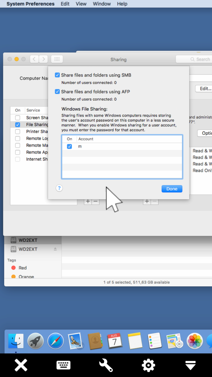

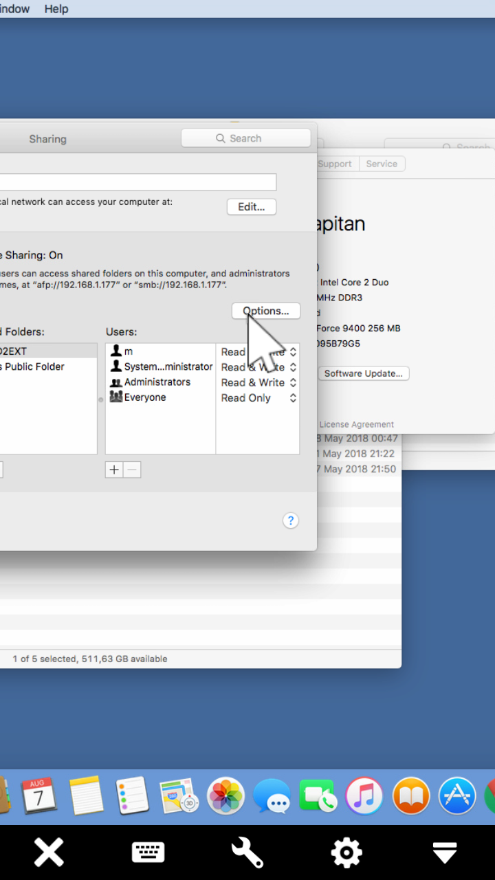

OK here are my Mac Mini's sharing preferences. It has a static IP and PC sharing is checked. You need to click options to get there. Teamviewer screenshots on my Android phone...
Edit: Nevermind my previous post. I just realized you're using Mavericks. It introduced SMB2 by default and was very buggy. Is there some reason you won't upgrade your iMac at least Yosemite, if not to High Sierra? Apple has improved SMB2 support in later versions of macOS so you really should get off of Mavericks unless you have a very compelling reason to stay on it.
View attachment 774857 View attachment 774858
