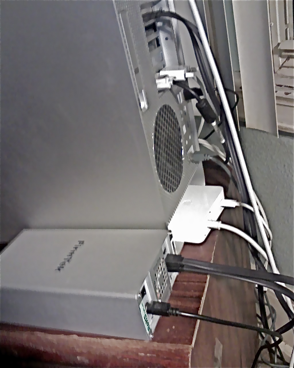

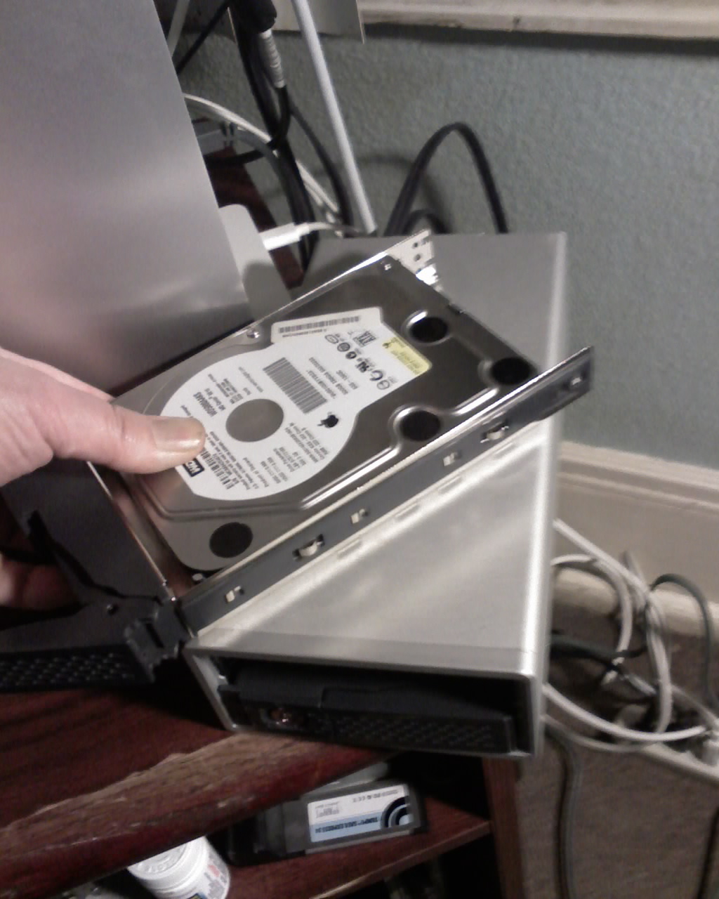

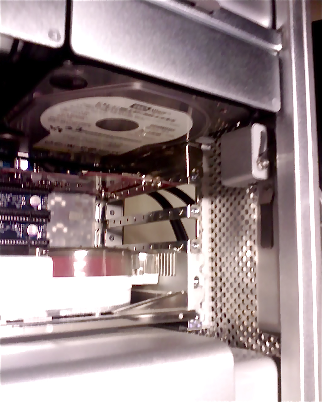

Ok I can give you pics of the whole thing. And maybe I'll show you windows running COD4 with a 8800gtx to, yes thats right GTX baby
Ok heres the pics

Ok Later I'll post Vista Booted to it, I have to change cards because the new mac pro wont boot windows with the old mac pro ATi card in for some reason. Weird I know.

This is really cool (and fun to see). Thanks for showing what ya got cookin'. I'm sure I'll have questions about how to get boot camp on the eSATA disk and how to make it all work at boot up but since I don't get the new MP for two weeks there's time for an education 🙂
