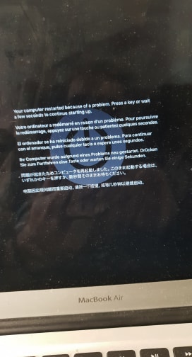

I installed the ssd Samsung 960 Pro 512GB on my mac air early 2015 with Mojave 10.14.1 (18B75) and everything is working well except that I have the following error when installing Windows 10 via bootcamp. Is anyone has an idea about this error ?
Thanks guys !
Thanks guys !
What bootrom version do you have?
Reactions: baskerv
Don't know if it is right but this what I find ( sorry my MBA is in French ):
Version de la ROM de démarrage : 182.0.0.0.0
Version SMC (système) : 2.27f2
Do you think I have Firmware issues ?
