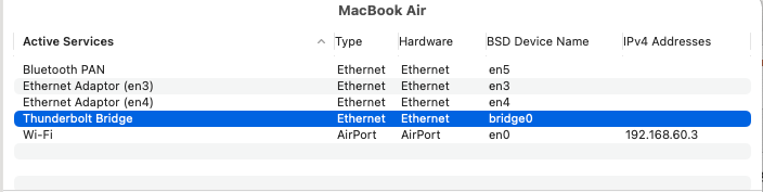

Anyone else notice any issues with their TS3+ connected to the new M1 based Macs? My Air is connected and the Display, Mouse, Keyboard, Audio all seem to be working fine but the Ethernet connection through the TS3+ is not. In the Network control panel it shows the Thunderbolt bridge as inactive. That appears to be the only issue so far.
The Thunderbolt bridge is not the NIC in the dock, Thunderbolt can be used as a peer to peer NIC directly. When you connect two Thunderbolt-powered computers they can create an ethernet lan through the Thunderbolts bus, that's the meaning of "Thunderbolt bridge".
The NIC in dock should appear as something called "Thunderbolt Ethernet Slot"

On the Mac the Thunderbolt Bridge is the only thing that is showing up in the Network Settings for Thunderbolt.

Can you open System Information and see if your NIC is listed under Ethernet Cards??
The Thunderbolt Bridge is the only one listed for Thunderbolt

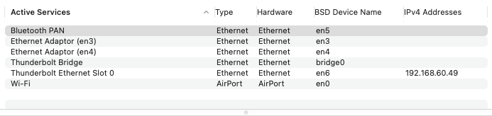

Very strange behavior. It was not there earlier. I have spent a couple hours working on WIFI and plugged back into the Dock and now the Ethernet interface is working. Did not change anything. Will have to do some more testing.

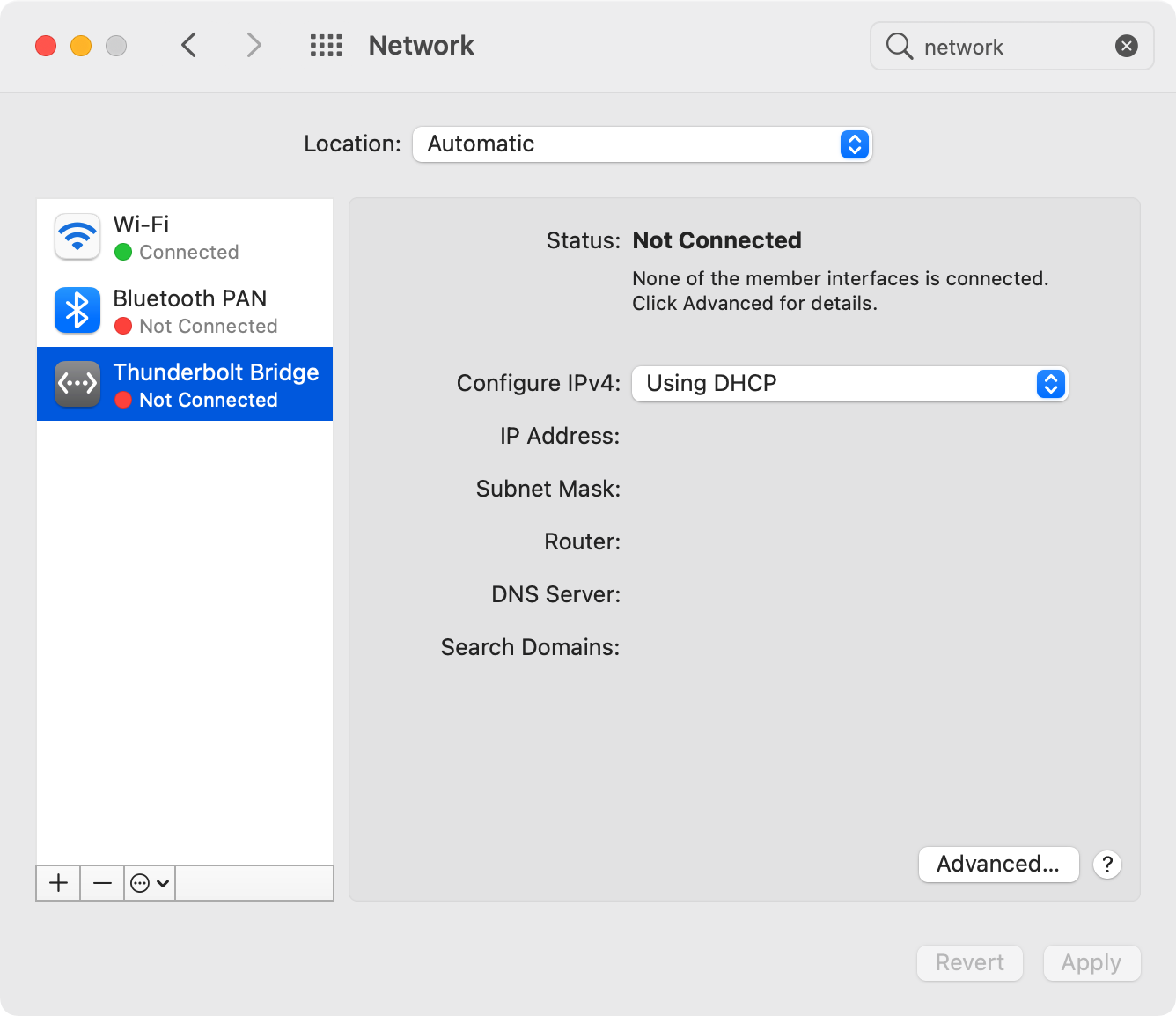

I have a MBP13 M1 and a CalDigit TS3+, and also having trouble getting ethernet port to work. (Everything else seems to work great with the TS3+ though.)

Yeah, I saw that but I couldn't get those instructions to work. In network settings, it just says "Thunderbolt Bridge: not connected" no matter what I add.

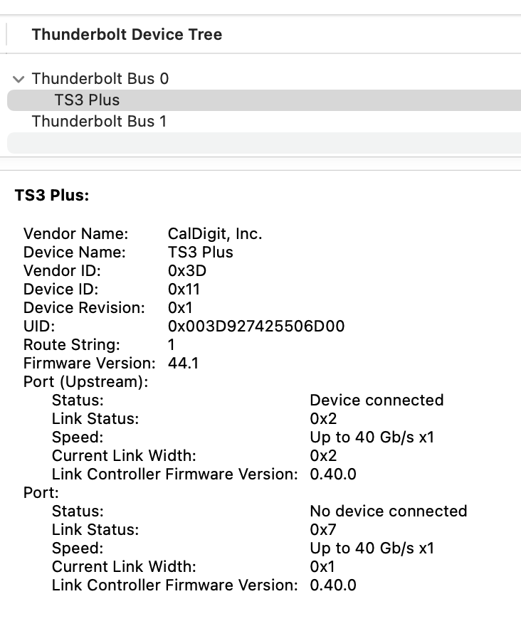

I haven't tried a firmware update. Is there a way to know what the current firmware version is?

I don't know what the older version is but it is visible somewhere. It'll be in system information under hardware I think.

In system preferences > Network what do you see if you click on the thunderbolt bridge?
Are any fields completed?

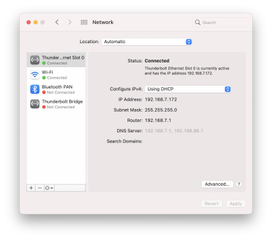

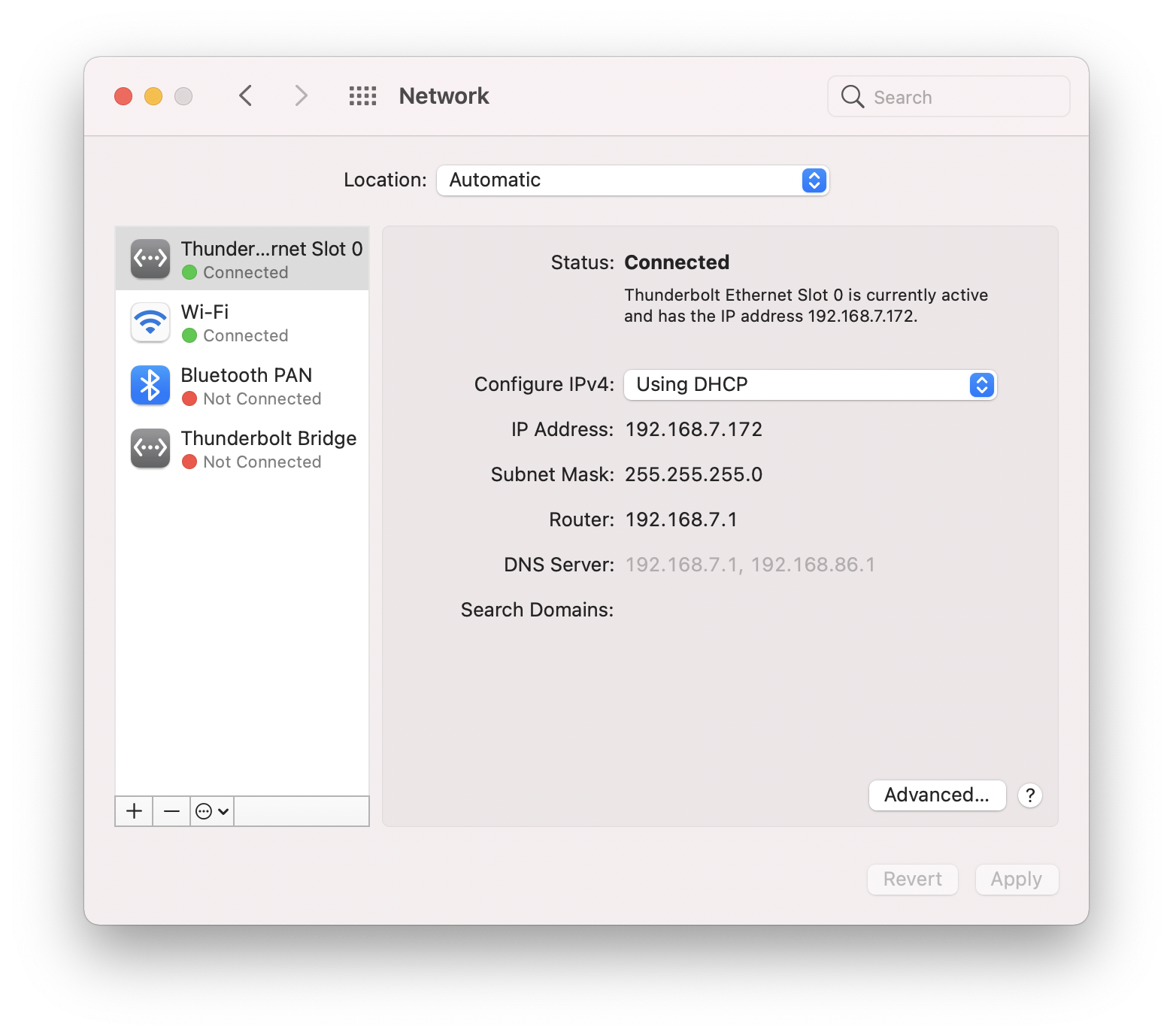

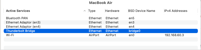

I too bought the ts3+ with my m1 mba. Ethernet is working for me (I didn't do anything other than plug it in and ensure that it is getting ethernet through tb). Although not related, I did download and am using the docking station utility.
Both tb ports are working.
Reactions: Quackers
