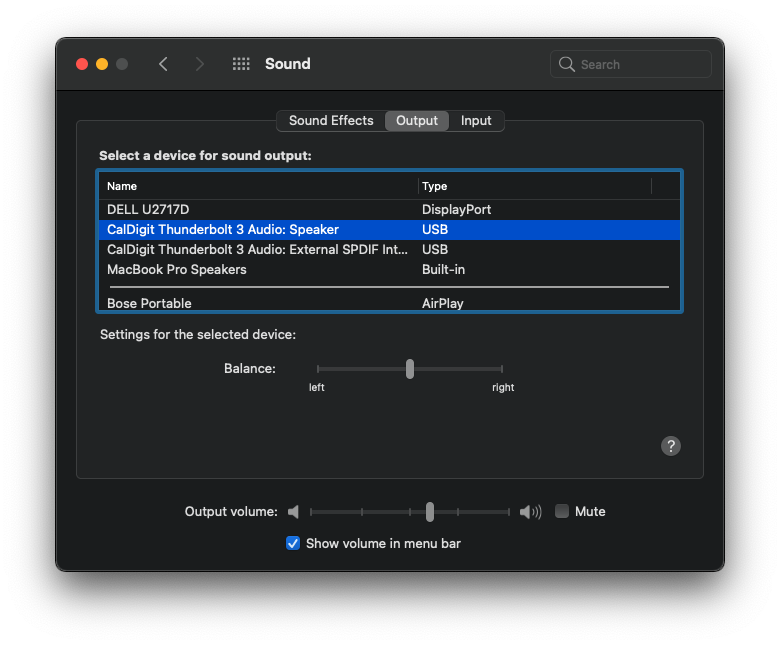

Anyone else having audio issues with the caldigit TS3+, not being able to choose it as an audio output source on M1 running Big Sur?

I'd have to dig around to find wired earbuds to actually test this, but seems selectable here?
Reactions: KSB
On my end, cannot make S/PDIF (Optical) output works with M1 Air. Even if selected as an output in Sound Preferences, no sound comes out of my receiver. Same setup works with PC. I have to use the 3.5mm output to my receiver instead.
