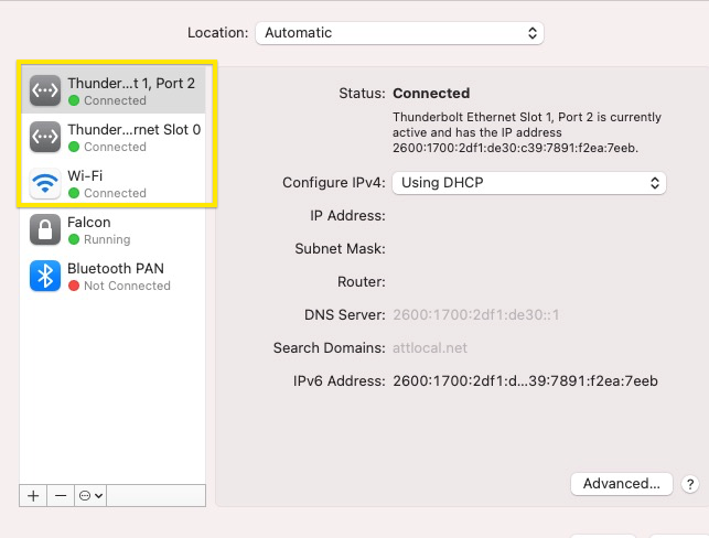

When I plug in ethernet to my TS3+ my Network prefs show that I'm connected to "Thunderbolt Ethernet Slot 0" and "Thunderbolt Ethernet Slot 1, Port 2". Should I remove one of these? Also, why does it show me connected to both Ethernet and WiFi? Once connected to Ethernet shouldn't WiFi turn off?

First, connecting ethernet doesn't turn off or disconnect wifi on Macs.
Yes, you can delete one or both of the ethernet connections. If you delete both, just add one back and it'll be named the default for your dock.

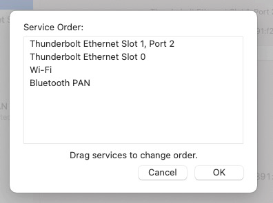

OK thanks. Re: WiFi not turning off when connected to ethernet—should I disconnect from WiFi or turn it off altogether when connected to Ethernet or will the Ethernet connection take preference over the WiFi based on my Service Order?
As long as ethernet is listed ahead of wifi in the service order, you don't need to do anything with turning it off or disconnecting.
