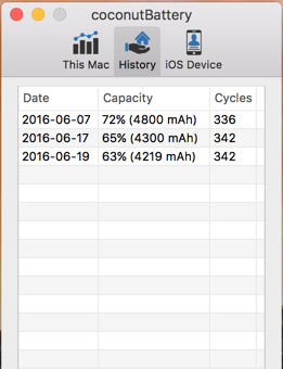

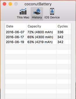

I bought this macbook pro 2013 2nd hand and after a while i noticed that the battery performance decreased quite fast, so i wonder if this is normal and otherwise how much does it cost to replace the battery?

it last max 2h with like normal usage browsing and so on, but if i start some more performance taking program it can go down to around 40 min
Is the unit warm when on battery? Try posting an image of Activity Monitor with the Energy tab selected after you've used the device on battery for an hour or so.
I'd guess its a crap 3rd party battery, no way is that capacity decline normal, it'd be useless in a month.

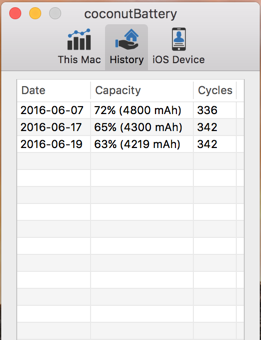

I bought this macbook pro 2013 2nd hand and after a while i noticed that the battery performance decreased quite fast, so i wonder if this is normal and otherwise how much does it cost to replace the battery?View attachment 636864
That isn't normal - Apple suggests that there should be 80% of the original battery capacity after 1000 cycles, but you've got 65% after a third of that time. Definitely replace the battery if you can afford to; prices vary by country but it should be on Apple's website.
now it says 66%

Is there anyway to see if i got a 3rd party battery?
Not without taking it apart I don't think and it could be a good fake with correct labelling etc. However huge and immediate capacity decline is a hallmark of the crap non-Apple batteries out there...
