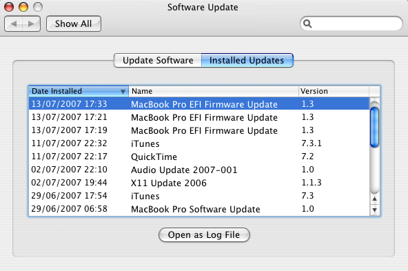

Software Update told me the update was available. I downloaded and installed and it was fine. I then went back into Software Update and it said it was available again, so I installed again. I now have 4 instances of it being installed. See attached pic.
Can anyone help?

Ok, I realise I need to hold the power button down after switching on to get the update to begin and install properly!
I also figured if I edit: /Library/Logs/Software\ Update.log
I can delete the extra lines and so only show the update as being installed once!!!
