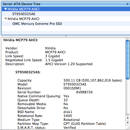

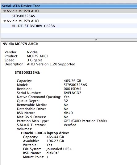

I believe I got he jumper on the correct pins (far left two pins when looking directly at the edge connector).
Also, can you tell me just "where" you are seeing the "negotiated" speed field in profilier? I simply don't see it, - just the max speed that the ATA controller will do. Could this be an OS version thing ? (I'm at 10.5.8). (Profiler screen-shot below)
Also, and something I was never sure about in this entire thread is, is this issue limited to the 17-inch MBP (5,2?) Mine is a mid-09 (I think) 13-inch MBP55.
It's interesting that you too felt that is was SMS related (like mine very much seems to be). Thing is, and like I said, I can run I/O until the cows come home (complete to and from to external disk with TimeMachine, or UNIX copy's etc), and it never hickups. But when I pick it up I get freezes, beachballs, and I/O errors, some of which result in a read-only filesystem requiring a restart (which really really sucks). I hate it. I'm at witts end.
Any other suggestions? At this point, do you think that it's worth trying the EFI downgrade ? I'm just totally beside myself. I know I can just go out and drop more money and just get a MB air, and forever deal with transfering, and merging files, and my environment, but then I'd be limited to max disk space. But that still wouldn't address this situation.
Next realistic step would be to re-install a bare-bones OS on the old original 250MB disk, and take it in. My fear is that there wouldn't be enough stuff on the bare-bones OS to be able to re-create the problem (i.e., no Microsoft Office, no real iPhoto library, etc to create any real I/O). I dunno.
I'm all ears. But mostly interested in why I can't find the "negoiated speed" field in System Profiler. Thinking that it's an OS version thing, I did order 10.6 from the Apple store. Shipment confirmation notice E-mailed to me the other day. But I need to do something soon.
(Note: The hard drive "name" is still at 'Hitachi' from the two previous 500MB Hitachi drives I tried, - I just haven't changed that "name" yet)
I've got mine all set up, but I couldn't put the jumpers on it b/c it wouldn't fit the HDD and the SATA cable in the MBP. I just reset the PRAM when I booted the first time, and I'm having pretty good luck (no beachballs!) so far. I haven't checked the System Profiler yet, but I'm okay to this point...

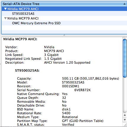

I think I'm running okay with the Seagate Momentus 5400.6. It seems faster than the stock drive, but I've also noticed that it doesn't "click" when I pick it up, and that makes me think that the Sudden Motion Sensor isn't working with this drive. I don't know if that's a setting I need to tweak or not, but it kind of bothers me a little bit. There may be nothing I can do about it, though...
See Profiler screen shot below.
This is System Profiler Version 10.6.0 (217).
I'm currently running OSX 10.6.8 on a mid-2009 15" 5,4 MBP.
(This 500GB Seagate HD is mounted in the original HD spot in the MBP; my OWC SSD is mounted where the DVD drive used to be.)
...and something I was never sure about in this entire thread is, is this issue limited to the 17-inch MBP (5,2?) Mine is a mid-09 (I think) 13-inch MBP55.
I'm not sure about other MBP's, like the 17", but I think the issue hit the 15's" the hardest, b/c they were the ones that were sold with EFI 1.6, which we upgraded to 1.7, then the trouble started once we decided to change out the HDD's.
I've read in this and other forums that the EFI downgrade has worked for some; while others couldn't get it to take. I didn't do the downgrade at the start b/c I wasn't comfortable with the source of the file. The original link to the downgrade tool was inactive; the other source I had found had been loosely translated from Russian. I'm no security expert, but I didn't feel great about installing something at the firmware level that I wasn't sure was clean. To be fair though, I'm sure those who have successfully done the downgrade would have reported any security issues since, and I haven't read any to date. Also, I was so frustrated with the issue, had I not been able to force the HD down to 1.5Gps, I probably would have done the EFI downgrade just to get some relief. (Note: I did consult the Genius bar at my local Apple store, and they were unaware of any EFI downgrade tools available to them.)
I have read that some folks had brought their machines into the Apple store, demonstrated the problem, and had their logic boards changed out (=different firmware) and the problem was taken care of. I think this was done by them closer to their purchase date, and hence, were under AppleCare; I wasn't, so that wasn't available to me.
