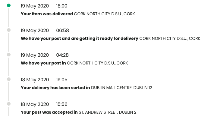

I posted my letter of complaint to Cork yesterday and it reached Apple's HQ today.
Letter Delivered to Apple
I'm aware my Irish consumer rights have expired after 6 years, and that Ireland doesn't maintain a hidden defect clause in their law 🇮🇪. It's at the discretion of each EU 🇪🇺 member state to modify & maintain consumer law beyond the standard 2 year EU guarantee – and France is the only country to maintain a law on les vices cachés 🇫🇷.
Hopefully, I will receive some response from the complaints department. The actual Customer Support does not want to talk about the Mac's dGPU issue…they always disconnect my call.
Edit: A member of the  Apple Customer Relations Administration Team in Cork is calling me soon to discuss my letter 🙂

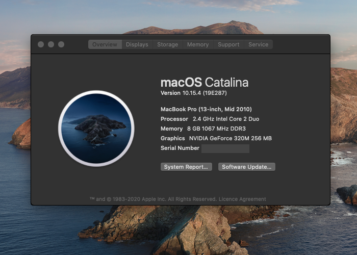

I'm still using my 2010 13" MacBook Pro, running patched Catalina with 256 SSD and 8 RAM upgrade…and I'm 18.
I'm going to buy the new 2020 16" for university with upgrades…if it even releases.
