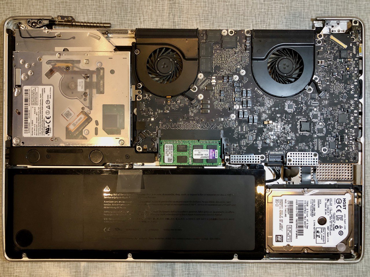

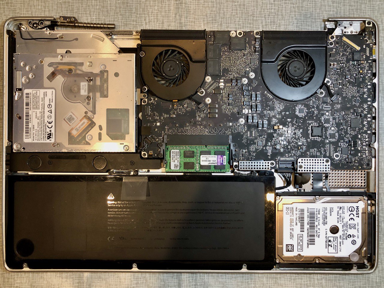

I have a MacBook Pro (Late 2011, 17-inch), and live in Dublin, Ireland. It was working fine until it failed to boot up one morning. I have no way of diagnosing it, but it sounds like what you describe [GPU: AMD Radeon HD 6770M 1024MB].
All the authorised retailers here in Ireland say it has vintage status too, so I'm not sure what to do.
Difference being your MBP has significant physical damage, which Apple will all too readily point out. The Radeon dGPU can be bypassed, equally it's not straight forwarded. The failure of the dGPU is a valid case as it was a manufacturing flaw on AMD's behalf and exasperated by Apple's poor cooling solution, however the Notebook being disassembled by the user very likely breaches Apple's T&C.
The AMD Radeon HD 6770M is indeed problematic and you may get lucky and have an MBP with a more tolerant chip, equally if pushed hard they tend to fail in time...

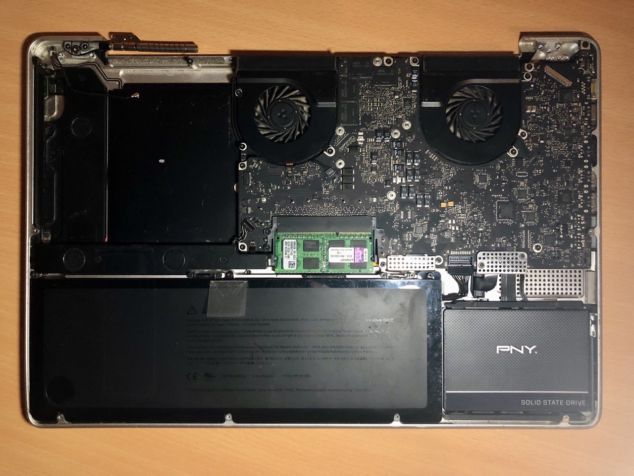

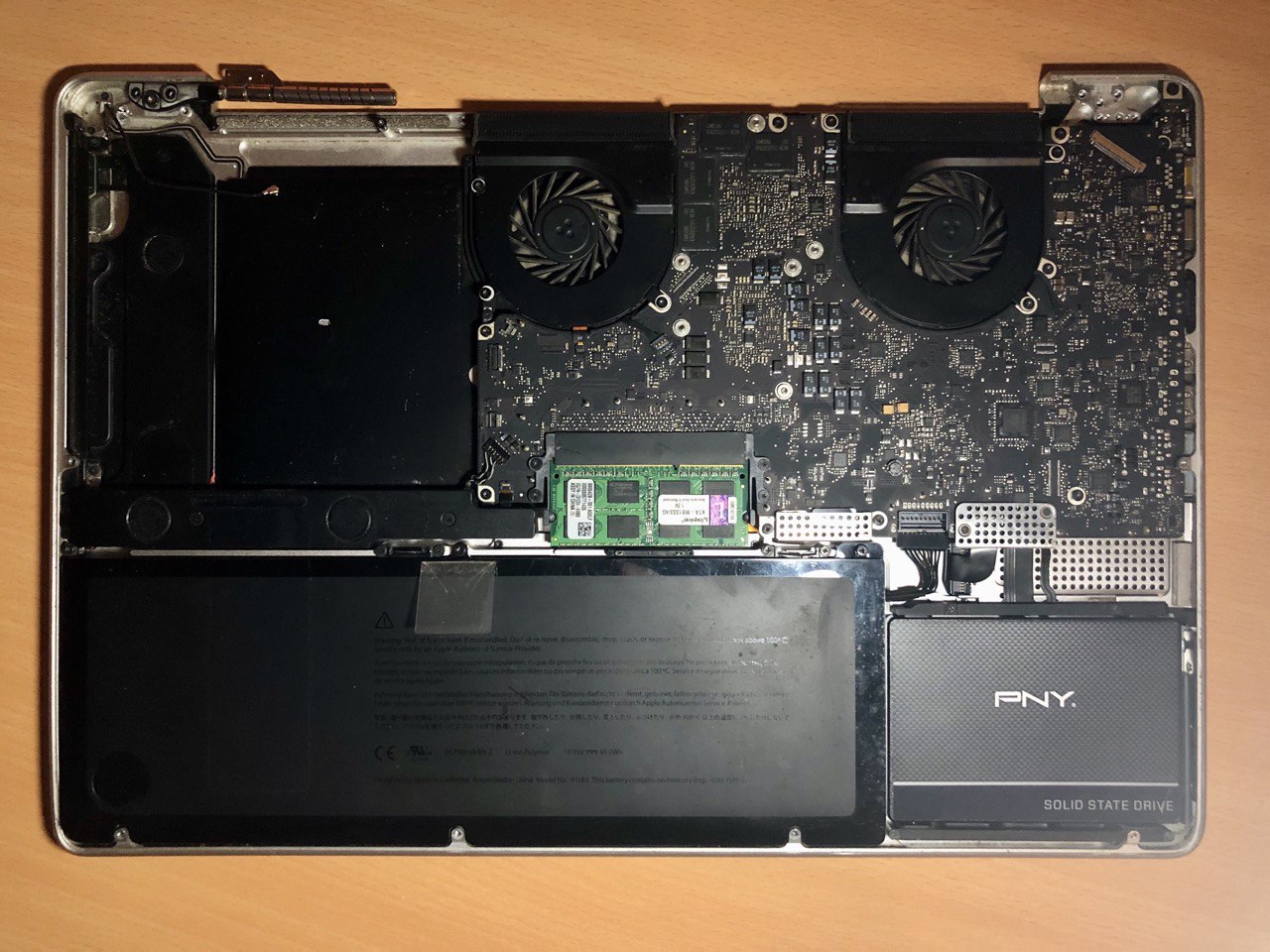

I could try get the hinge fixed, fit the display back on, re-install the optical drive and find some Toshiba 750GB HDD (because I threw out the original when it failed), and then put it back to 10.13 (High Sierra). I had the display connected before and could see the desktop if I shone a light on the screen.
The shell is also scratched so much – it's not my Notebook, it's my brothers. I said "I'll fix it for you!"…then I didn't know where to start.
I was going to try open a hidden defect case, if I made it look "presentable". I had a lot of luck with my butterfly keyboard case from last year.
Edit: found the original HDD & fitted the optical drive back in…still won't boot however. If I get the display back working, I would look into writing a letter to Apple (the hinge is broken & backlight has problems – that's why I can still see the screen with a bright light on it)

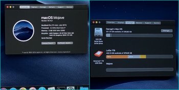

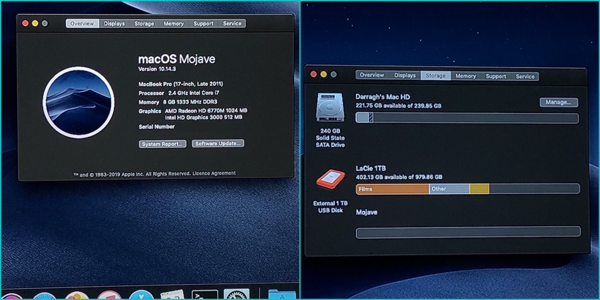

EDIT:
I got it started with a sh*tton of heat and dragged gfxCardStatus on there to disable the dGPU…it legit started like a terrible car. It revved. And revved. And with more & more heat, it started in Safe Mode…with the display lying flat with no backlight (I used my iPhone light to see the screen).
Apple I'm coming for you haha…once I get the hinges on eBay and fix the backlight.
THEN…then we'll talk. Maybe. Apple might laugh, I'm not sure
