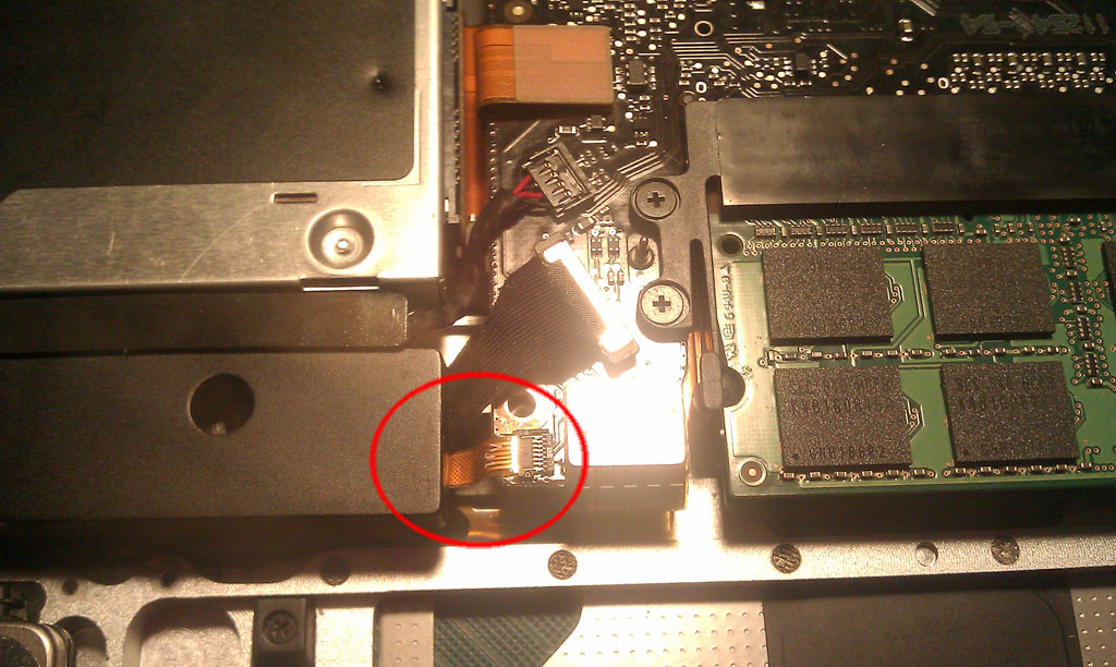

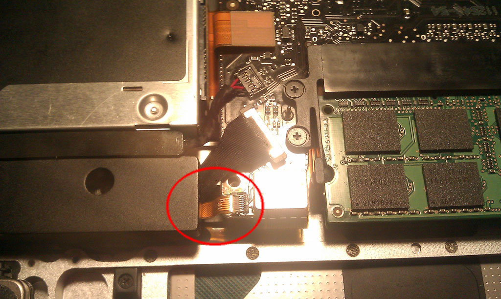

Take a metal object and run around the black border of the glass display. Where it "sticks" is where the sleep magnet is. Then figure out where that lands on the top case and that is where the sensor will be.
Fixed!!!!
No other fuse so it will likely be an issue with the WLED driver orthe circuitry around it. Or possibly the lvds connector/cable. To troubleshoot that you will need some electronics experience and a schematic. A microscope and fine leads for your multimeter are helpful too.
Sounds like a possibility. I have that same machine but it is my wife's so tearing it apart is an unpopular option 🙂
I found where the magnet is on the right bottom of the frame of the screen. opened up the case and followed where that connects. I unscrewed where the bottom covers mount to that spine in the case. there is black small piece that connects to the whole next to the drive with two screws there. underneath that there is a orange small cable that leads from the sensor sleep sensor to the motherboard. Here comes the stupid move on my part. The cable was twisted so I was putting the gold leads down. GOLD LEADS TO THAT CABLE MUST BE FACING UP This whole time!!! If I hadn't taken that deal off I would have never found out that it was twisted underneath. Thanks guys and I will continue to surf on this thread to help others with problems

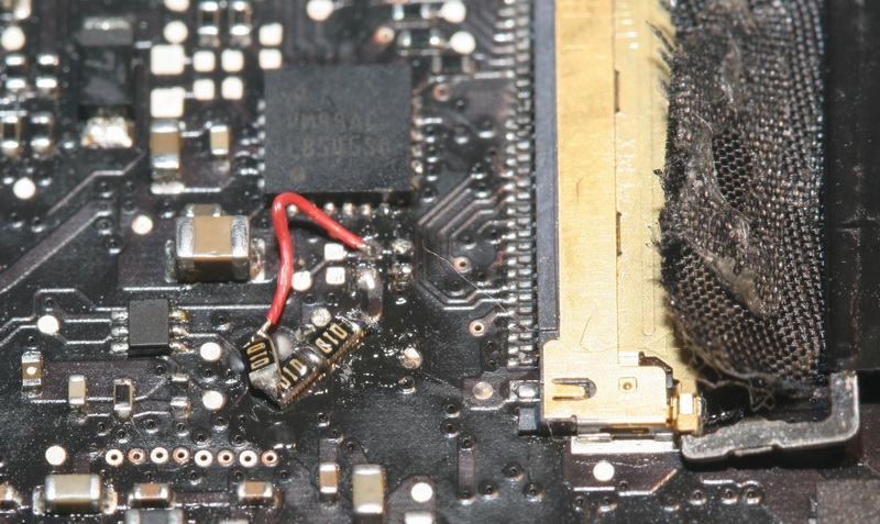

I actually did have one I fixed that had a bad resistor on the enable pin. Going from memory it was something like a 300K 100K voltage divider off the 12V rail giving a 3V signal on the enable pin. It caught me by surprise because resistors rarely fail in my experience. Still not sure what caused that one to blow. But good work diagnosing vyrcoop 😀

And the enable resistor was bad. In my case, the 300K resistor leg was eaten by corrosive liquid (coke from what I was told - it works for several months before dying completely). I don't have any 0402 300K resistor available so I use 3 0603 100K resistors in series, and it fixes the problem.

That is great 🙂 You may want to put a little kapton tape under the resistors and then maybe some over top to secure it from vibration. But good ingenuity in solving the issue.
Thanks for the advice Dadioh! Yeah I was afraid of those loosing after a while.
I found 2 0402 620K resistors and put them on top of each other making a 310K resistor and I think I will keep it this way.

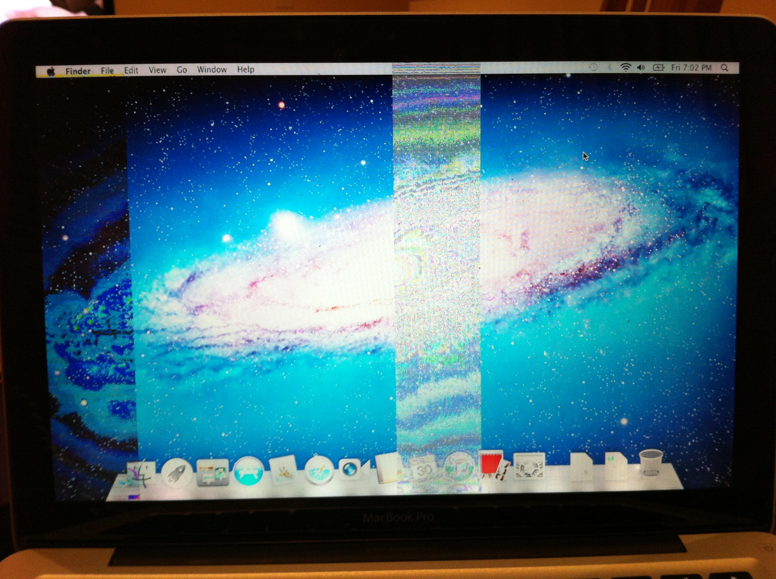

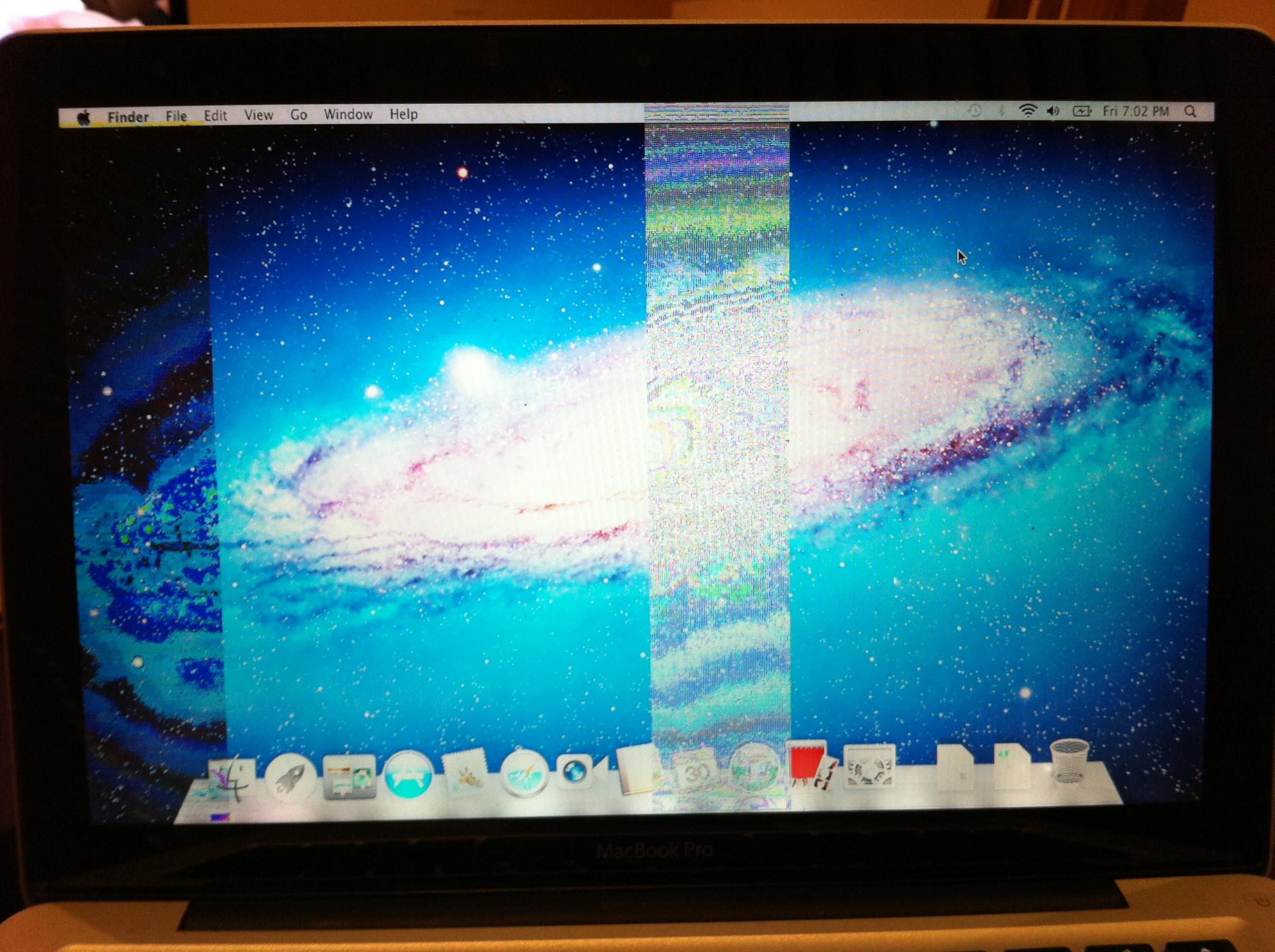

Hi can someone shed some light on my MBP 2011 it has had liquid damage and this is the only issue I have see photo
