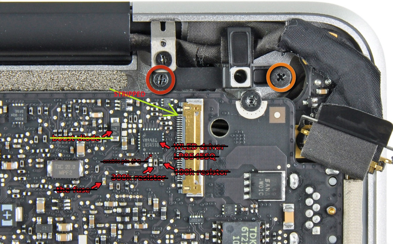

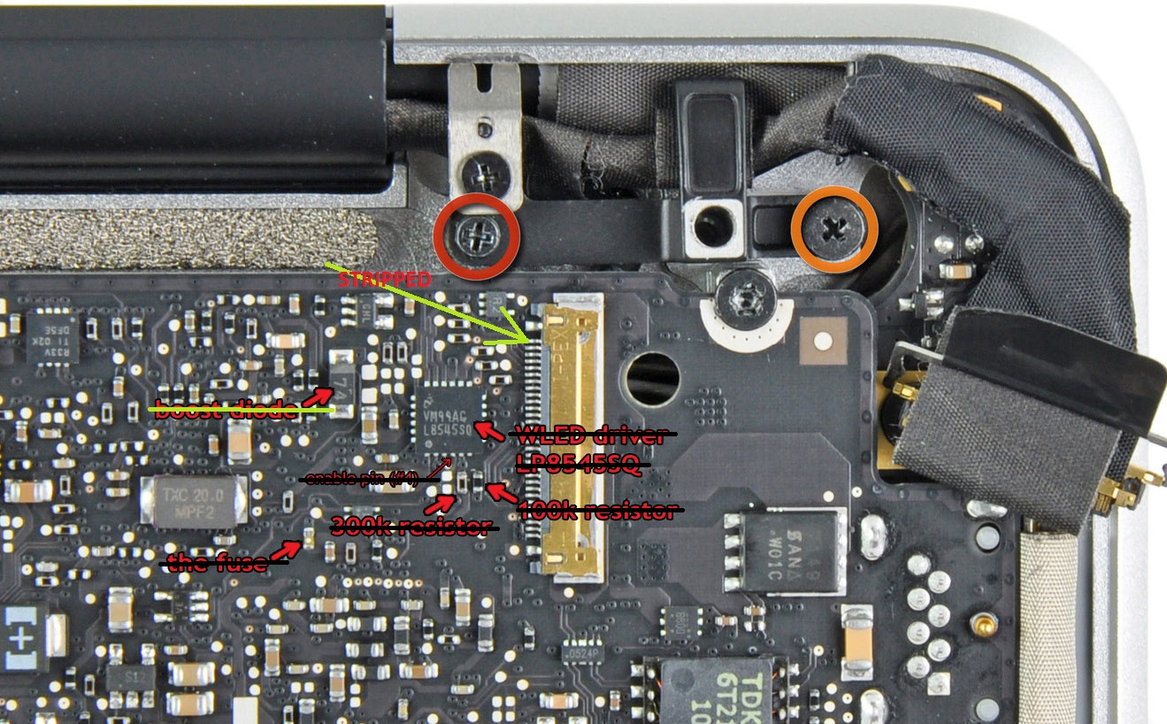

See attachments for a mapping of the backlight circuit to the circuit board.
Thanks for the schematics Dadioh, I replaced the fuse and it fixed my backlight. haha it's funny cause now I have another problem, when I turn it on it shows the gray screen and the apple screen shows up and everything is lit up but after the gray screen it turns blank. I plugged it in to an external display and everything shows up fine. I have got a 15.4 2.53ghz with a Nvidia 9400. What else could I check?

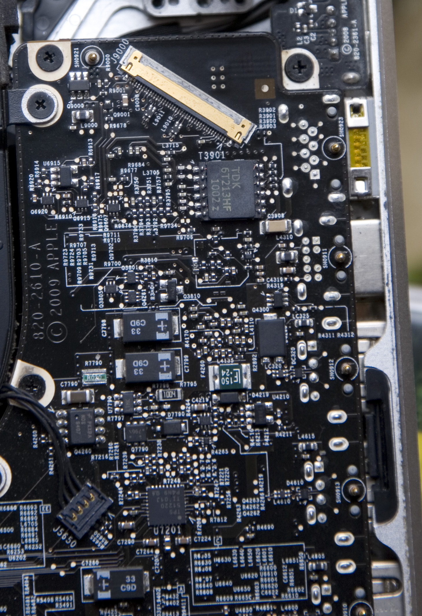

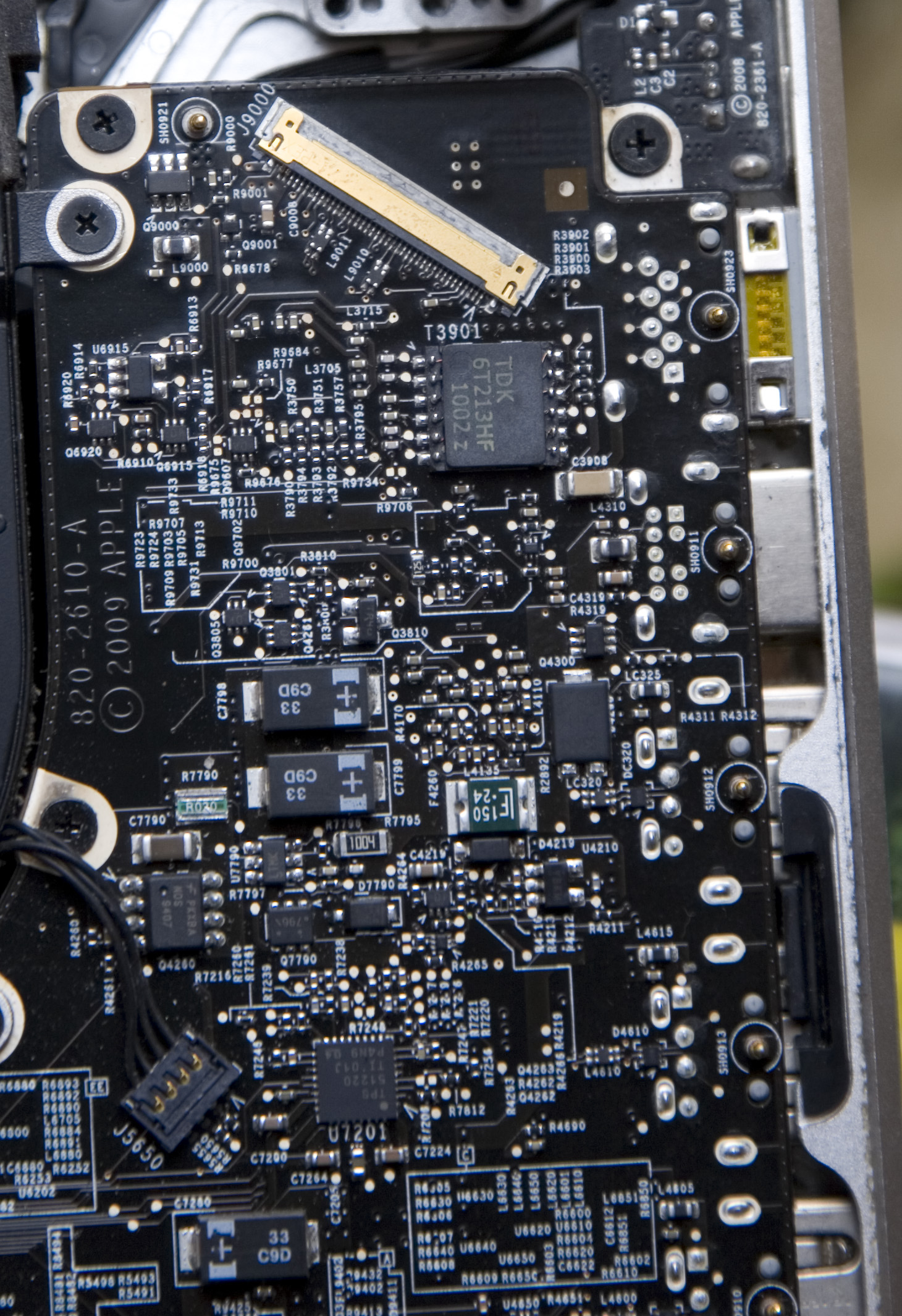

Hi Liam. Welcome to the discussion. I tried zooming on the area near the display connector P100973.jpg since this is the most likely area for the fuse to reside. However, the resolution isn't high enough to get a good look at the smallest 0402 sized components. There is a good chance that the fuse is on the back of the logic board. All of the models I have seen the fuse is within a couple of inches of the LVDS connector either front or back so I wouldn't bother looking in the other areas of the board.
Can you try for higher res picture of the area both front and back near the display (LVDS) connector? Or, if you have a magnifying glass have a close look for yourself. The fuse on all the models I have seen is a beige colour 0402 size component with either a white dot or the letter "F" on the top.
Good luck.
@Dadioh,
Right I managed to get another pic of the front of the motherboard couldn't take one of the back as when I was taking the board out I had a problem with one of the screws, all the others came out except for one which wanted to play silly buggers, so now I have one screw that is threaded, any ideas of the best way of getting this one out ? 🙁

@Dadioh,
Cheers
Liam.

This feedback mechanism, is it the number 7 on the schematic you sent me?
What is the voltage supposed to be? I am curious if I can bypass it to see if it triggers anything

Just had a thought... If the keyboard button for dimming the display is stuck on then it would behave this way. The backlight would be on until the OS booted to the point of listening to the keyboard brightness request. It would then rapidly dim to zero. Only way I can think of to test this would be to disconnect the keyboard flex cable and then boot up with external keyboard. The trick is getting the Macbook to start up since the "on" button goes through that same flex cable. You would need to identify the 2 points on the board to short to turn the Macbook on. They do exist on the 13" so I assume they are also there on the 15".
As far as the voltage output on point 7 goes that should be around 12V. Probably 12.5V going from memory. That would stay at 12V even if the backlight dims however. The WLED driver chip would turn off the brightness through it's drive of the output FET/Caps/Diode.

Water damage and no back light. Everything else is OK. I've tested the fuse impedance, and it seems like the fuse is OK (very low impedance). I've read in this thread (see here) that the WLED driver had 6 pins connected to the ground and that a continuity test between ground and on all the pins should give 6x beep. If more, then the WLED driver is dead.
Can someone confirm that? My tests beep on all the pins of the WLED driver. 🙁
Are they some more tests i can run to test the driver's integrity ?

Hi Dadioh. I was wondering if you could help me out. I have a macbook pro 13 mid 2010. In the process of fixing my Lion wifi issue, I accidentally broke the lvds connector on the logic board. I attempted to remove the connector but managed to strip the pads off pin one.... I was wondering if you can help me out by looking at the schematic and letting me know what pin does and where I can reroute the connection. Thanks.
I took someone else's pic and marked pin 1. please help.
The top of the connector is pin 30. The bottom is pin 1.
Pin 1 is ground. Pin 30 is not connected.
just as I thought. I tried to trace it but it lead nowhere. I guess I am in luck. Thank you.
That is probably why it came off in the first place. Solder pads that are unconnected have no tracks to dissipate the heat from soldering. So they heat up fast and can detach from the pcb.
