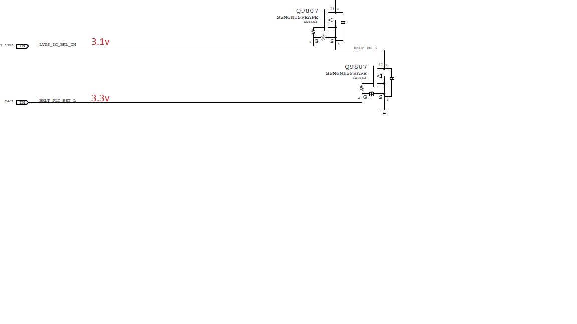

I have a question about this same board from a late 2008 MBP 15" Board number is 820-2532-A
THIS I DON'T THINK IS PART OF THE DISPLAY BUT I COULD BE WRONG, , BUT ITS OBVY DAMAGED FROM LIQUID AND OTHER PARTS AROUND IT.. CAN ANYBODY HELP ME DETERMINE WHAT THIS IS AND WHAT IT CONTROLS??? I'LL MAKE A NEW THREAD TO NOT INTERRUPT THIS ONE AFTER I GET AN ANSWER TO SEE WHAT IT CONTROLS

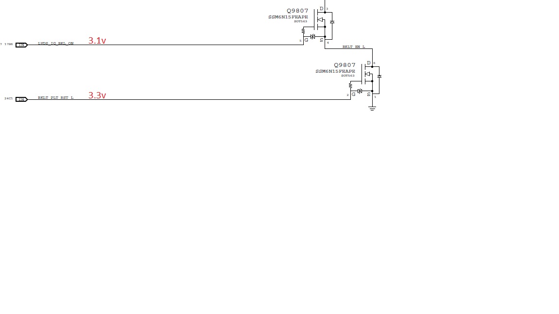

The way I read the schematic it seems that pin 4 of APP001 must be sourcing this 4.9V. I don't see any other potential source. So my guess would be that if you do not have 4.9V then you need to replace the APP001 device. This would require scavenging one from a spare parts board.
Thankyou for your reply, i had a suspicion it might have been the source. Will have to wait till i get some scrap boards because as i am aware, this is the only board with the APP001 WLED chip on it and i dont have any scrap of them. Oh well.

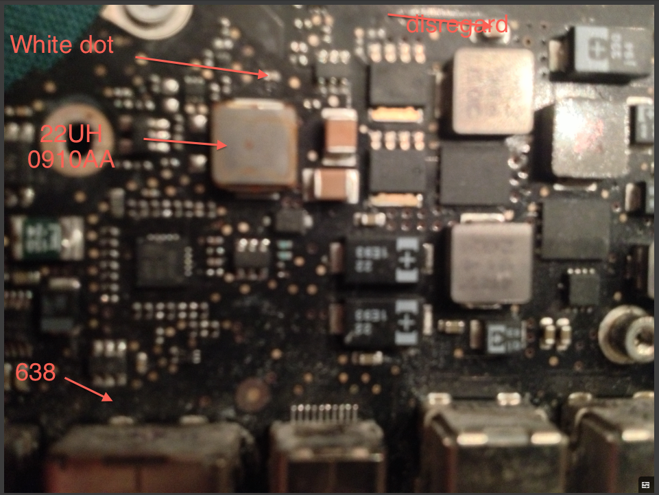

Please help!
I have gotten myself up the creek with my friends computer.
Can anyone tell me if the fuse indicated in the post a few above this one is the backlight fuse.
I know the resolution is terrible. all I have is an iPhone for a camera but the location is decernable.
It is not very close to the display connector but is the only one I can find with a white dot!
Does a white dot always mean it's a fuse?
Sorry to keep asking but I am drifting here without a paddle!

That looks like I is probably the right component. I don't have a 2008 15" unibody board to check. A white dot or "F" or "P" on the top as far as I know is always a fuse. Do you have a multimeter to measure this? If it is blown then it will measure mega ohms but I it is good it is 0 or a couple of ohms.

That would be the fuse. The fuse blows when too much current flows due to a fault. If the fault was due to a liquid spill and cleaning the board removed the fault then you should be good. After removing the old fuse take a second to check the resistance measurement from the fuse output to a ground point. If it is a low number, say less than 100ohms, then you still have the problem and a new fuse would just blow again. In that case you would have some detective work to find the fault. But most of the time, if the spill is cleaned and if the lvds connector is not damaged, then replacing the fuse is all that is required.

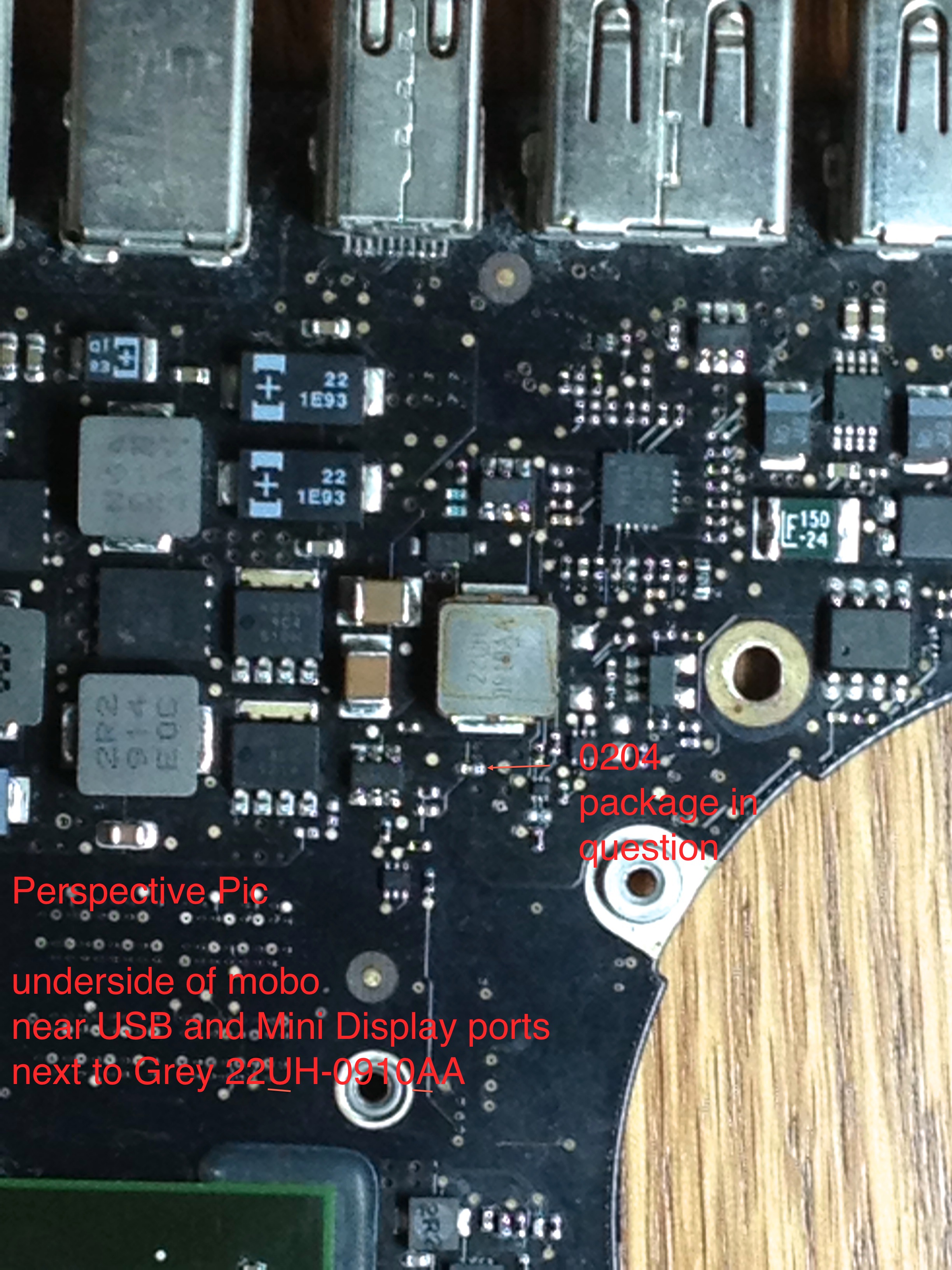

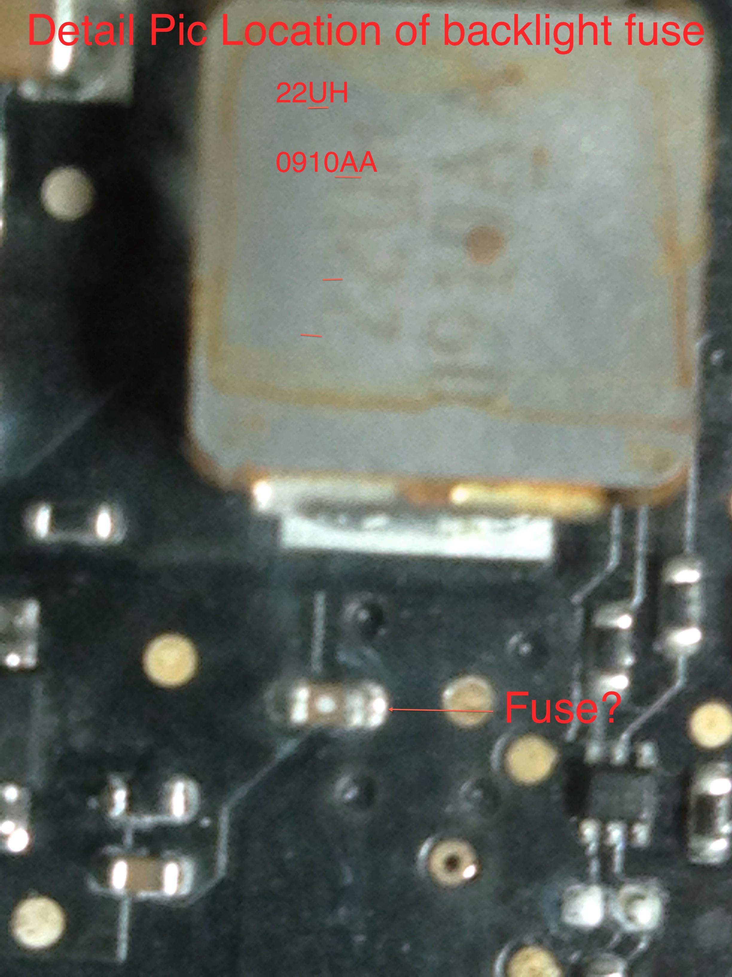

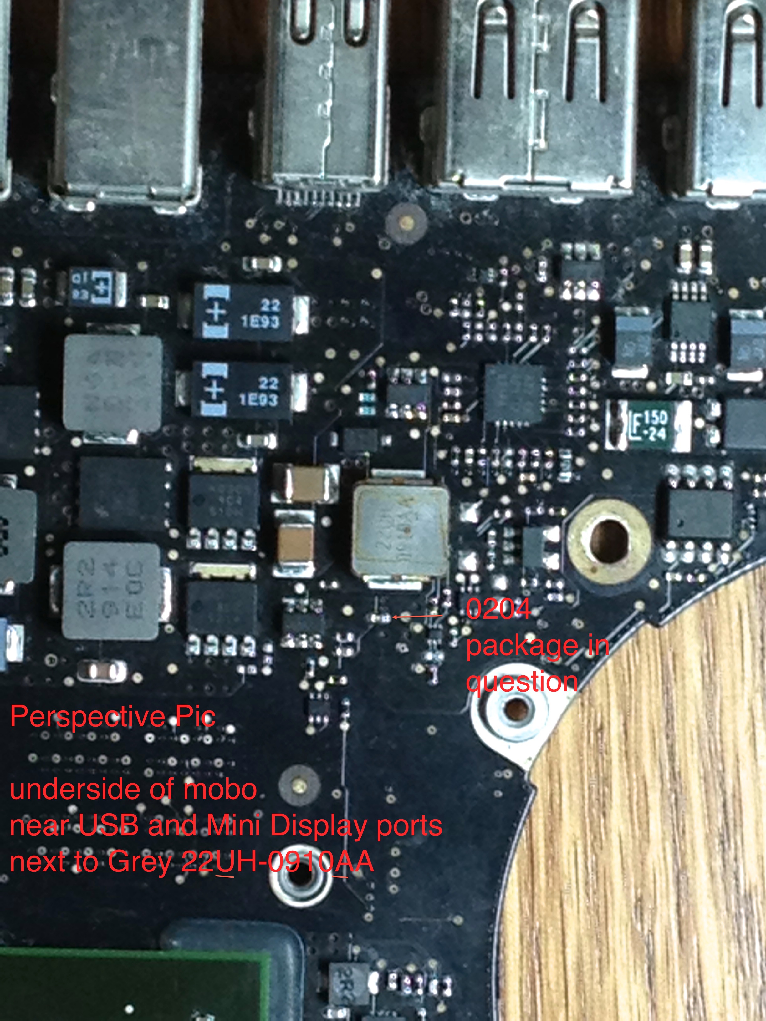

Backlight fuse for 2009 MBP
I ordered some 0204 2a fuses and hope to be able to replace my fuse.

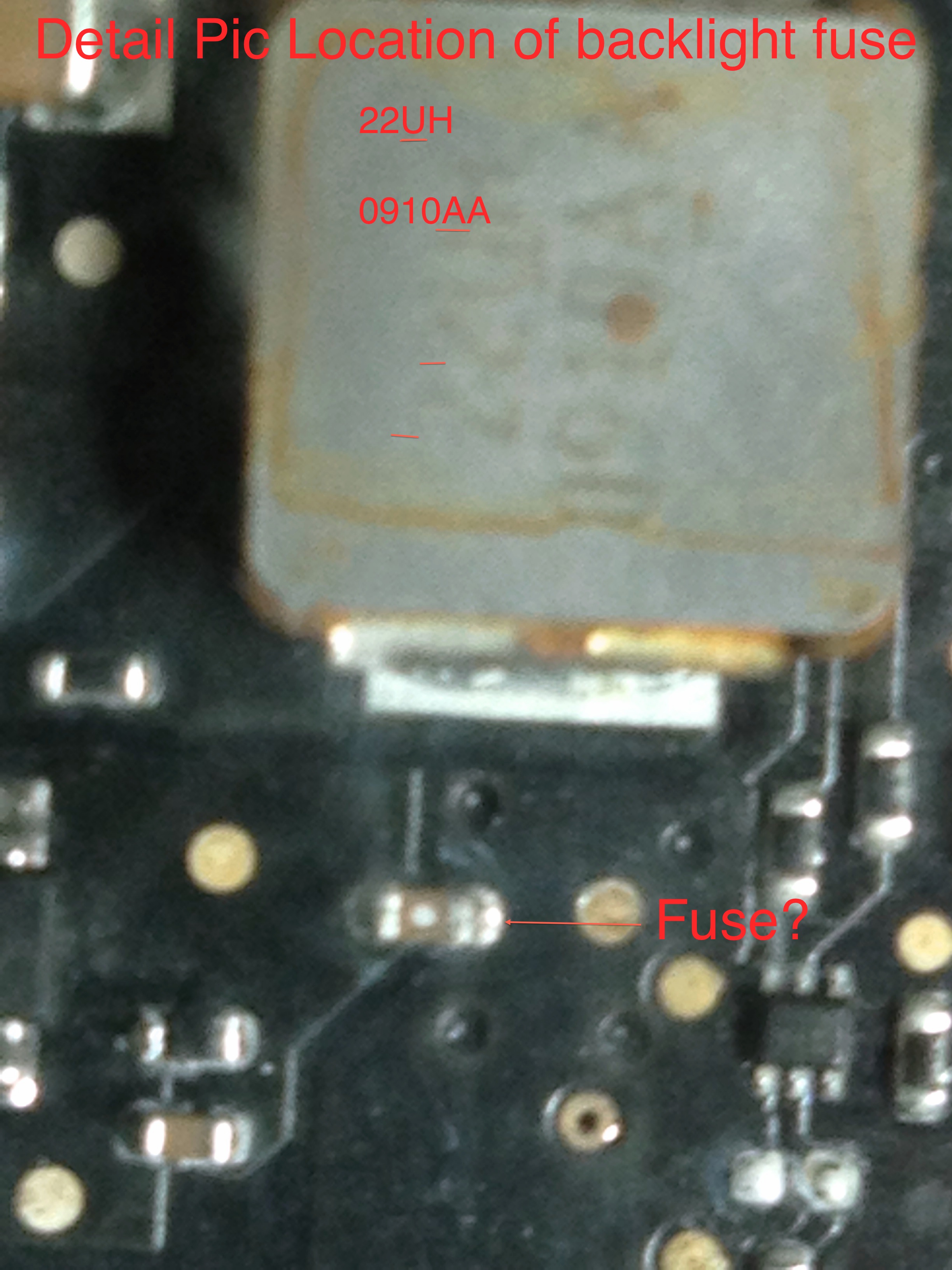

I am posting some better pics in the hope that someone can verify that this is the fuse. Dadioh signified that it looked like it so I am almost sure.
Hope to see the repair forum open soon and will work on my photo taking as I will have some boards to post an would love to help as I have and am being helped.

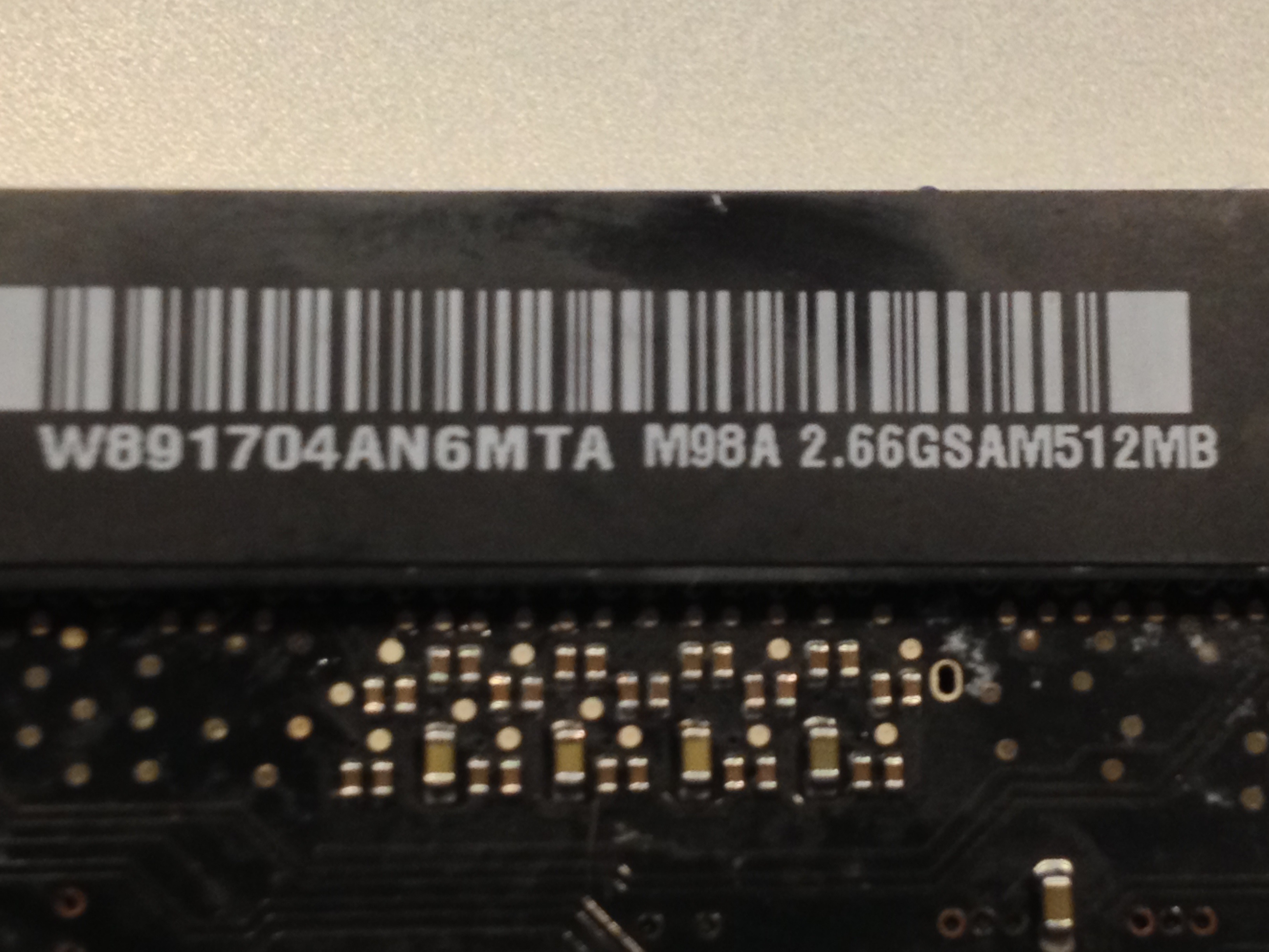

The first pic is a number by the memory slot that appears to be a serial and ghz designation...??
Second pic is a perspective pic so you can see where it is and
Third is a close up of the OPEN 0204 package w/white dot on it
Anyone know this board and that it is the backlight fuse??
Thanks

Early 2009 MBP 15" backlight fuse location
Problem resolved.
Anyone interested in this location it is confirmed.
Early 2009 MC026LL/A
Model with removable battery 2.66 ghz
Backlight restored by replacing this fuse.

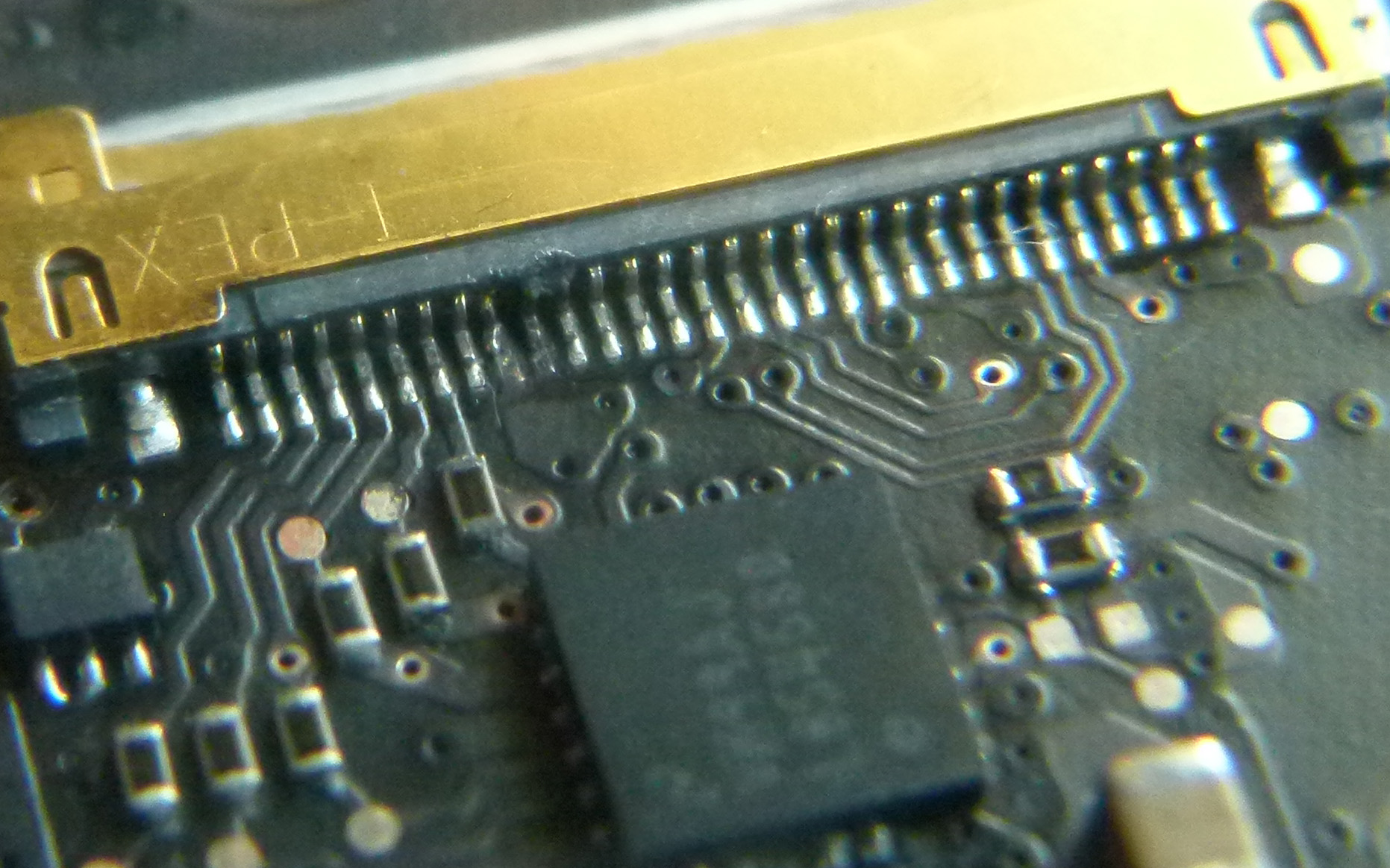

To give at least a little something back to the community, I compiled some information for the Macbook Pro 13" early (and late) 2011.
First things first. ID your board.
Look on your board for the serial number. It should read 820-2936-B (or something very close to this).
Look here:
[url=http://s22.postimg.org/7bsb66wel/board_big.jpg]Image[/url]
[url=http://s12.postimg.org/u1psllubt/bagrat_boardserial.jpg]Image[/url]
Frequently asked questions:
Where is the fuse?
Near the LVDS connector. A bit to the left, it should have a P on it.
[url=http://s7.postimg.org/shhma3n47/connector.jpg]Image[/url]
What kind of fuse is it?
3A, 32V, fast acting, 0603 package.
This is actually what the "P" tells you. See here: http://www.matronic.com/pdf/herstellerkataloge/littelfuse_katalog/Chapter10SurfaceMountFuses.pdf
Any fuse with this specs will work. If you want the fancy "P" on it, get one from "littlefuse".

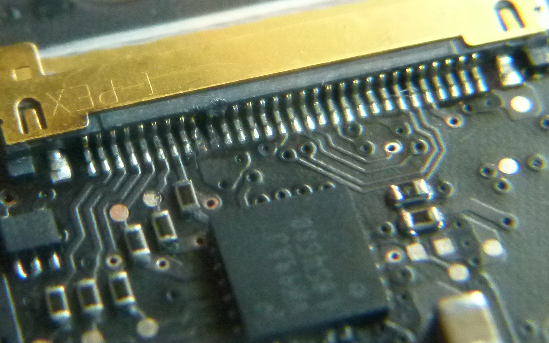

There is something wrong with my LVDS connector (burned down pins, etc.), what kind of connector is it?
It's an I-PEX 20474-030e-11 (30 pins. Note the "030e"). Either search for this and get them cheap from asia, or search on ebay for "Macbook 2011 lvds connector" and pay more.

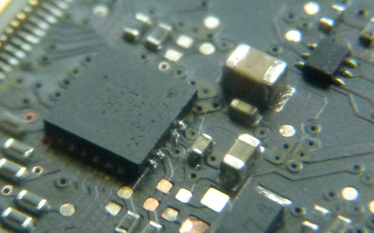

Where is the WED driver?
Look left from the Fuse. A tiny BGA package surrounded by resistors. See picture.
[url=http://s7.postimg.org/793xso8nb/wed_bga.jpg]Image[/url]
Where can I get one of these?
It's a relabeled Texas Instruments LP8550. Either order at least 500 of them from TI or, register as a company on their site and order some free samples. A third option would be ebay again. There are some sellers who offer them.

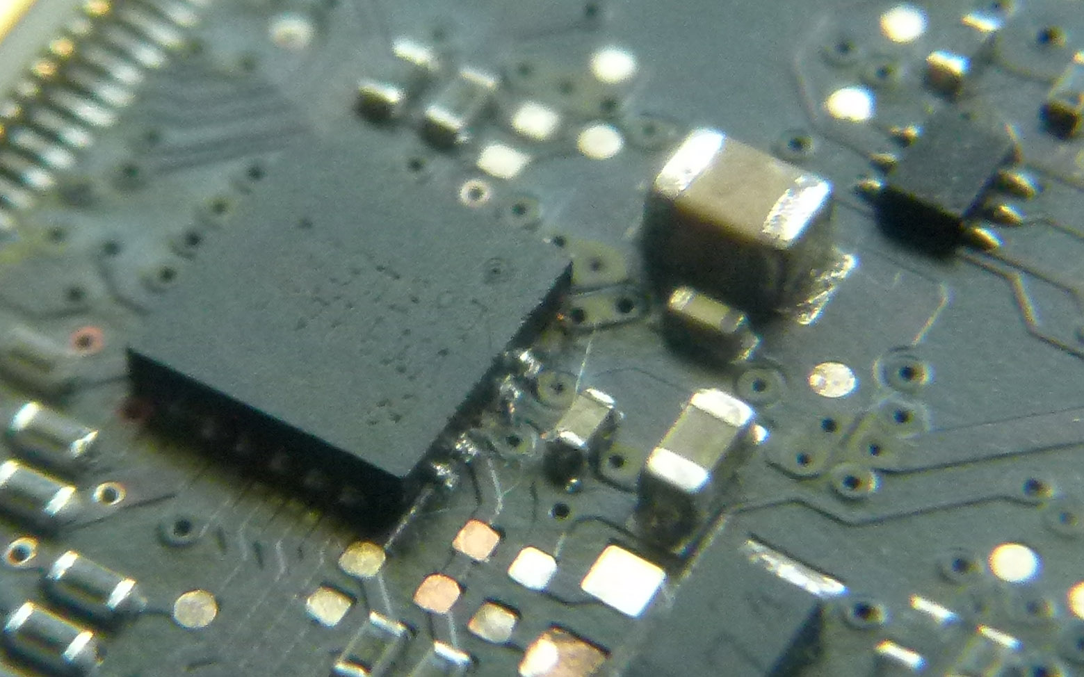

Has anyone here used the solder rework station T862 for replacing BGA packages? I have quite a few boards that I believe the SMC is bad and wanted to be able to replace BGA packages. Sample listing below... there are lot's of them for sale on eBay from various sources for a little over $200.
