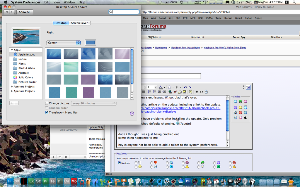

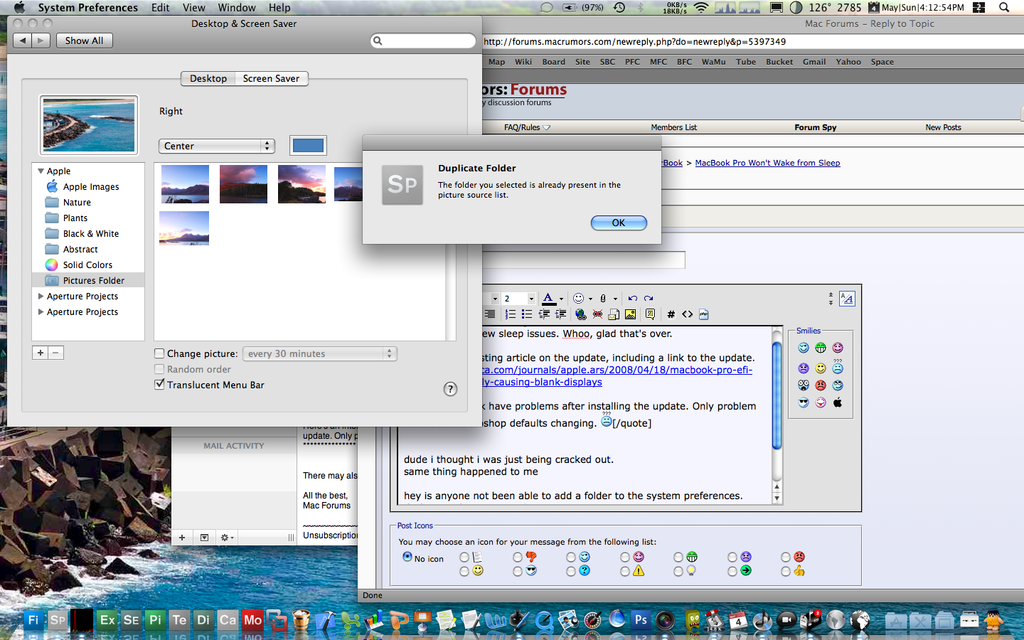

hey is anyone not been able to add a folder to the system preferences. desktop and screensaver?
like it shows the picture folder and if i add one it says its already there when it is clearly not.
i keep getting this when i try to see a folder
and when i add a new folder that i have not done before, it says it adds it but its not.
also it keeps showing two aperture library and they are the same libraries not different.
so frustrating.
