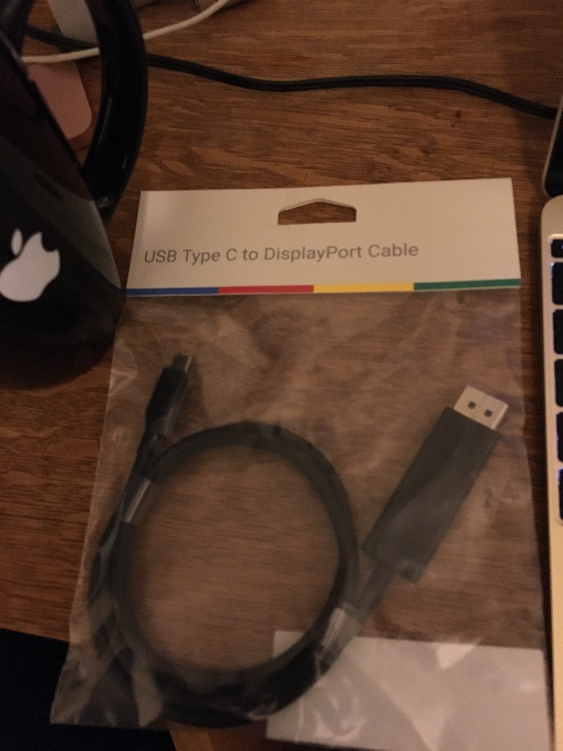

Yep its a ACD. At this point, I don't really care about charging....... ( I'm still holding out hope for the Hydradock to materialize)....I got my Google USB-C to Displayport Cable today. Quality is nice... I'll see how it performs tomorrow when everything else arrives from China. 🙂 So excited. I like projects like this
Haha. So all the cables I ordered on Amazon from China haven't shown up... It's been 15 days. Ugh. But I did get my Google cable in....

I just finished my second test.
Its working!!!! I'm excited. Just what I was looking for. I think if I get the other cable I can charge it too.
And a mono price mini display port female coupler.
I'm super happy.
I have the Google usb-c to Display port, hooked to a Mini display port to Displayport Female adapter, to a mono price female coupler.
