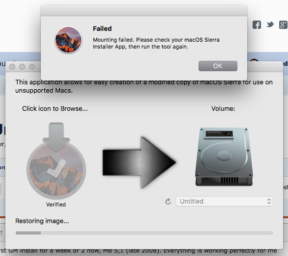

I am receiving this error using the macOS Sierra Patcher
I've tried a couple of USB sticks but both getting same error.
I had the same error, when i tried to use the second volume on my usb stick. It worked with a single volume stick.
