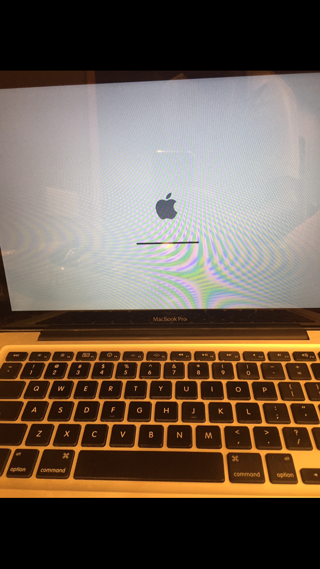

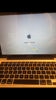

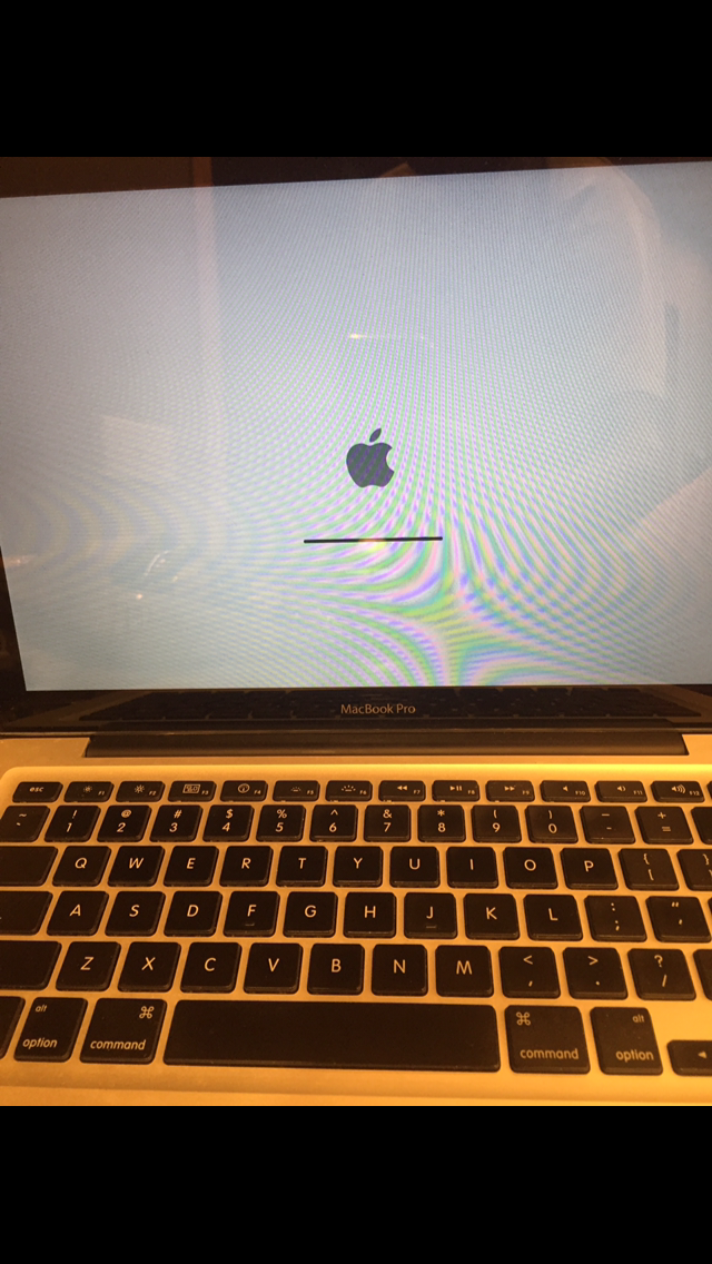

As I was trying to boot from the USB drive, it has been stuck on the boot screen for the past hour. The progress line is all the way to the end, but it isn't moving past the boot screen.

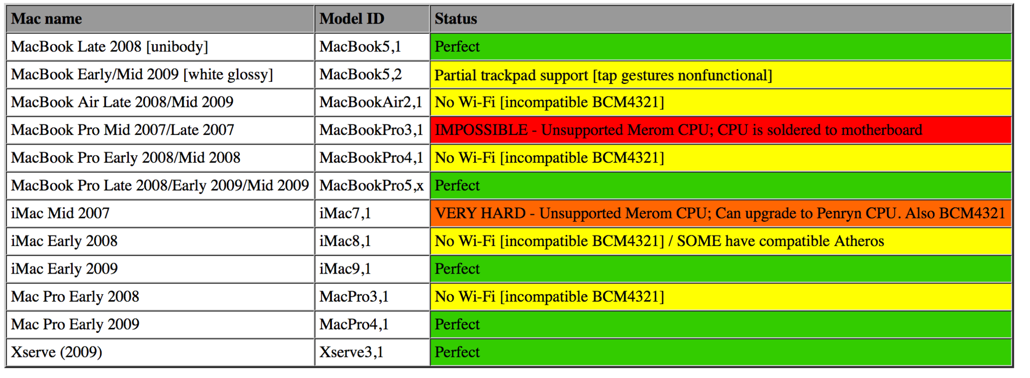

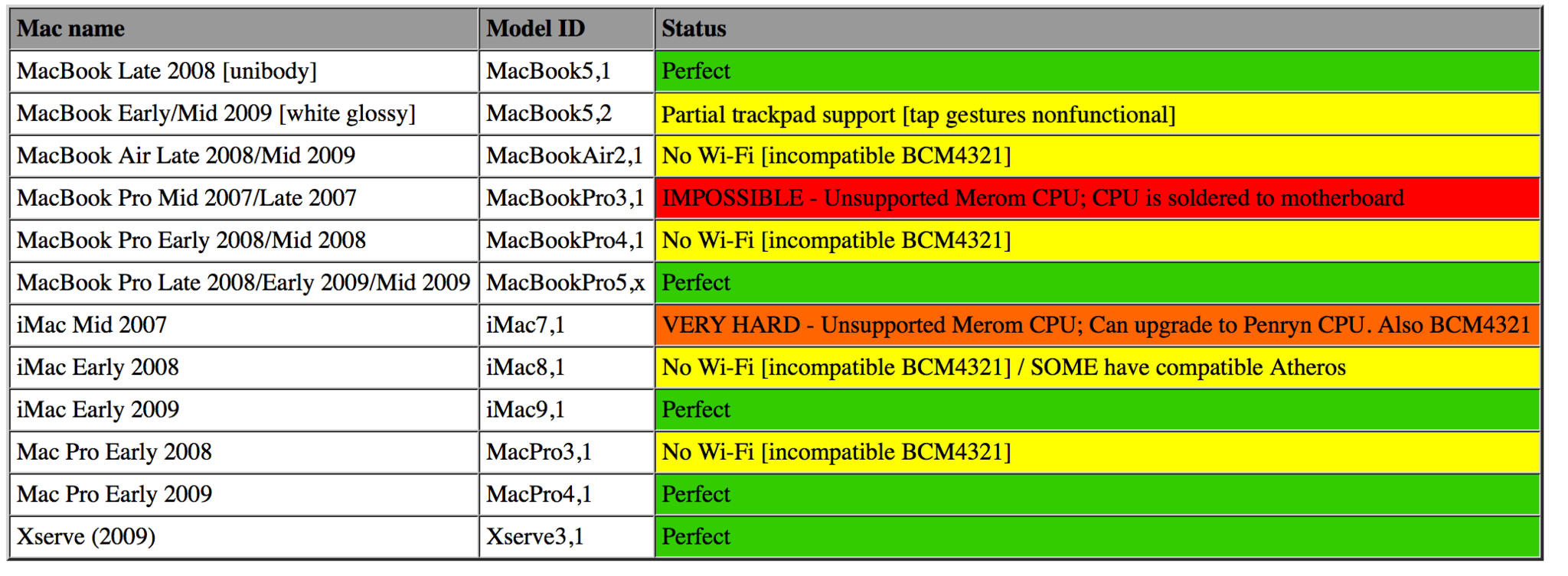

The MacBook5,2 trackpad issue is strange - double tapping seems to behave as a tap-and-hold, but a single tap has no effect and two-finger tap for right-click also fails as already noted. The Hackintosh forums had notes on deleting keys from the trackpad prefpane Info.plist but the same keys don't exist on Sierra.
Unfortunately this is a deal-breaker for me, I use tap-to-click and two-finger-tap-right-click constantly so looks like I'll be going back to El Capitan.
It'd be nice if the first post could be updated to advise users of the problems on the Macbook5,2:
Reactions: Istivi Jobis

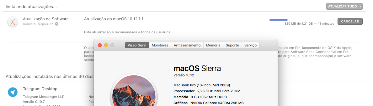

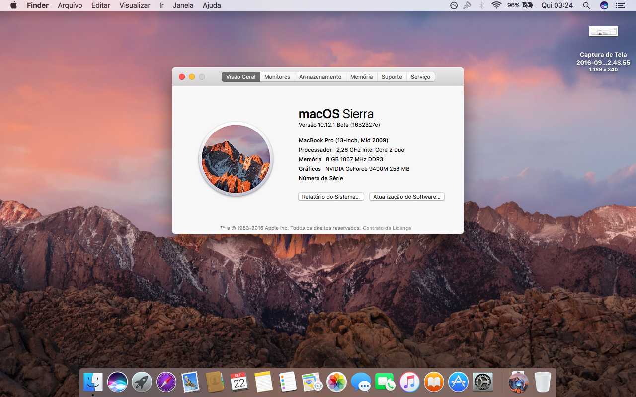

Hey guys, thanks for the awesome work. I run macOS Sierra on my macbook pro 4.1 and my wireless card doesn't work. Is there a workaround to make it work ?
If someone wants to, it's possible to upgrade to the 10.12.1 normally. Everything is working fine.
And add info that in Macbook pro 5,2 17" early 2009 everything works perfect
Thanks very much dosdude1 for hard work, my MacBook Pro 5.1 (late 2008) just work )
After install sierra, trackpad not working corectly (one finger taps, two finger taps-context menu), i connect my wired mouse and clicking some time with mouse some time with trackpad: left click, right click, check uncheck options on trackpad settings and... trackpad started working corectly
