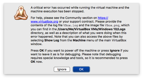

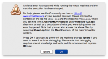

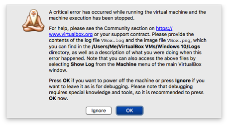

I think you guys have confirmed. Just trying to reproduce. To that end, just installed latest vbox 5.1.6 on mbp 5,3 Sierra and Windows 10 install borks with critical error.
A harbinger of good things to come I'm sure...😱
Let the "fun" begin. 😛

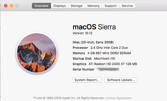

I got Sierra to run on my early 2008 iMac. I don't have the volume issue, but I swapped out my wi-fi card with the one from my early 2008 Macbook (which had a 0x88 identifier, also a Broadcom card), and it's apparently not supported in Sierra (worked fine in El Capitan). I tried resetting both the pram and smc, but to no avail. Ahh well... I've got a gaming adapter to ethernet unit I can use for now.

As an aside, it turns out that my iMac8,1 DOES have the audio volume issue, but it has been negated by the installation of my Line6 Toneport that I use for guitar input and recording. All of my input and output runs through this device, and the slider control does actually control the volume as long as the device is plugged in and selected for input/output. If I unplug it or select internal speakers, the volume is at full blast with the slider control doing nothing.
Yeah, that card likely also had the Broadcom 4321 chipset (supported under El Cap, but not Sierra).
