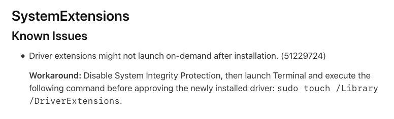

Touching SystemExtensitions

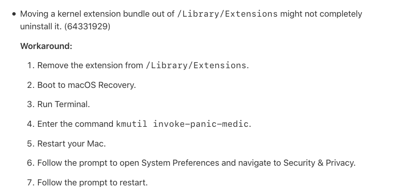

And Library extensions;

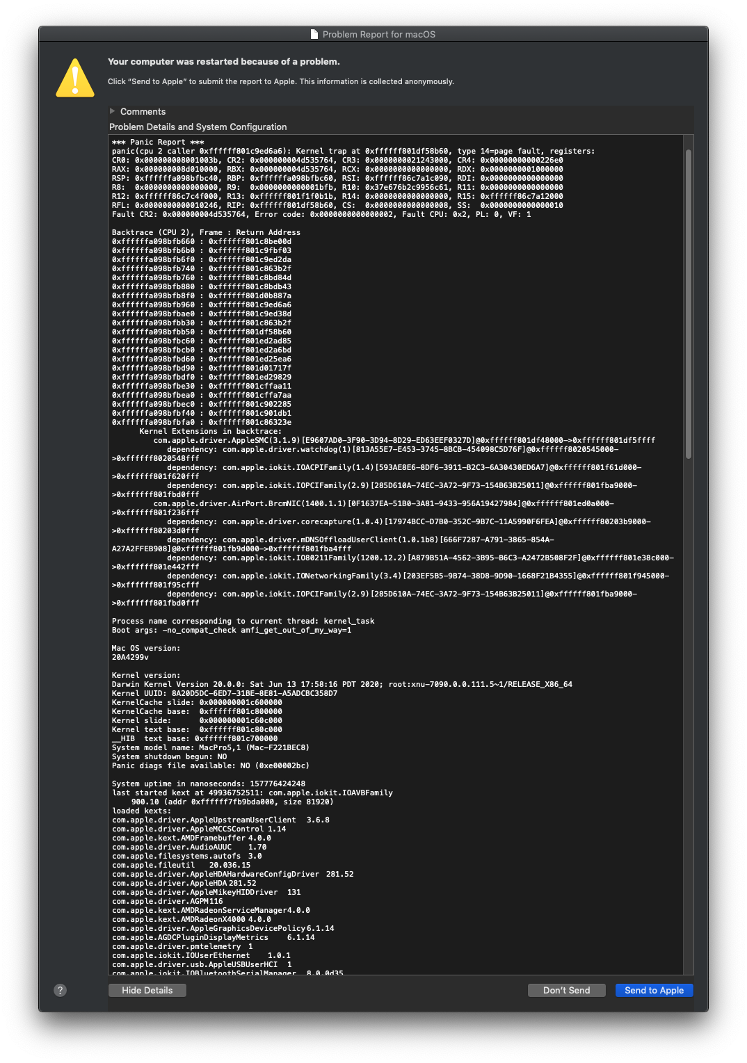

I'm having Sleep problems with the MacPro5,1, OS11, system wont enter an S3 state, LED pulses no devices spin down. Is there any known kexts from Catalina that would cause this?
Has anyone else tried OS11 sleep Natively booting on the 5,1?
