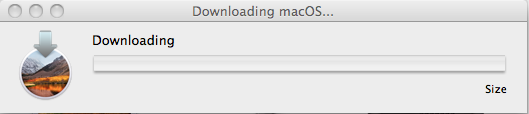

I've attempted to download high sierra through the patcher multiple times but it hasn't gotten past this stage. I have a Macbook Pro 2009 (5,5) with 10.6.6 on it. I've left it for hours multiple times without success.
The built-in downloader has issues on 10.6. Update to 10.7 or later, and it'll work.
