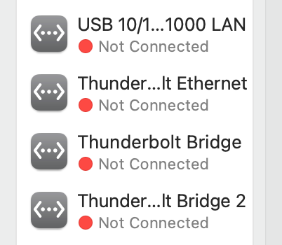

Having similar issue with Macbook Pro 13 2020. Installed a big update yesterday and now usb-c ethernet adapter stops working after 10-20 minutes. I have to restart OS to get it working again.
I noticed after update it created a bunch of new Thunerbolt Bridges:

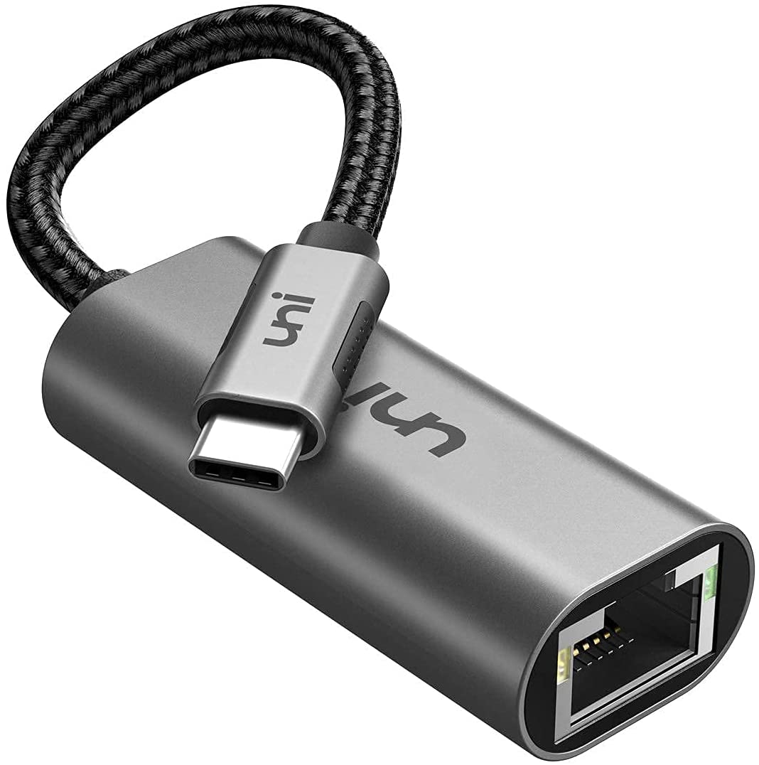

I have UNI USBC Ethernet Dongle. Showing up in USB with a Realtek driver. With 12.01 I got download rates in clamshell mode with max 940mbit down. now with 12.1 I only get 700mbit in open mode and clamshell max 200mbit. fun fact. if I restart the MacBook Pro m1max and do a Speedtest immediately when it is possible I get on the first test my 700mbit. second run is again 200mbit. I ordered a dongle with an AX driver and lets see how this works. Advertised I only see this drivers compatible with MacBook Pro m1 ones, Realtek just advertised till MacBook pro 2019. lets see how it works. I will let u know tomorrow. but its definitely Monterey problem 12.1.
I used the Uni usb-c to ethernet w/ 3 usb-A ports dongle (with a wired Logitech mouse) that worked fine before the update on a 16" AS mbp. After 12.1 it stoped working after putting the laptop to sleep. I had to unplug/re-plug it to work, I called Apple support and they were aware of the situation, engineering department said to try another dongle I tried my wife's 2 y/o simple Uni dongle and it works, Both used the 8153 chipset.
i have exactly the same dongle from uni which is not working fast anymore. today I got the Ugreen with ASIX Chipset AX88179a
works fine as the uni before. got download rates on Friday evening 7:30pm with 890mbit/s.
