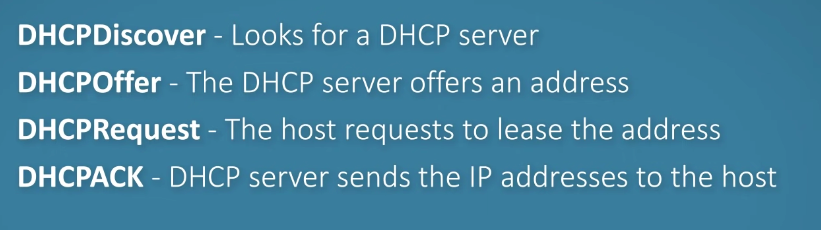

For folks less experienced or knowledgeable about how IP-based networking functions under the hood consider watching this video (or any of the many that exist) to educate yourself on exactly how DHCP functions:
The summary image in that video is good to insert here...I don't know where the Mac OS is breaking in this process, but it most definitely is somewhere...possibly at the discover, possibly at the ACK. I don't know and am not qualified to dig this level of detail out by packet analysis. At this point, I'm inclined to roll back to the version of Mac OS before Monterey if its a solution as the effort to do that is likely less than what would be in a packet analysis.

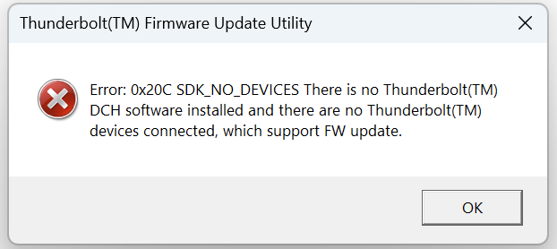

When attempting this, I get the above error. Any tips?
I've tried multiple variations on those steps and the firmware update popup just never appears. Also the instructions in the installer and the website differ. Installer says to completely disconnect the TS4 from the Mac before running the installer, the website says leave it plugged in.
Doesn’t matter. The Thunderbolt Update service starts when you plug in the dock. Search for this name in Activity monitor, and you’ll see it.
